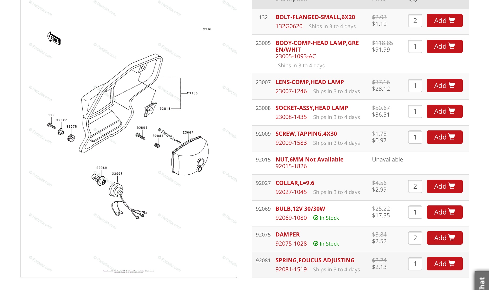

Scottkdx1980, if you decide to go the pricey but easy OEM replacement route, RevZilla has the housing cheaper and the bulb the same price as previously linked
housing - https://www.revzilla.com/oem/kawasaki/k ... -head-lamp
bulb - https://www.revzilla.com/oem/kawasaki/k ... -12v-3030w
Plus they are running a promo code BUYPARTS for 10% off your first order of OEM parts
