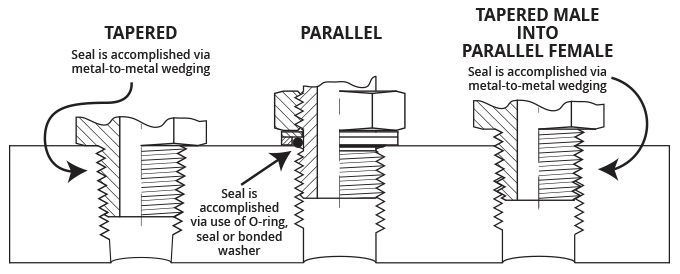

So are these tapered 3/8" BSPT?
Or are they straight thread 3/8" BSPP?
Both BSPP and BSPT are discussed here, and also referenced as just BSP.
Re: Coolant Plug in Underside of Cylinder?
Posted: 09:06 am Jan 02 2024
by Tyl3r
BSPT has a tapered thread and seals in the threads like an NPT. BSPP is parallel threads would require a shoulder with an O-ring to have a seal.
