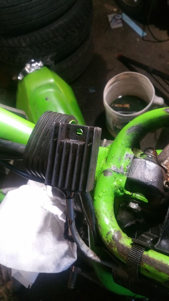

I feel like im asking alot of questions. But i have a few more. What is this thing? Is it supposed to be bolted to something. I found it just sitting there loose when i took off the seat.

A few questions about my 94 kdx200
That's the voltage regulator. It should be bolted to the top of the air box cover. Don't worry about all the questions, that's what this site is for. It definitely helped me with my build.

Re: A few questions about my 94 kdx200
So it doesnt have to be bolted to the frame to provide a ground?
