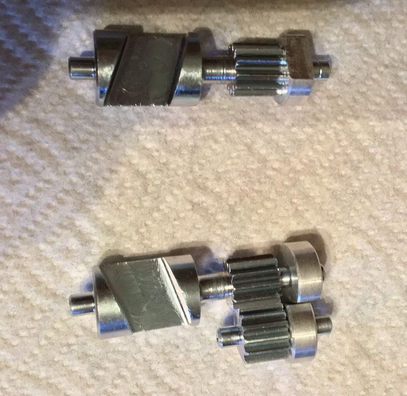

The long lost KIPS valves from BDK Racing has arrived... I must say that the quality of the valves was worth the wait and frustration.
Anyone thinking about getting a set... do it... it's well worth the time and money.

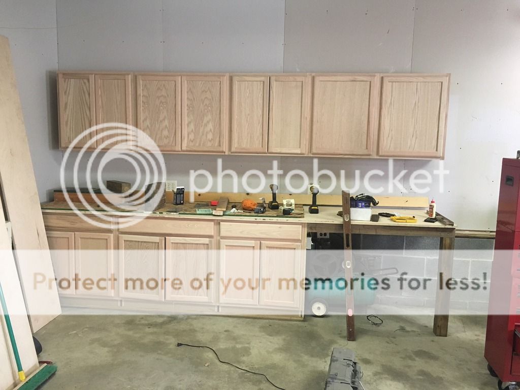

The remodel of the man cave / garage is almost complete. I removed the previous cabinetry and used inexpensive kitchen cabinets to build a 12ft work area, with room to keep the air compressor tucked out of the way. Next I need to get everything put away and get back to the rebirth of the KDX
Parts that I recently ordered, include a stock exhaust ( I didn't get one with the bike), new Weisco top end kit, and an air filter. The man cave / garage rehab will be finished soon just in time for the new parts to arrive and to get the KDX project back on track.

I have a little confession... When I 1st disassembled the KIPS I thought I carefully bagged and tagged everything. I was looking at the power valve (KIPS) parts last night. I was comparing BDK Racing's valves against the OEM (excellent quality BTW), when I noticed I was missing the little circlip spacer for the center valve... Now as you may know I've been remodeling the man cave / garage, so a lot of cleaning has been done, things moved, and some stuff just tossed... At 1st I thought it was no big deal, I'll just order a new one, what can it cost a few $$$... I jump on the internet, and see "Out of stock" hmmm, I don't believe it's being made anymore, so It may be difficult to impossible to find a replacement.
So my son and I go back to the garage, and meticulously go through everything... He was checking everything we've sweep up thinking it was lost in a cleanup, while I slowly remove everything from the workbench. When I was just about to give up I spy the little circlip spacer sitting under some misc stuff... It was close to where I disassembled the KIPS valves... OH HAPPY DAY!!!
I would have bet I sweep it up in one of the cleaning sessions... I was beginning to think I'd have to fabricate a replacement...
Next on the list is to install the new and improved BDK Racing KIPS valves... I'll be following the post by Freedom http://www.kdxrider.net/forums/viewtopi ... 15&t=15320... thanks for posting detailed pics. I understood the timing of the left and right valve, but was unsure of the center valve. Freedom's post helps to clear that up. My parts (exhaust, new Weisco top end kit, and an air filter) should begin arriving this weekend and / or early next week. Tonight I hope to put the rolling chasis and boxes of parts back into the workshop so the the reconstruction process can begin.

I began cleaning the cylinder for the installation of the KIPS valves. Per Brock's BDK Racing) instructions "make sure to clean the cylinder especially the bottom holes where the valves sit before reassembly". I used carb cleaner, there's still a little more to do but it's coming along. I also cleaned the carb.. It was clean, but it can never be too clean... One tip.. Please guys do not over tighten the pilot and main jets... They are brass and do not need torqued to 100 foot lbs. I really had to work to get mine out.
Parts are starting to arrive. The replacement exhaust is here. Just needs cleaned up and a coat of high temp paint.
One question... There's a spot for 0-rings on the exhaust. Anybody have a cheap alternative to the OEM O-rings?
