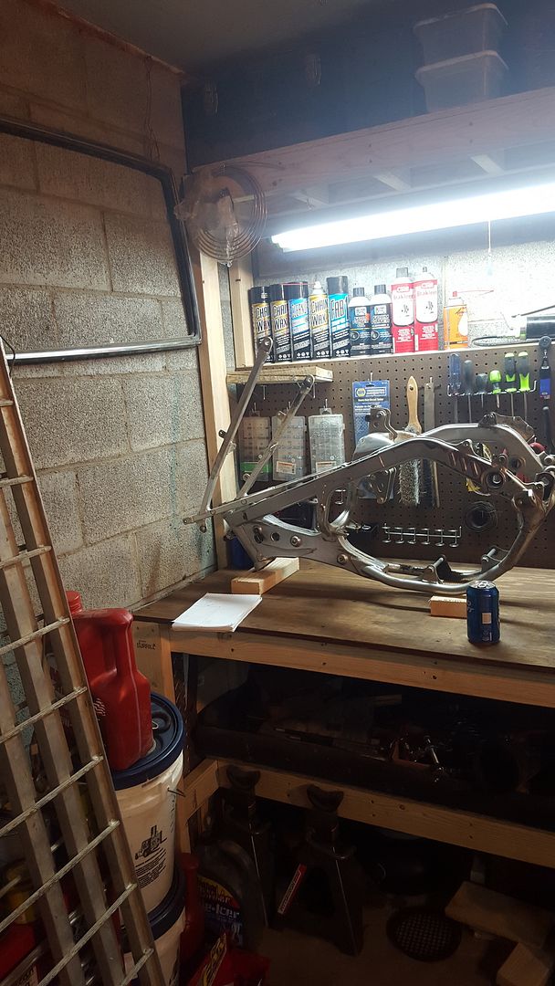

Well, I'm getting closer to starting my build. This weekend, I built a work bench in my garage that I feel should actually be suitable for building a bike on. 89 bucks at home depot and 4 hours later, wala:
Still want add a couple of things, but you get the idea. Now I just need to get my v-force 3 reed valve, and some drill bits and a reamer and I will have everything I need to start mocking up the motor and welding in new mounts. I plan to do all of the work myself in regards to drilling/reaming the motor and cutting the swing arm and sleeves. I figured that I could use the sleeves that are currently in the KX for mock up and cut them with an angle grinder. Then take a brand new set into work to have them turned down to the correct length on the lathe once I know the correct final lengths; that would be the only part I wouldn't do myself.
I've been slacking on getting this started because I have been having fun riding the kdx every weekend. As soon as the snow starts to fall here, I won't be able to resist working on this. Actual build updates should be coming soon, in the next couple of weeks, stay tuned!

Nice work bench! It just needs some peg board and hooks
newbbewb wrote:^what he said.

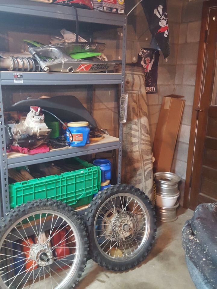

Got a pile of parts completely disassembled and ready to prep for gold powder coat. The only other gold-to-be parts that I need to take apart are the hubs. The rest of the parts will be powder coated some variation of gloss black (still deciding on glossiness)
progress..... slowly but surely!
