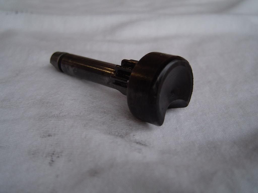

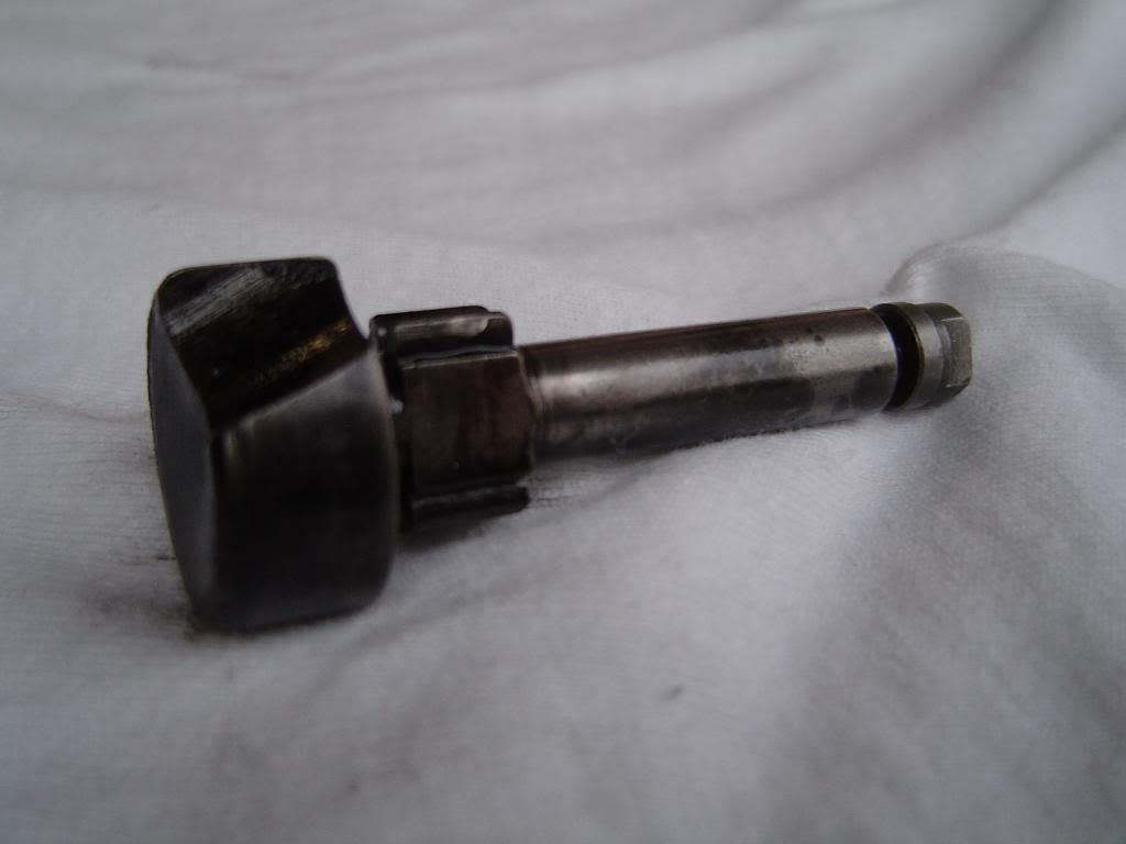

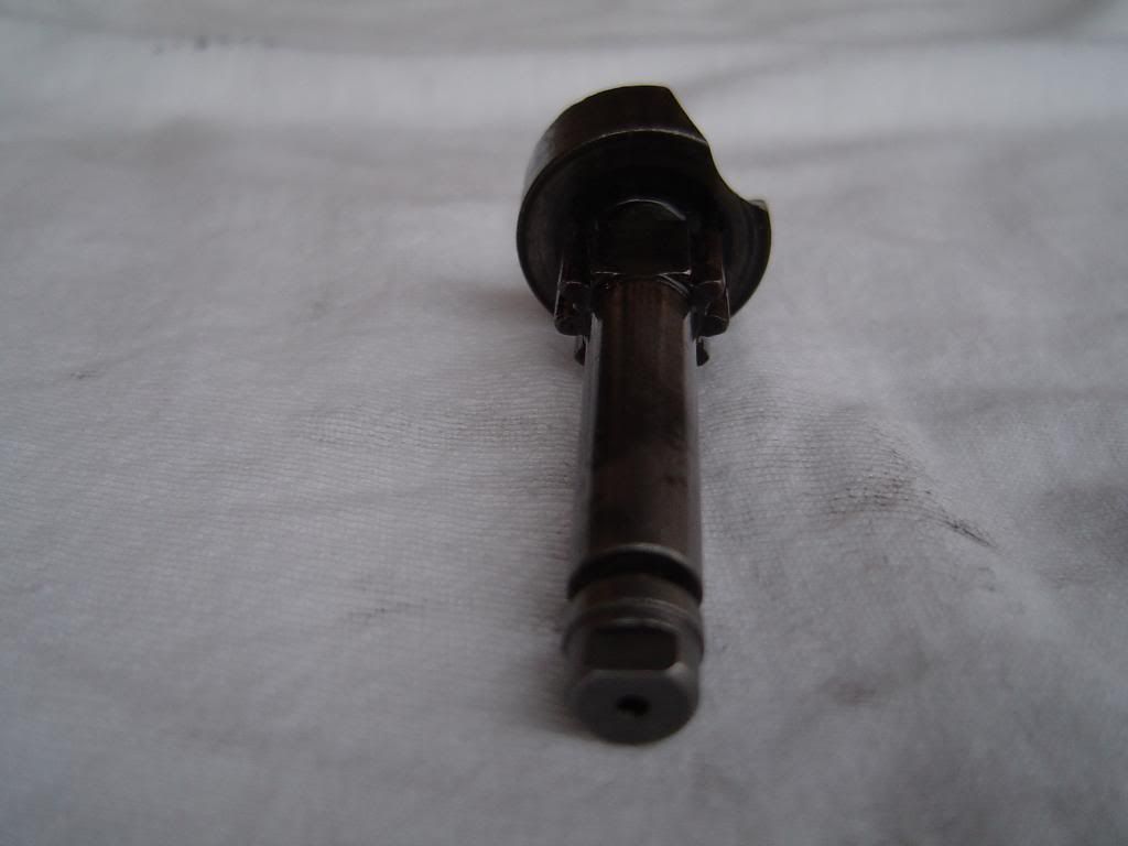

Thanks for the heads-up on that Gotanubike. I edited my post to explain to others what you brought up, good catch!
You can see from the photo why the manual tells you to pull out the main exhaust valve 1/2" and then remove/insert the operating rod (on the '89 -91') and why this procedure in the service manual will NOT work (on the '92-'94) - would have been nice if the '92-'94 suppliments mentioned that, or did they and I missed it?.
This is Gotanubikes main exhaust valve, they were installed in the 1989, 1990, 1991 E Series KDX200: - correct?
And this is my 1993 main exhaust valve, they were installed in the 1992, 1993 and 1994 E Series KDX200: - correct?
Now I know why my 1989 service manual does not explain how to properly install my 1993 main exhaust valve. Both the manual and cyclepedia do not explain that the main exhaust valve was changed in the E-series after 3 years, and neither give any explaination on how to install the updated valves in the following 3 years. I have the 1989 kawasaki service manual and also the 1993 suppliment and it does NOT explain the changes made to the main exhaust valve.
Now, I'd like to know why they were changed, there had to be a good reason and it surely wasnt for ease of installation!. Are there more KIPS failures in earlier models than later models? Could the earlier main exhaust valves have been causing stress and premature wear on the left powervalve? If so, the KIPS problem on the E-series might be solved by replacing the old original main exhaust valve with the new redesigned one.

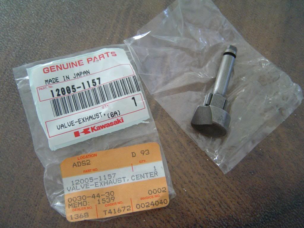

It seems like production of the revised main exhaust valve ('92-'94) has been discontinued and no longer available by kawasaki. In my opinion, if your running the old main exhaust valve ('89-'91) your going to have early subvalve shredding. I am now trying to locate revised main exhaust valves ('92-'94).
- Joshmcmillan
- Posts: 232
- Joined: 09:02 am Aug 23 2013
- Location: Australia
E series KIPS valve
I have one for sale in Australia with the notches in it. Postage would be $15 to United States. Let me know what you think it's worth, I'm not sure.Keystone wrote:It seems like production of the revised main exhaust valve ('92-'94) has been discontinued and no longer available by kawasaki. In my opinion, if your running the old main exhaust valve ('89-'91) your going to have early subvalve shredding. I am now trying to locate revised main exhaust valves ('92-'94).

E series KIPS valve

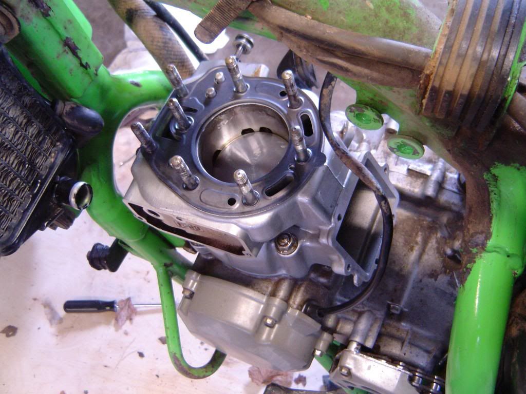

Got the KIPS valves all figured out and re assembled on the '93. I found A new version main exhaust valve on ebay for my 1990 when I rebuild it. They are hard to find but still available there, just pay close attention because the difference between the old and new isn't easy to see on all photos.
