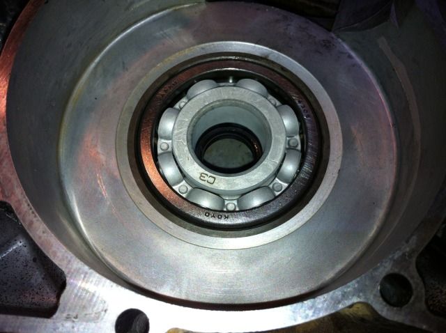

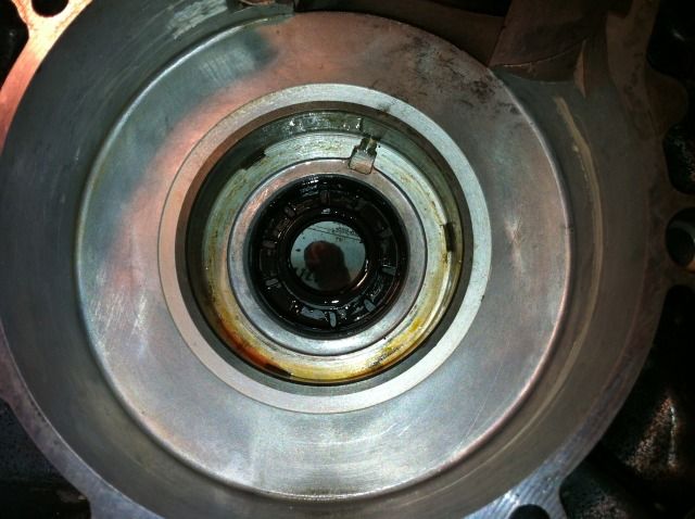

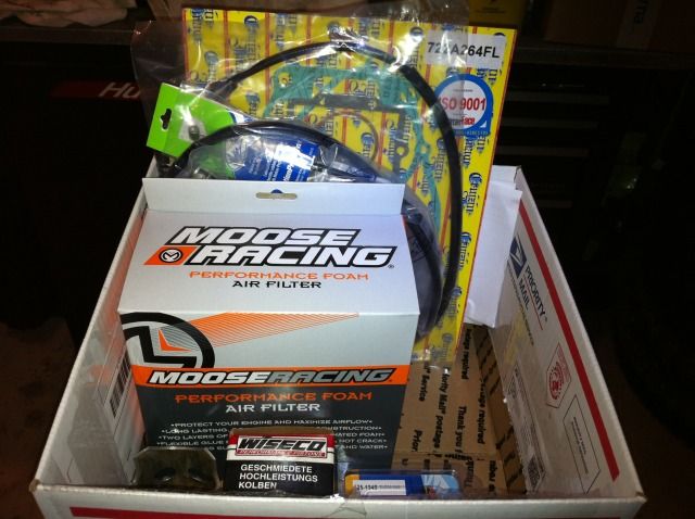

Many days elapsed, minor progress achieved.

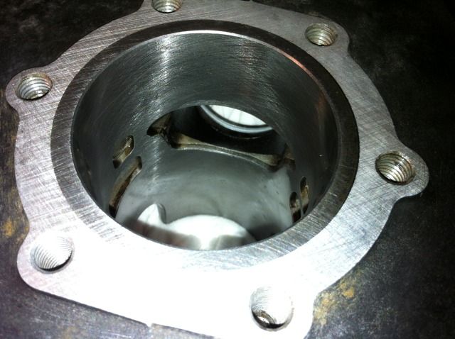

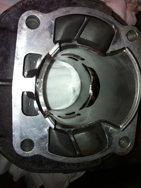

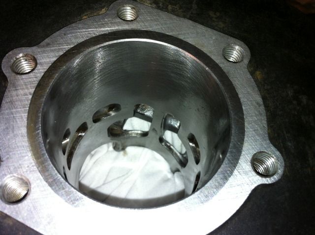

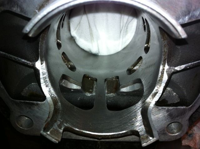

Mrs. Postmanlady has been busy. Parts from lands flung far and wide. Gaskets from mother Japan, piston from father parts distributor, bearings from sister All Balls, air filter from brother Moose (ferried by squirrel).

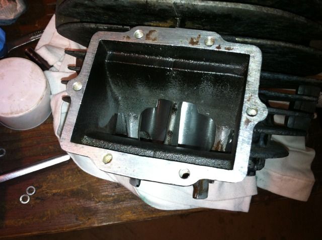

I got the call from Redline Motorcycles in Pemberton, NJ that my cylinder was done. Woot! I hopped on ye olde CL-gold Ninja 600 and zipped out to pick it up. They had to take it two bore sizes to get the grooves out. Most all of the surface rust pitting was eliminated, too. There is still a little bit on the bridge in the intake port as well as on the lowest part of the sleeve, but I'm not concerned.

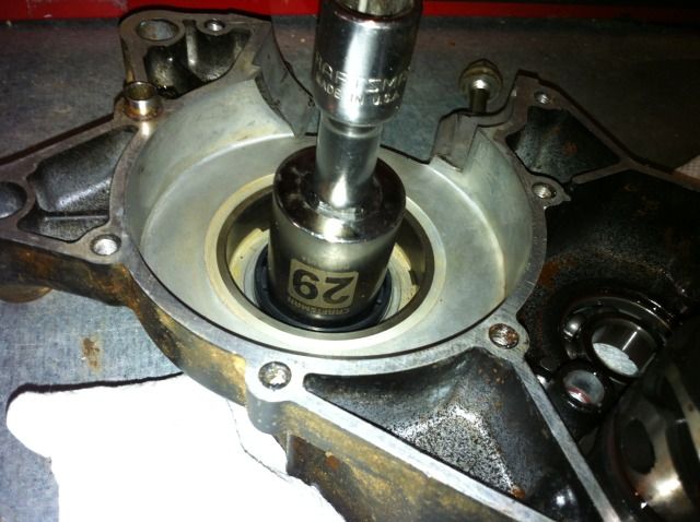

Before we get started, I remind everyone to keep a clean, organized work space. I cannot understate the importance of this enough. :)

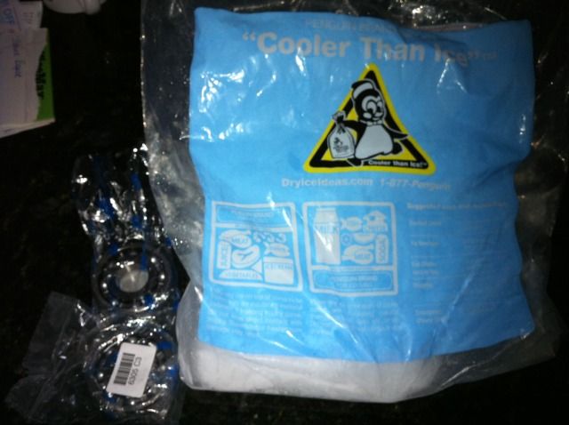

I sent my grocer gopher out to the local grocery store to pick up some dry ice. She returned with $1.19 worth of solid CO2.
Bearing chiller.
In my excitement to try the dry ice bearings/ambient temperature cases experiment, I almost forgot to put in the new crank seals. Would I have been pissed if I'd totall forgotten.
The bearings were super frosty. I wore a pair of semi-thin winter gloves to avoid freezing my finger tips. Ambient temperature was about 65 fahrenheit in the garage (love that cool fall weather). I rapidly transported the frosty bearing to the case, dropped it into its hole...and it went in about a millimeter. D'oh! I quickly tapped it out from the other side and put it back in the chiller. Unfortunately, I don't think this is a viable trick. Maybe if it was a scorching hot day, but there just wasn't enough shrinkage for them to drop right in. I had to resort to the torch to put a little heat in the cases. After doing that, they dropped right in.
So that's all the progress for this weekend. I'm racing a hare scramble on the Husky tomorrow, and I doubt I'll be doing much in the garage when I get home.
I'll probably get the motor back together next, then I have to start in on the forks. Then disassemble, clean and lube the linkage and swing arm bearings. Then rehab the plastic as much as I'm able/willing. Then tires, cables, missing fasteners... I'll keep ya updated!
Bearing chiller.

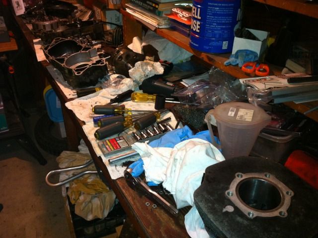

By the way, the picture of your workbench was eerily similar to mine when you posted the pic. Engine split and on the left, head on the right, three screwdrivers next to the head, etc. It was very strange.

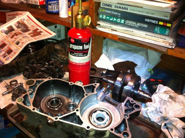

Sorry for the delay in any updates, but I really haven't gotten much done in the garage lately. The last couple of enduros and hare scrambles ahve kind of forced me to dedicate wrenching time to the race bike. Plus, family life has been very busy lately. But I promise I'll have some better updates soon.
As it is, I managed to get the crank pressed into the right case half. The first time I tried, the chamfer on the crank caught the edge of the new seal and turned it inside out. When I removed the case half from the press, the crank wouldn't move freely in the new main bearing. The twisted seal was binding it up. I pressed the crank back out, got the seal unfolded, put the seal spring back into place, and pressed the crank in again. This time, I removed the case half from the press a couple times during the process to make sure the crank shaft was not deforming the seal. Success. Next up, joining the case halves.

I finally scrounged up a few hours to reassemble the cases today. The main catalyst for this is the long line of other bikes I need to work on (I'm looking at you, Husqvarna with the coolant-fouling spark plug, and you KX-DX hybrid with the broken powervalves). I can't fix the racers with the air cooled motor exploded all over my workbench now, can I?
First things first, I'm put the transmission together with the shift forks and tested to make sure everything spun nicely. Clunk. I couldn't get the input shaft and output shafts to spin freely when they were meshed together. What the...? Each shaft with its gears in place by itself spun great. Together, they would not turn more than half a revolution before something would clunk and stop the presses. Hmm... I printed out parts fiches to make sure I had all the correct washers and spacers, that the gears were on the shafts correctly, and everything was groovy. But no dice.
It's at this point I made a command decision. The trans shifted fine before I took it apart. I lost no pieces. Nothing was worn or broken. So if I just joined the cases, everything should work, right? I barged blindly ahead, hoping that the problem would somehow fix itself.
Threebond placed, cases joined, crank centered and...transmission shafts still clunking to a halt. Bugger. Just for giggles, I put the shifter mechanism back on to see if moving the drum around would get things going. When tightening the ratchet hold-down bracket thingee, I heard the shift drum press a couple millimeters into its bearing...Ah-HA!!! When splitting the cases, the shift drum pulled slightly out of its bearing, resulting in the shift drum being in the incorrect position. This caused the shift forks to have the gears in incompatible positions for the shafts to turn. Now it shifts just like it did before tear down.
Phew!
