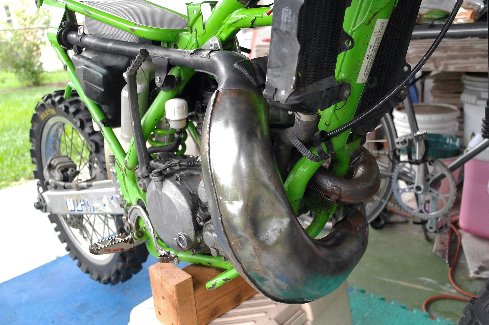

Haven't updated in a little while because I have just been doing small stuff not worthy of an update by themselves.

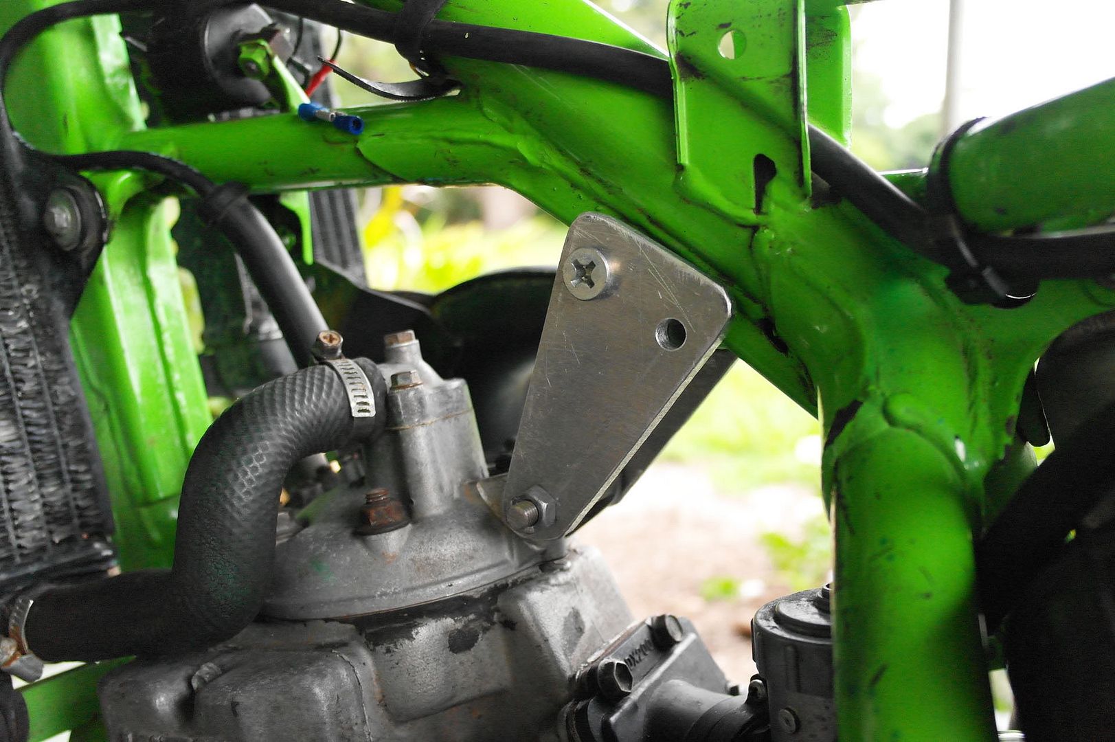

I made the top engine bracket out of aluminum since it was missing. I will be getting proper hardware for it soon.
Since the top of the air filter box was missing I threw some metal screen over it just to keep a little more stuff out.
I did a lot of just general cleaning. Wire wheeled the exhaust to bust most of the rust off.
Looks pretty decent now aside from the dents which I may or may not attempt to torch out.

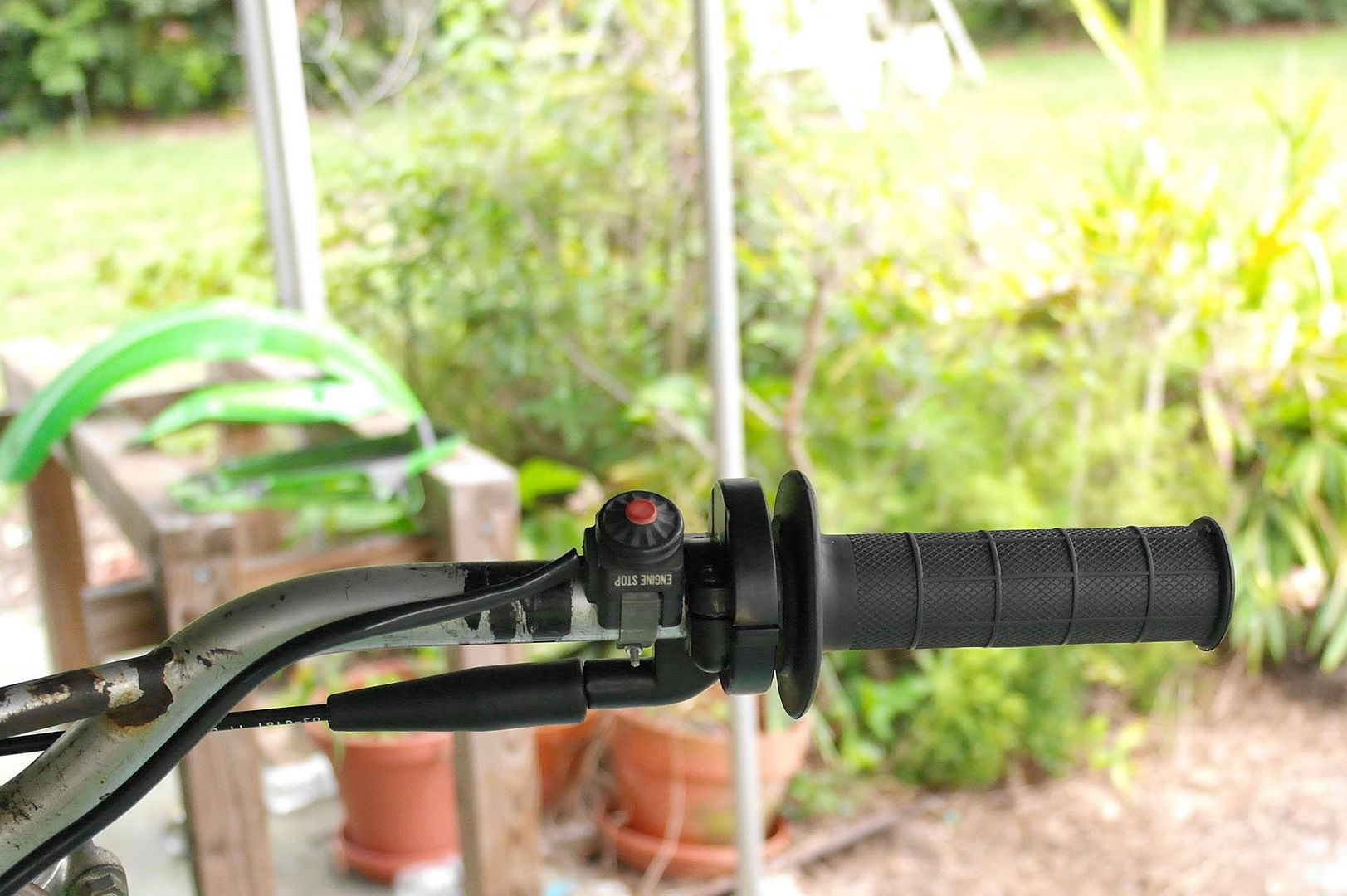

My grips and throttle cable came in the other day so I got them all installed.

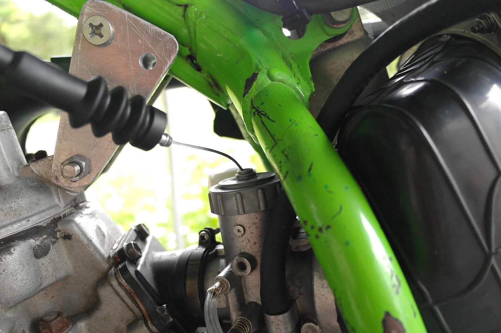

I have an issue with the throttle cable though. There is supposed to be a little elbow/collar things on top of the carb but since mine is missing I will have to rig something up for that. Shouldn't be too hard.

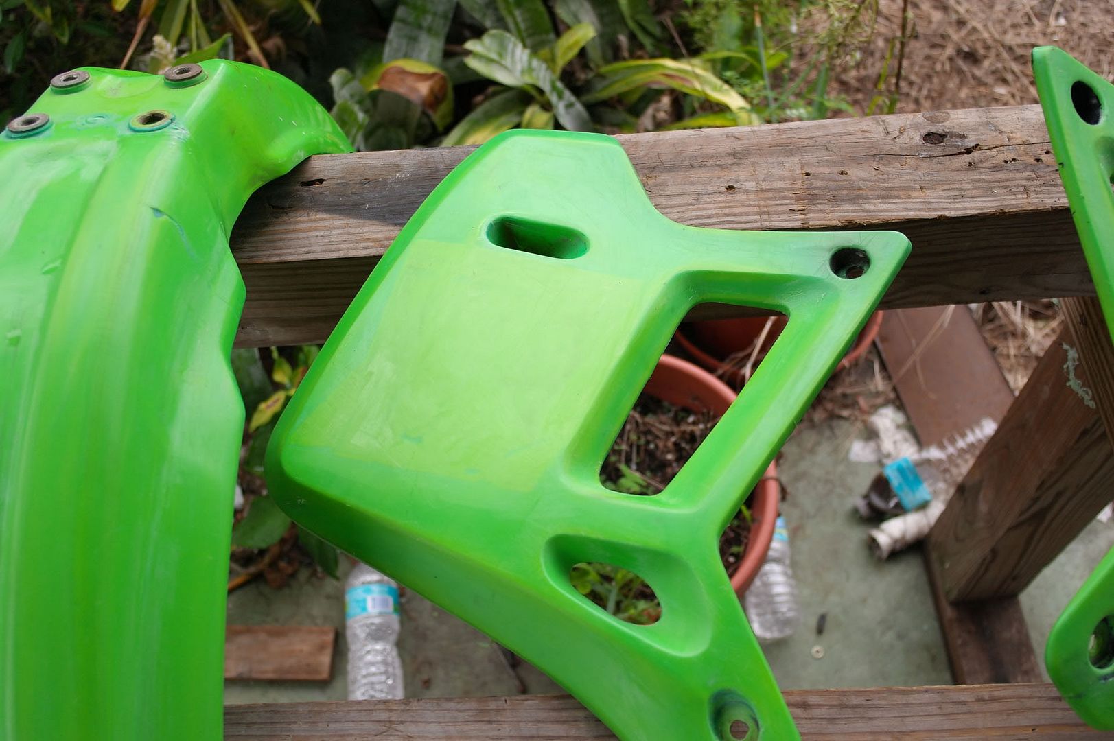

Also got the plastics cleaned up. The PO had painted them a darker green at some point and then spray painted half of them black over that. The dark green stuff was really stuck on there but some elbow grease with a razor blade got everything off eventually.
I kind of like the big hole in the front fender. Looks like a gun shot.
I also was able to pick up a used set of kx500 rear/side panels in white off of eBay for I think a really good price. ($25 shipped) Those should be here sometime this week or next.

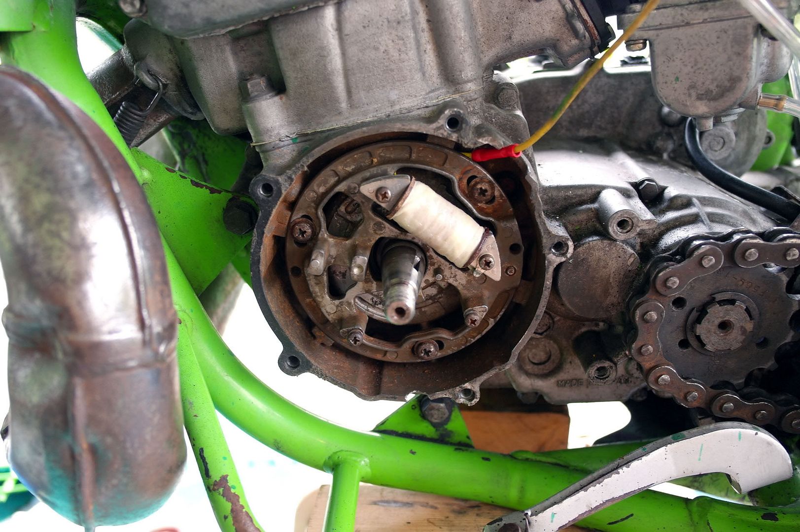

My stator coil finally came in today too.
Got it installed and did get the bike to start and run a little bit but it didn't idle very well and then it would randomly just blast to 100% throttle, making me jump for the kill switch super quick. The carb is definitely going to need some attention and I may end up just selling this one (Mikuni VM32 I believe) and getting a PWK35 if I can't make due.
Question 1: When I was trying to start it, it took a lot of kicks and would often "kick back" really hard. Is this "kick back" normal?
Question 2: When I pull the plug and kick it over, the spark is very faint and I can't really tell the color. I am used to seeing a fat blue spark. Is something wrong?
Question 3: This one may be related to question 2. Does the source coil go in the top mount on the stator or the bottom or does it not matter? The two mounts have different heights so maybe since I put it on the lower top mount it isn't making as good a spark as it should?

Questions 1, 2, and 3 are all related IMO. The timing is off. The shorter stator mounts are for the lighting coil and the taller ones for the source coil. So, yes, your source coil is mounted in the wrong location.

Oh ok well that is good (I think). The service manual doesn't specify so I figured it might not matter and just went with the more convenient one.SS109 wrote:Questions 1, 2, and 3 are all related IMO. The timing is off. The shorter stator mounts are for the lighting coil and the taller ones for the source coil.
I don't know about 2 strokes but 4 strokes can get seriously screwed up if the timing is way off. Will the bike be fine?
Anyway, when I get off work tonight I will use my brand new flywheel puller I got in today and change that coil position. Hopefully I can get her to run at least consistent even if not correctly.

Yeah, a 2T will be fine. Hell, they have even known to run backwards! Put the source coil in the right spot, check that your timing marks are in the range they should be, and that the woodruff key is in good shape, and you should be good to go.

So I got home and worked on it a little more. Switched the coil position to the bottom one. Cranking it over seems to give better spark, it's hard to say though because it was night so it obviously is going to be a lot easier to see.

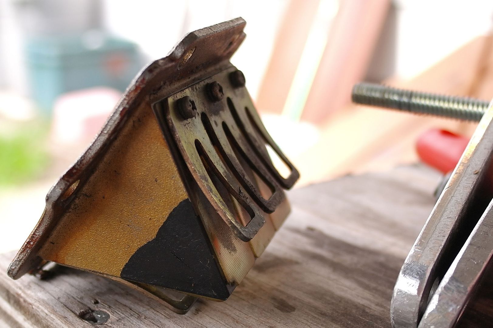

Well I took the reed box off today to check the reeds and take a look at the piston/cylinder.
It looks like someone used sealant or something on the carb side. I'm not sure what is going on here.
Also, one of the reeds has a small chip in the corner so even if the box is usable, new reeds are in order.
I don't really know anything about piston/cylinder condition so I will just post and you all tell me what you think
In the second picture there is a lot of discoloration on the sides. The piston itself if butter smooth to the touch, even on the discolored areas.
If you all think it is something to be worried about then I will go ahead and pull everything off and get a real look and see exactly what is going on.

Definitely needs a new reed cage and valve. I can see the corner of one broken off. Don't know what or why all that goop is in there. Looks kinda like melted plastic but could also just be discolored clear silicone. Stupid previous owner whatever it is.
