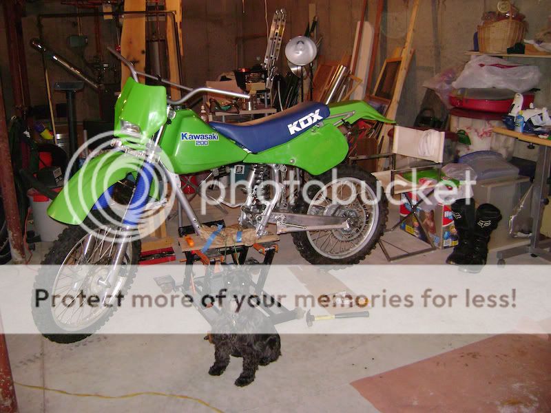

Again not much progress, just got the bars, light, swingarm and shock on (sort of) there's one bolt I have realized is bent...
so I'll need to head over to used bike shop and do some digging, otherwise it's going back together ok.
I had forgotten just how long and thin this bike is (compared to my KLR 650 it's a toothpick), and am sort of remembering
when I rode a KDX back in the early 80's that this was one of the advantages of the bike on the trails. At the time I had an IT 175, but I really liked my friends KDX.

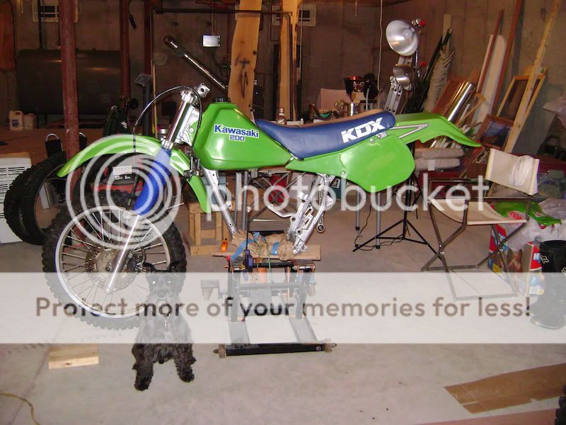

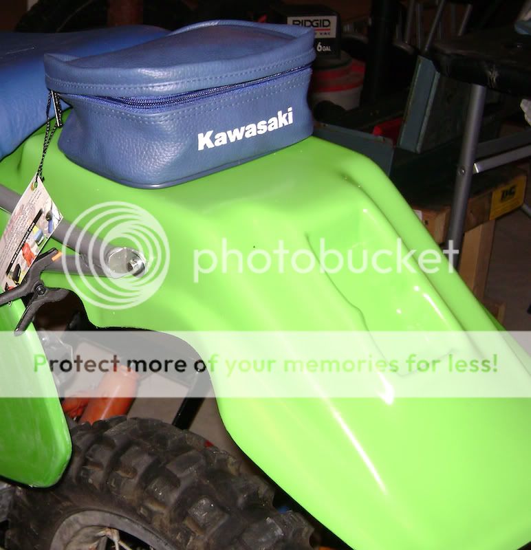

Well I got everything tapped and was able to place the plastic for fitment and how it feels. Feels good, pretty tall.
I also got an inexpensive tool bag from Boliviaxport, you can find them on ebay, and I have to say I am impressed with the quality and look.

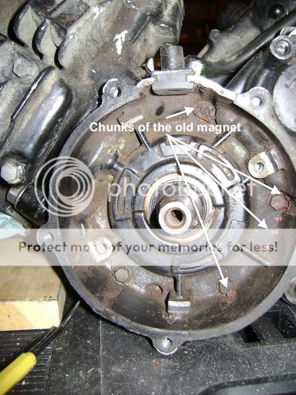

Doing a LOT of cleaning today. Look at all the flecks of red epoxy from the old
rotor.
Unreal just how much magnet chips were still floating around in there. This is why it pays to have one or two strong magnets at your house.
I just swiped this one around in there and look at what it picked up.

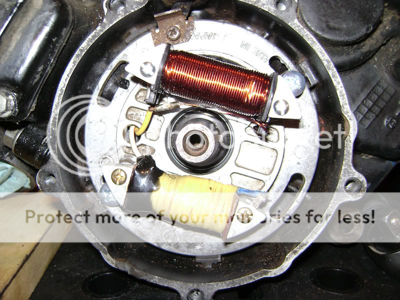

Just seeing how the stator fits. I know that wire off the lighting coil looks in the way but when I set the rotor in to get a look at how it's going to set, there was plenty of clearance.
This is the way Fredette fixed it so I'm going to leave it be unless I have a problem. If I do I'll see if I can run it behind but it's pretty tight back there too because of how advanced
the base was cut compared to how it was stock. You can see the original timing mark in the slot right behind the blue wire coming off the source coil or about 4 O'clock mark.
I'm still fishing old magnet and epoxy chunks out of there to.

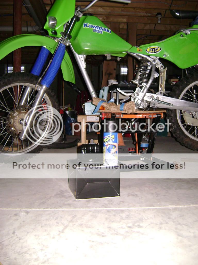

While it was out I figured I'd apply the PlastiDip to the boots which had cracks, since I couldn't do much else. I'd already tested the stuff on
some other materials, plastic, metal, wood, cotton gloves and read about a few other people having restored vintage parts with the stuff -
picked it up at Lowes. The stuff is pretty easy to apply, like spray paint, and seems to hold up to petrochemicals well - at least over the past
several weeks of testing. So this is what my boot looks like before.
This is what it looks like after the first coat, I'll lay on a couple I think.
Can't wait to get some more parts back on.

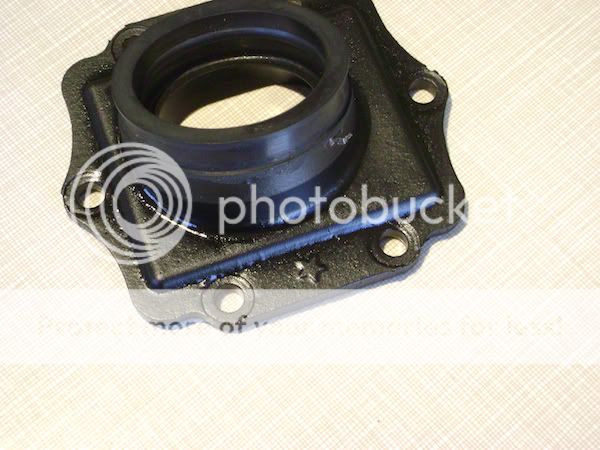

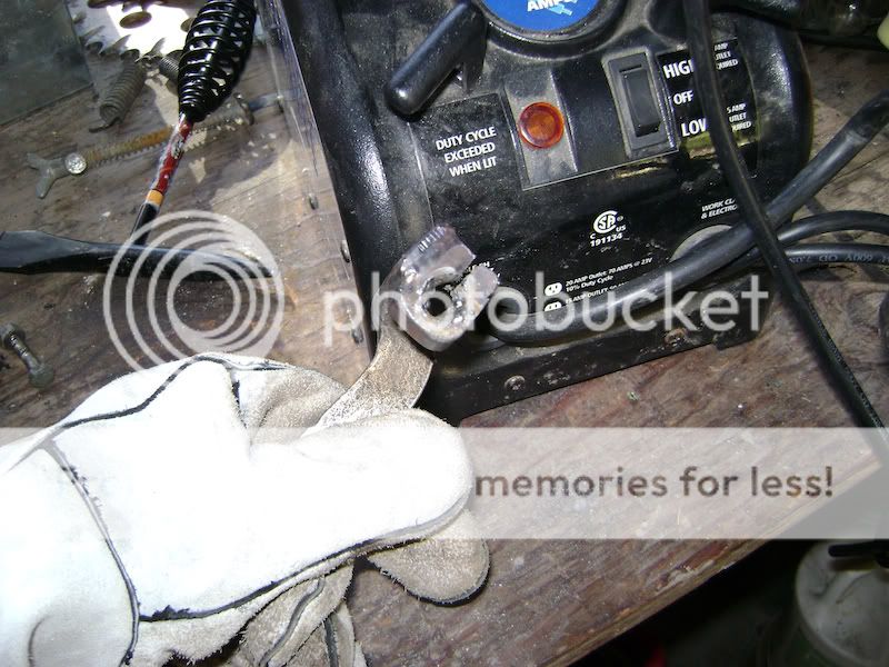

Just doing a bunch of little stuff lately, like figuring since I had to remove the weld the PO used to attach the shifter, I might as well experiment a bit. So
I spread the gap, and laid a few beads inside the shift lever where it had stripped, retapped the bolt hole to 8mm and now I'll cut some groves and repaint. Even if it doesn't work I still got to have fun.
I also applied Plastidip to the intake boot, which was predictably cracked to pieces. I only wanted it on the outside since the inside was fine and I didn't want to disrupt how the fuel flows.
It's pretty good.
