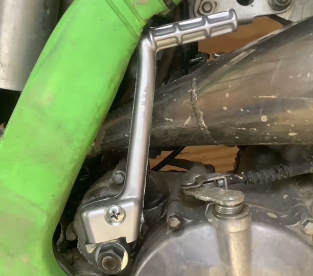

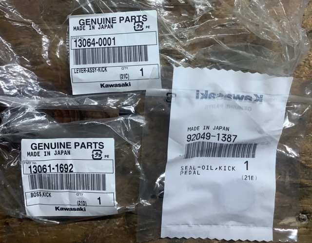

2022 mod UPDATE…
After endeavoring to undertake this nifty upgrade I ordered the 250’s boss and the 125’s lever assembly from RMATVMC. The 125 kick lever is not available as a separate item new, but the assembly comes pre-assembled with the grease seal place. I ordered the extra grease seal for future maintenance.
There was an issue with my matchup that required some extra elbow grease beyond what was noted above…
I found after inserting the 250 boss into the kick lever that the retaining shoulder screw would not fully reinsert.
Close comparison and examination of the two bosses revealed that the retaining channels did not quite match. Reinserting and using a light I could see the problem was at the top edge. It was close enough that a 11/64” chainsaw file carefully applied to the upper inside channel of the boss - along the range of motion across where the retaining shoulder bolt sits as the lever rotates - allowed for the proper fit.
If you don’t do this, but try to force it, you will strip your bolt threads.
After a number of passes with the file and refittings, everything finally fit properly. One more note: I also run the green plastic frame guards. Rather than filing back the heal of the kicker I just removed a little plastic with my solder iron till it passed by cleanly.
Thanks to Slick_Nick for his work in the original post and help finding it for me.
