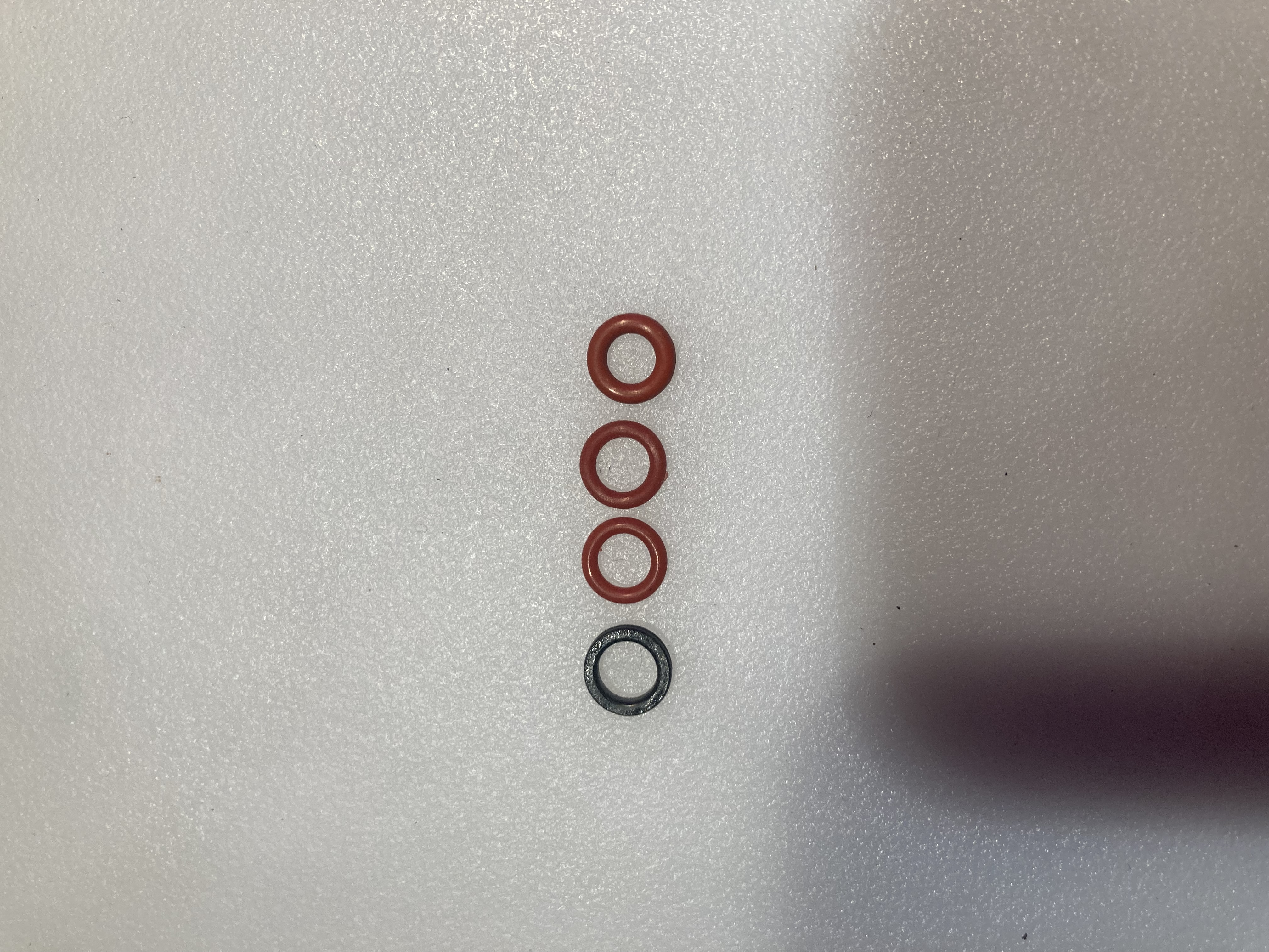

I received some of the 4.5 ID x 8 OD x 1.78 CS o-rings from Bill. Thanks Bill! Unfortunately the 4.5mm ID is just too small and causes the O ring to swell to a massive .335” when installed on the shaft. Too large to even enter the bore.
I’m including a picture of the OEM packing seal, my 5x8x1.5 eBay o-ring, the nearly identical FRP O-ring, and Bill’s 4.5x8x1.78 o- ring (left to right). Just FYI, the eBay o-ring and the FRP ring both measures .320” installed on the KIPS rod. The OEM packing seal is used and measured .316” as best as I can tell.

Thank you so much for fitting the wider o-ring and sharing your observations. Due to combined efforts, now we can all know the wider o-ering is a No Go.
So far, we have one o-ring option verified by Fredette and at least 2 KDX forum members.
