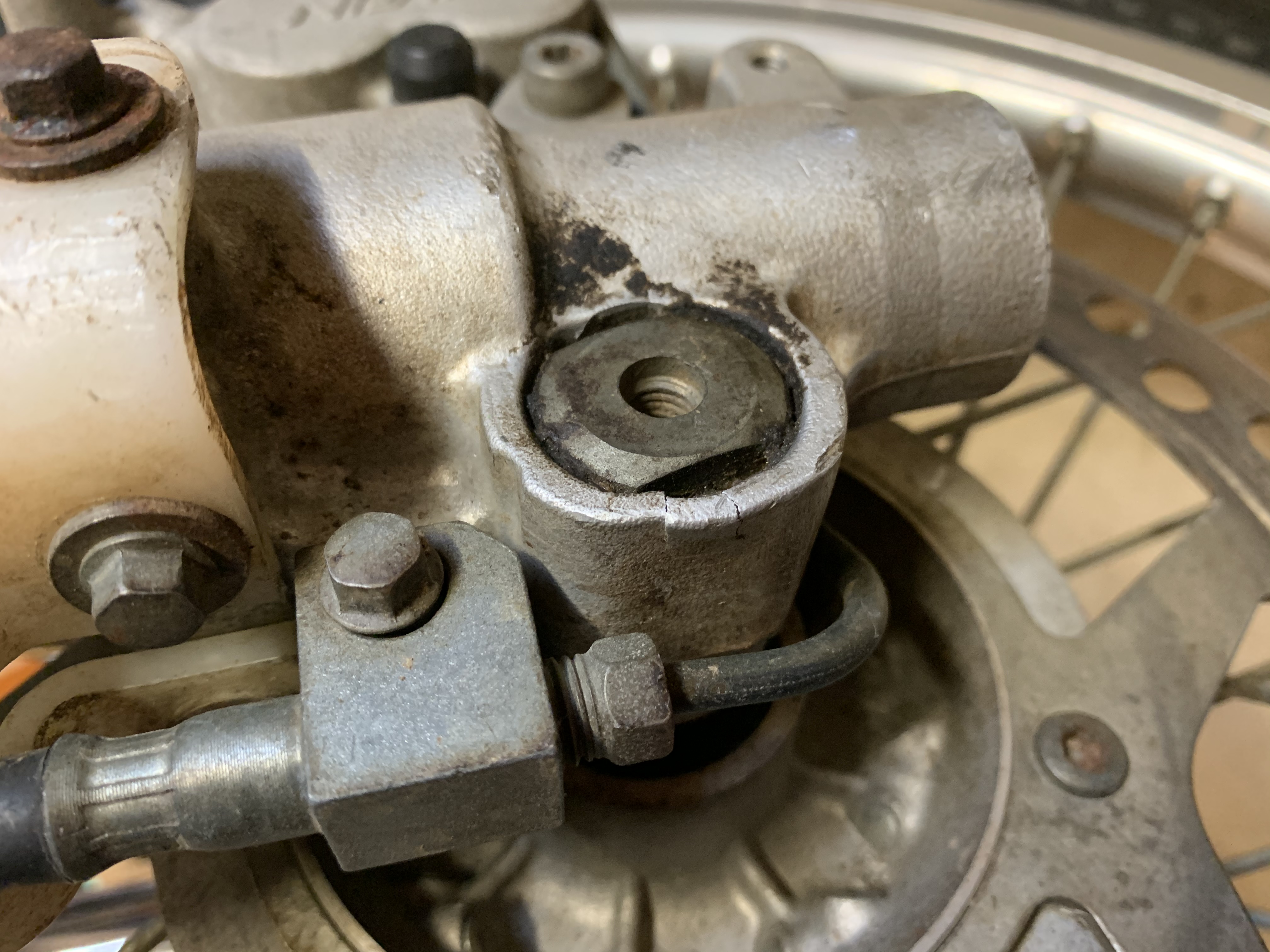

Posted: 06:09 pm Jun 02 2021
by emmett
About to remove front wheel, and noticed this. Looks like someone jammed a flathead in the fork where the axle slides in, and did some damage. Doesnt seem structurally compromising how it is, but is it worth getting welded to prevent the crack from spreading?
Posted: 06:39 pm Jun 02 2021
I'd just keep an eye on it for now.
I am not sure how well welding on a fully assembled fork would go.
Posted: 06:52 pm Jun 02 2021
by emmett
KDXGarage wrote: 06:39 pm Jun 02 2021 I'd just keep an eye on it for now.
Okay will do. It seems like its only the real thin piece at the edge thats cracked. If i did weld it I could weld it with the axle out, and just dremel it to make it look factory... or at least the same shape as factory :mrgreen:
Maybe someday!

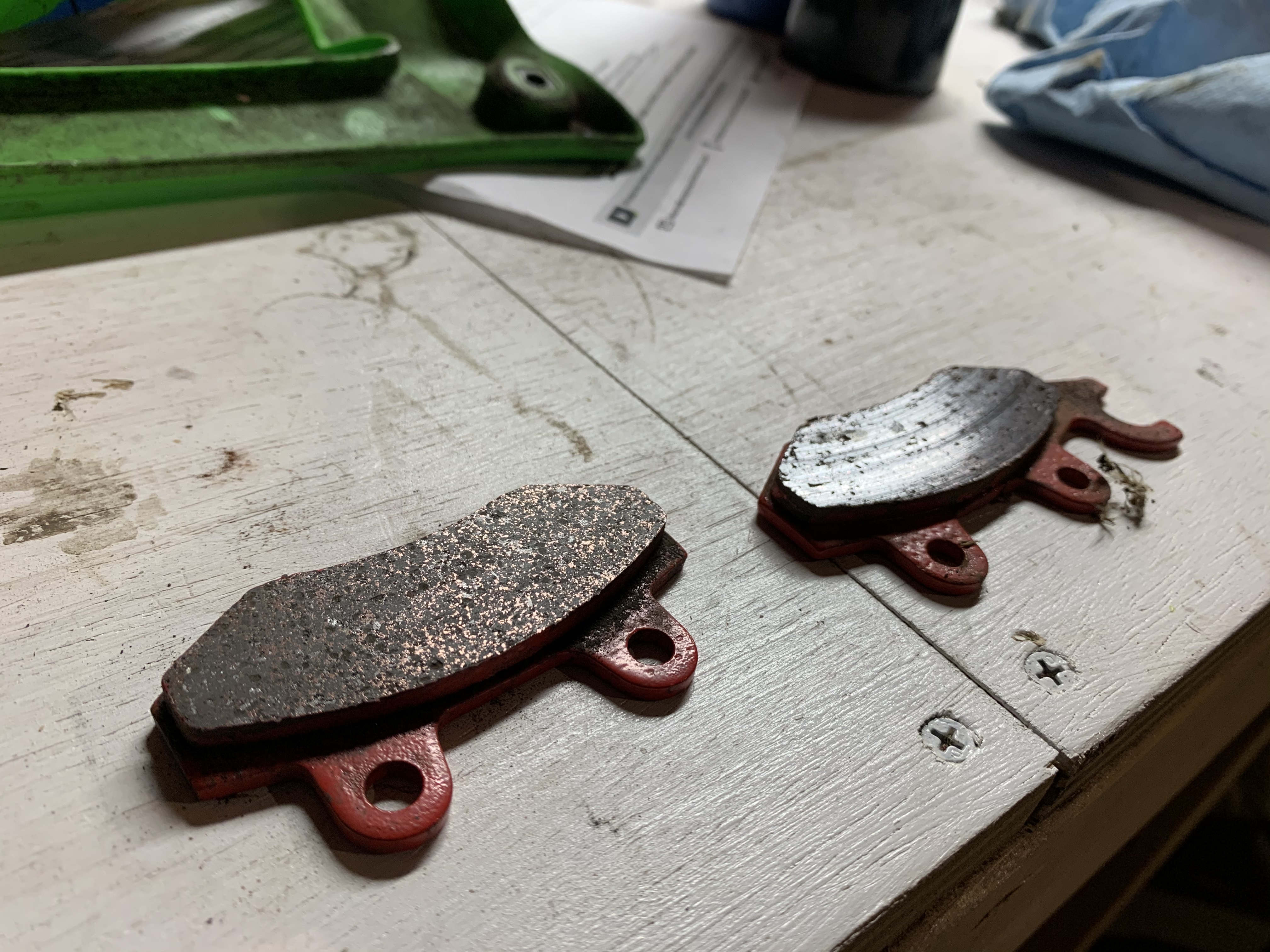

Posted: 09:48 pm Jun 02 2021
by emmett
My shitty allen keys couldnt get the front rotor off so i sanded the outside decently and barely touched the wheel side of the rotor. Sanded my brake pads to see if theyd bite at all in the meantime while I wait for my new pads.
Ill either get allen bits for my milwaukee impact driver, or replace my husky T handle allens with something more rigid. Even with a fair amount of heat the allens were bending like twizzlers. Ill need to get that rotor off and cleaned up before the new pads go in.
one pad sanded and one not. that glazing could be part of my problem!
Posted: 11:46 pm Jun 02 2021
Yeah, that glazing is no help.
