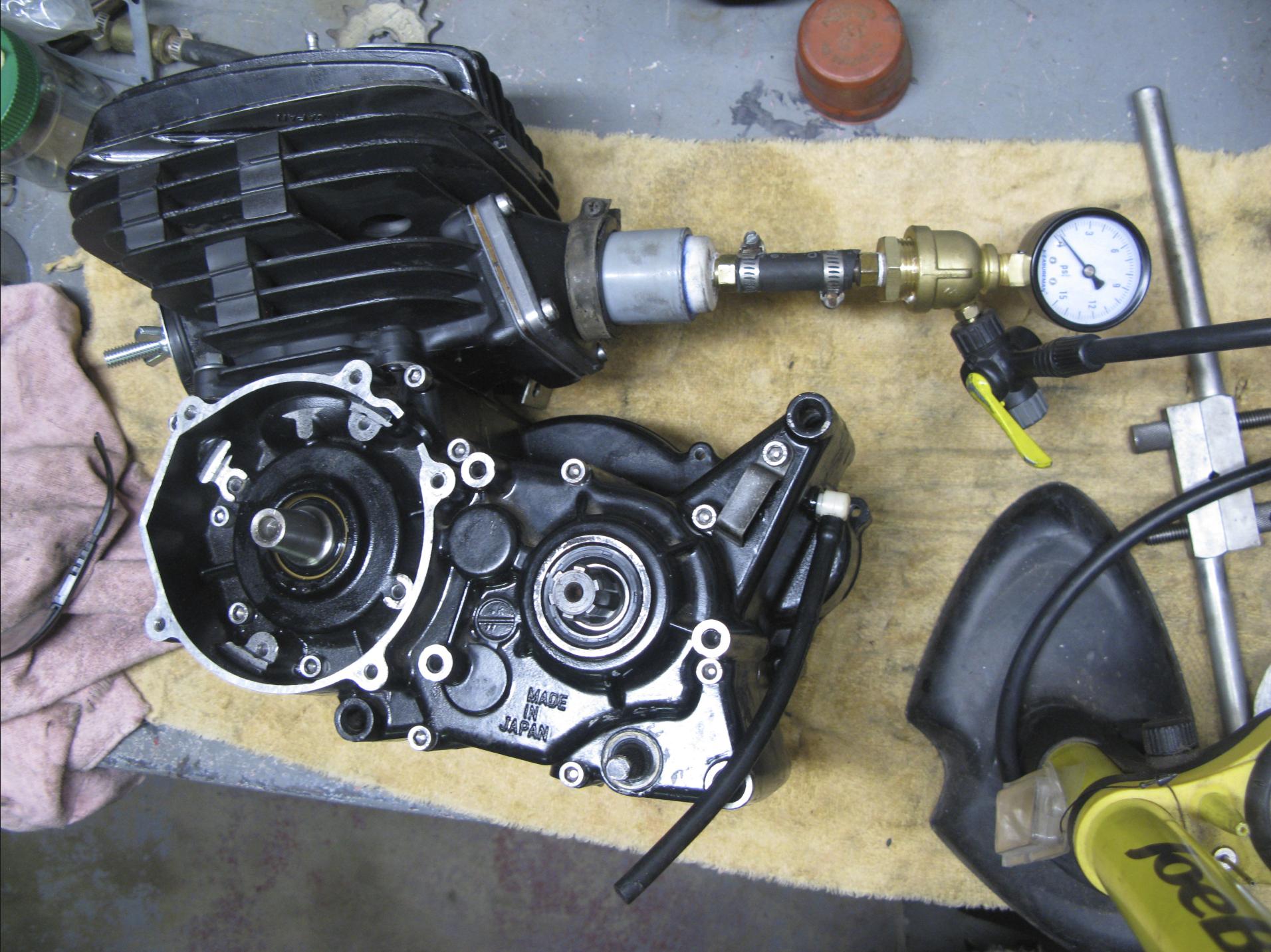

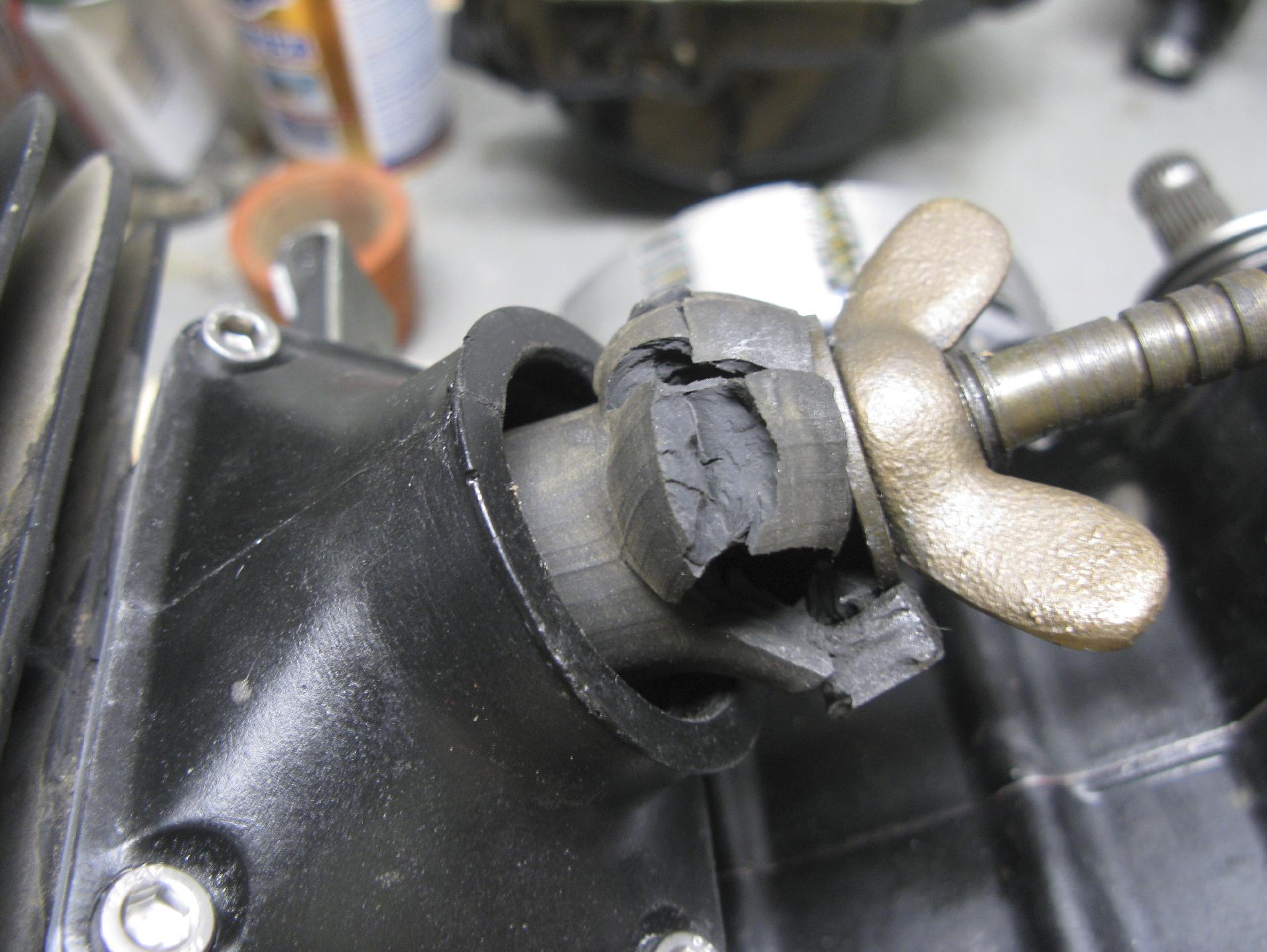

Well, this seems to be the week of failures. I went to do another leakdown test after the JB Weld had hardened and discovered that my expandable plug had reached end of life.
Plug failure
_click image to zoom_

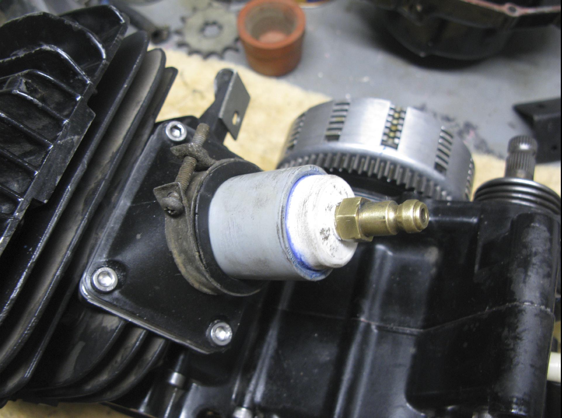

Ok, no problem, found some bits and pieces for a substitute.
1/4" pipe thread
Back in business, but no joy; the pressure drops from 5 psi at about 1 psi per 10 seconds :sad:
Looking for leaks
I sprayed soapy water everywhere (seals, plugs, head, spark-plug, cylinder base, intake, case screws, case seam, hose/gauge connections), pumped up and removed the pump - the only bubbles are from the crank seals. Looking closely, I can see the leaks are on the outer edge, where the seal is metal on metal - probably should have used some RTV I guess - which I will now do by taking everything apart and putting in new seals with RTV! (mental note: do leakdown tests straight away before putting other stuff on)

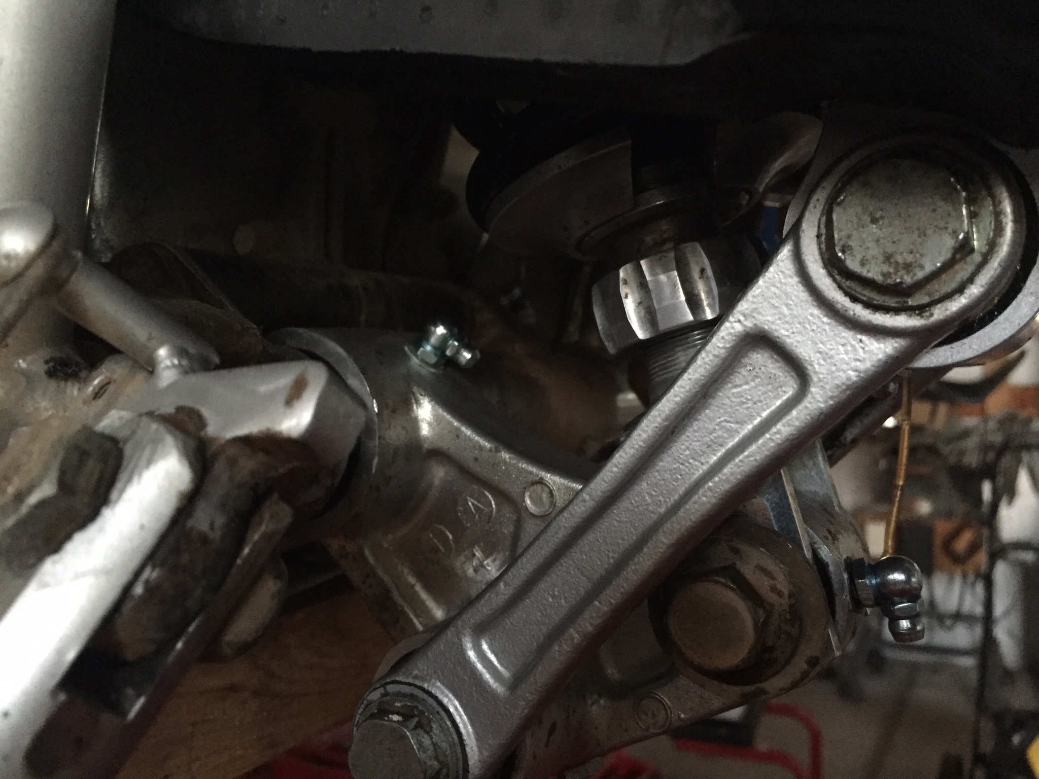

While drilling everything for safety wire, I was reminded that Zerk grease fittings on the rear suspension linkage seemed like a good idea:
Grease fitting locations
I did a quick read up and am thinking that 1/4-28 Zerks (the smaller size) would work. The plan is to turn the ball sideways in the ball joint and then drill through the suspension link and outer bearing shell. The drill size for the 1/4-28 tap is 3 ga. (0.213") so I think I can just use it to drill all the way through and then tap the section of the hole in the link.
Drill here
I looked around but did not see where anyone else has done this. Without grooves, I guess that the grease would not be evenly distributed but at least some would get in and hopefully work itself around :hmm:

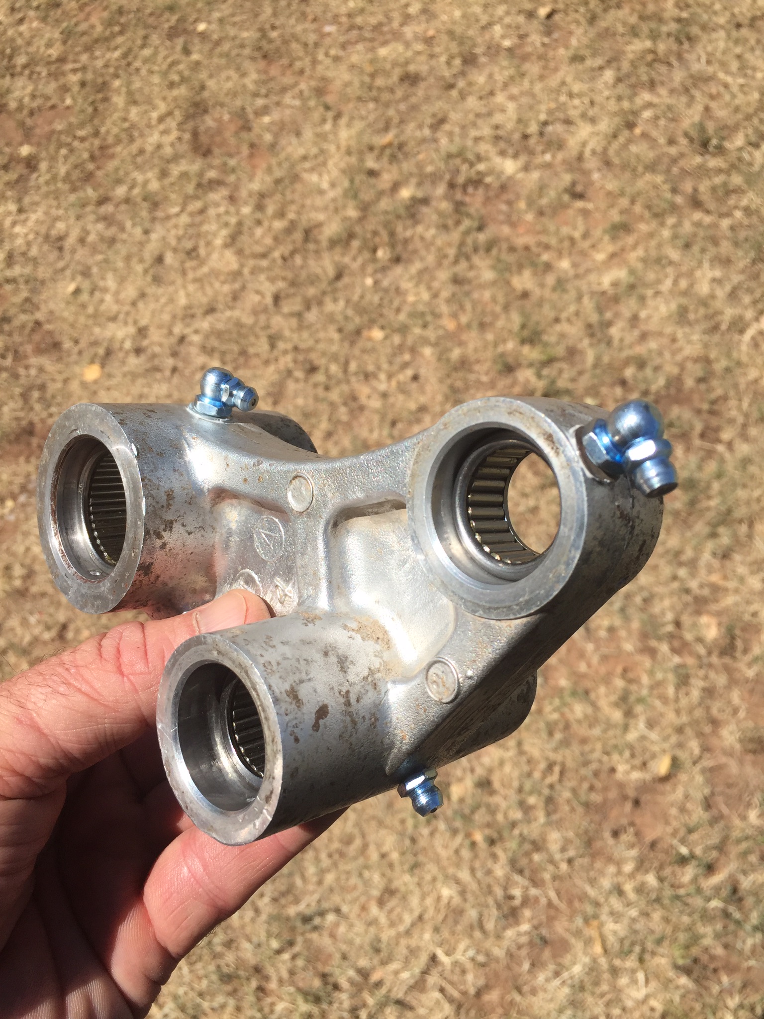

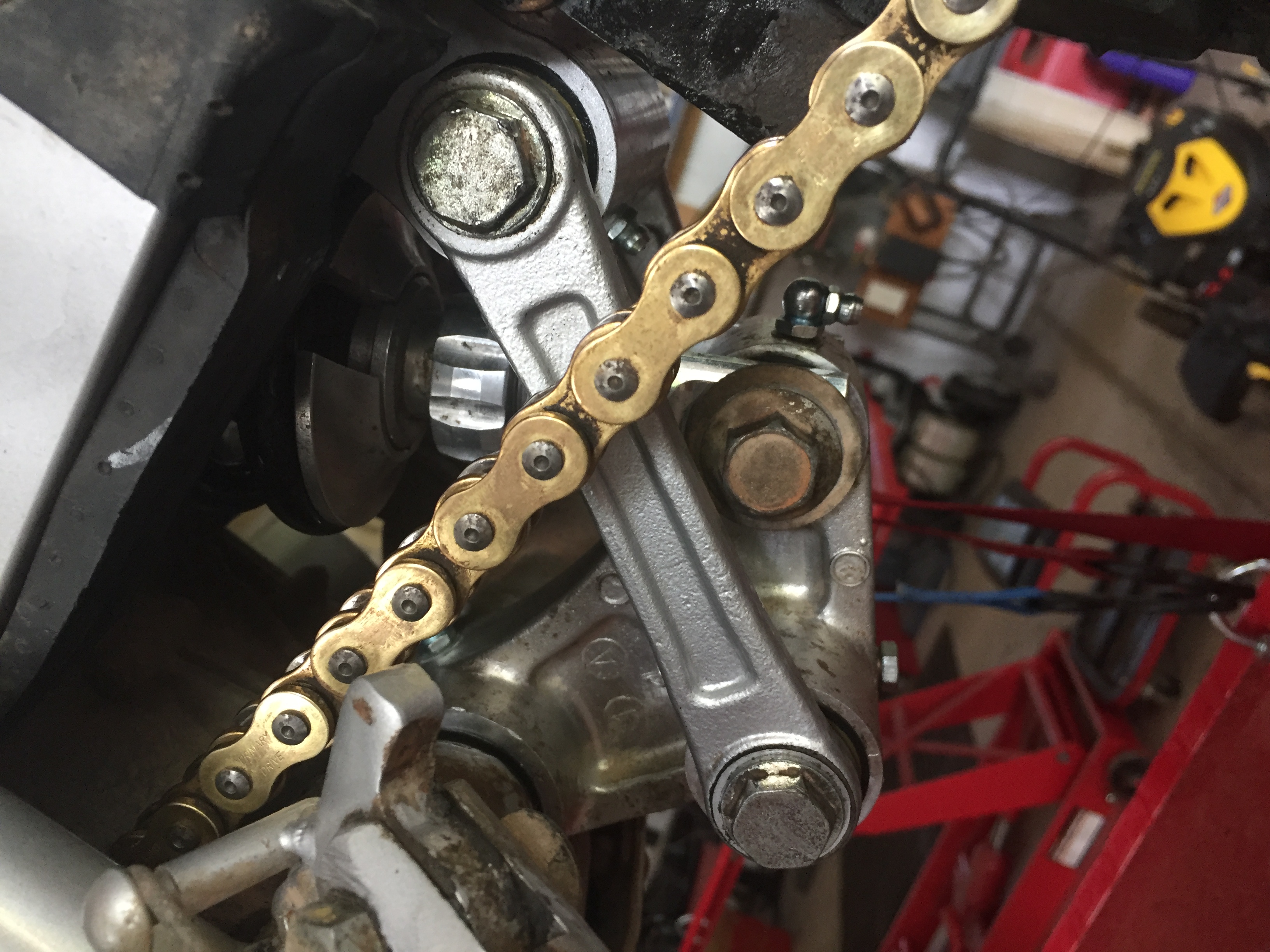

For each zerk you will also want a weep hole.
And what about the swingarm?
I put zerks in the swingarm and shock linkage on my KLR650. Kawasaki should have done it at the factory.
I have one zerk on the linkage that is facing downward and is vulnerable to damage by rocks and such. I pulled it out and keep a short bolt in there as a plug. I only put the zerk in there when I grease it.
Posted: 04:27 pm Jun 07 2021
by HopFrog175
Nice Zerks - thanks for the pics, I am inspired to continue! ( I am kicking myself for not putting them in when I first had everything apart :doh: ) The swingarm will definitely be included.
Posted: 05:39 pm Jun 07 2021
by Goofaroo
Yep. I was installing a new Cogent Dynamics shock and decided to rebuild the linkage and drill everything for zerks while I had it apart. It’s definitely worth the effort.

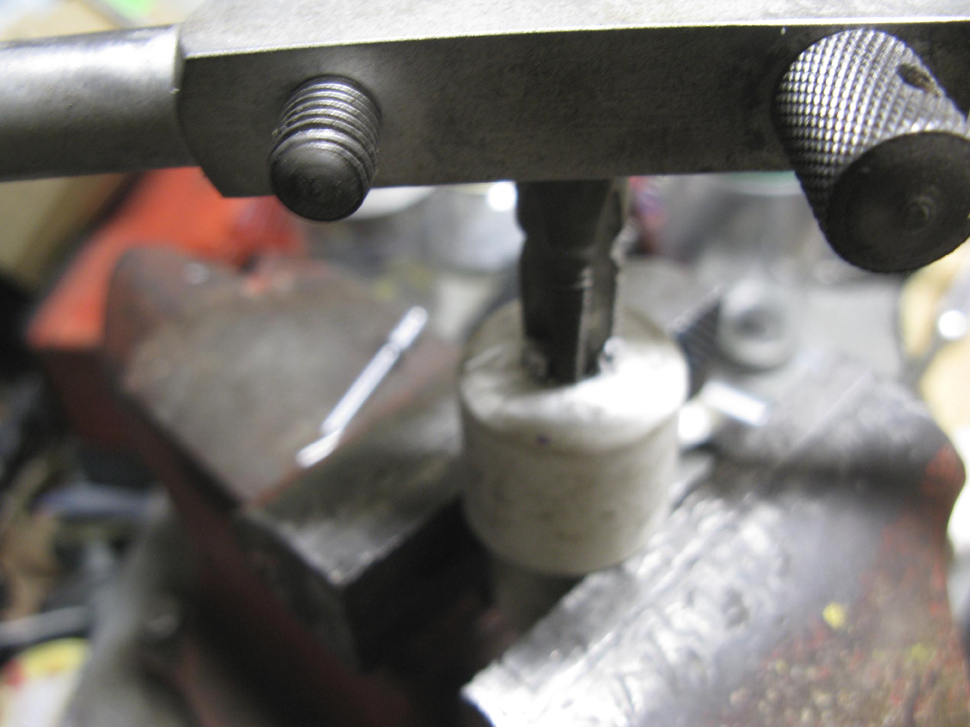

Drilling and tapping turned out to be easy. Too easy, almost. I expected the outer race to be hard and resistant to drilling - the drill went right through. After cleaning out all of the chips I illuminated and peered into the crack. Something was still in there (?) It looked like a bit of shredded woven nylon or something. Nowhere for it to come from except ... a hollow outer race?? It did drill really easily. This seems unlikely so I do not know what to think. Anyway, I used a tiny file to try and smooth out any burrs and rotated the ball back to normal. It did not seem to be any stiffer so I took this as a good sign.
