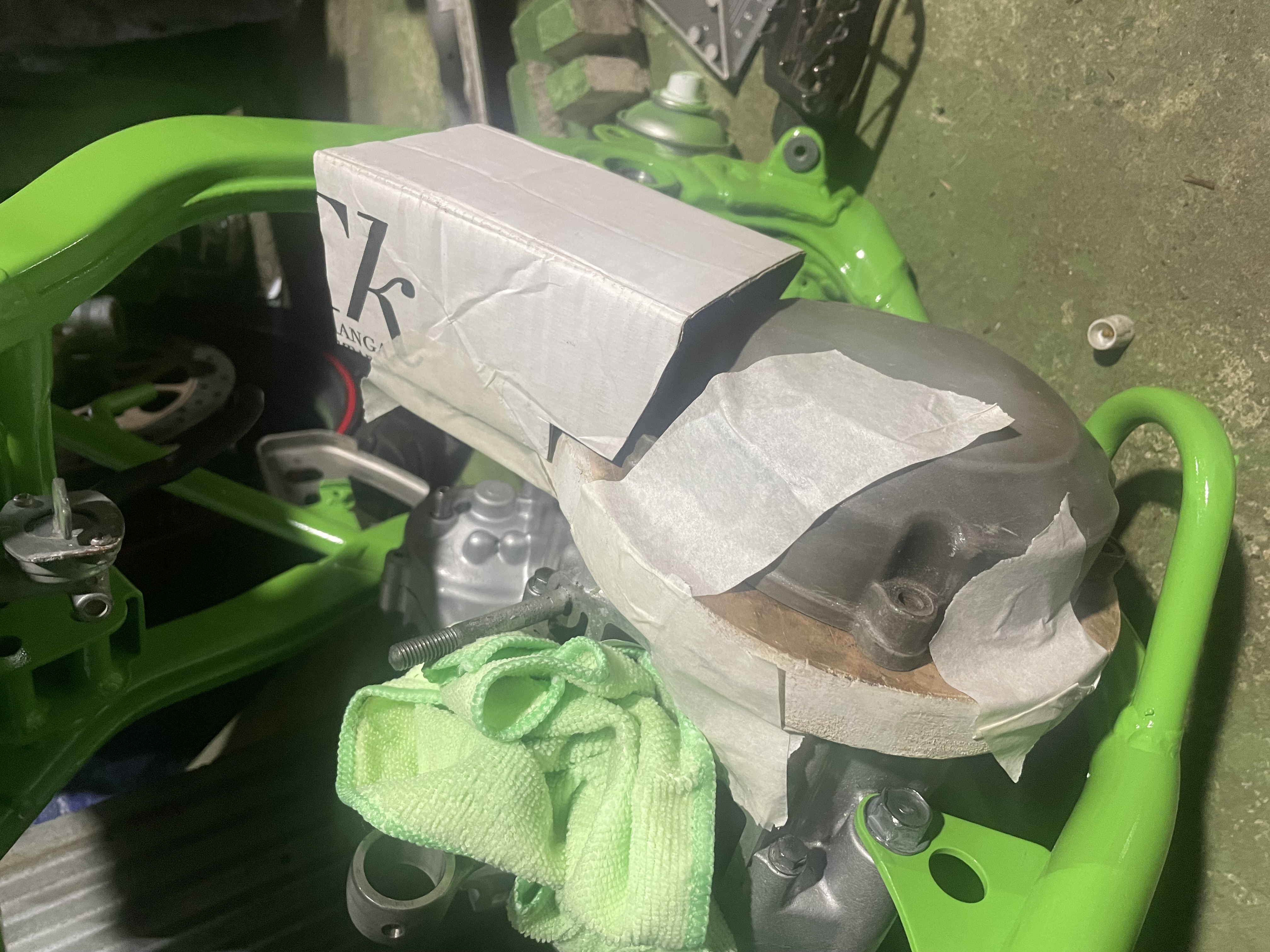

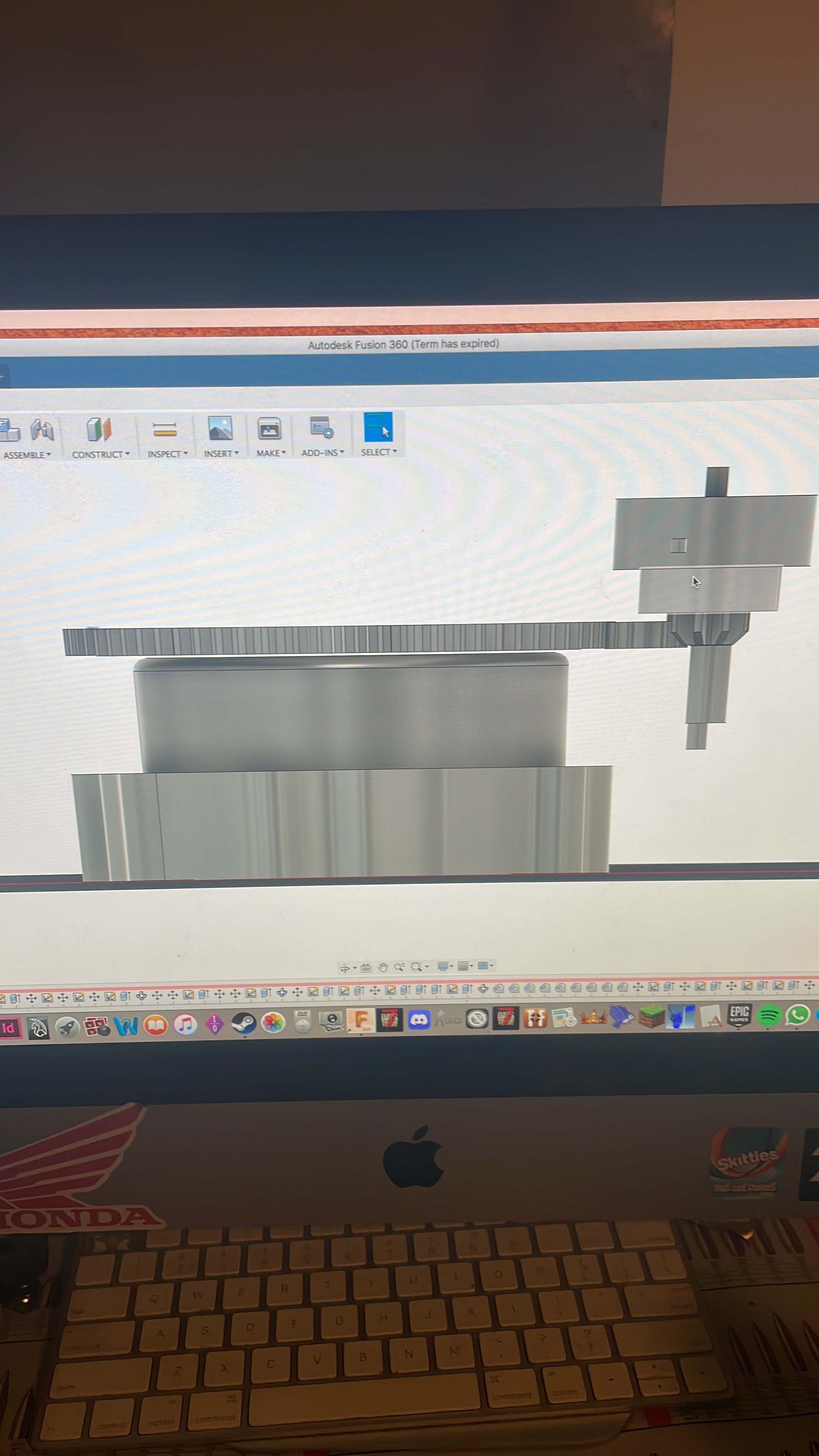

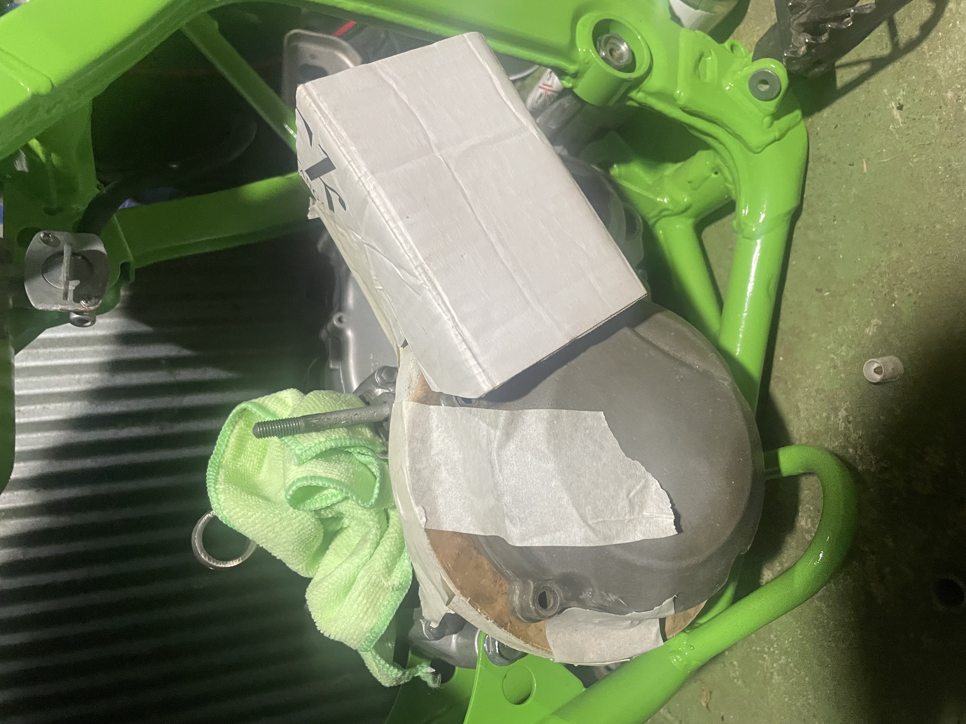

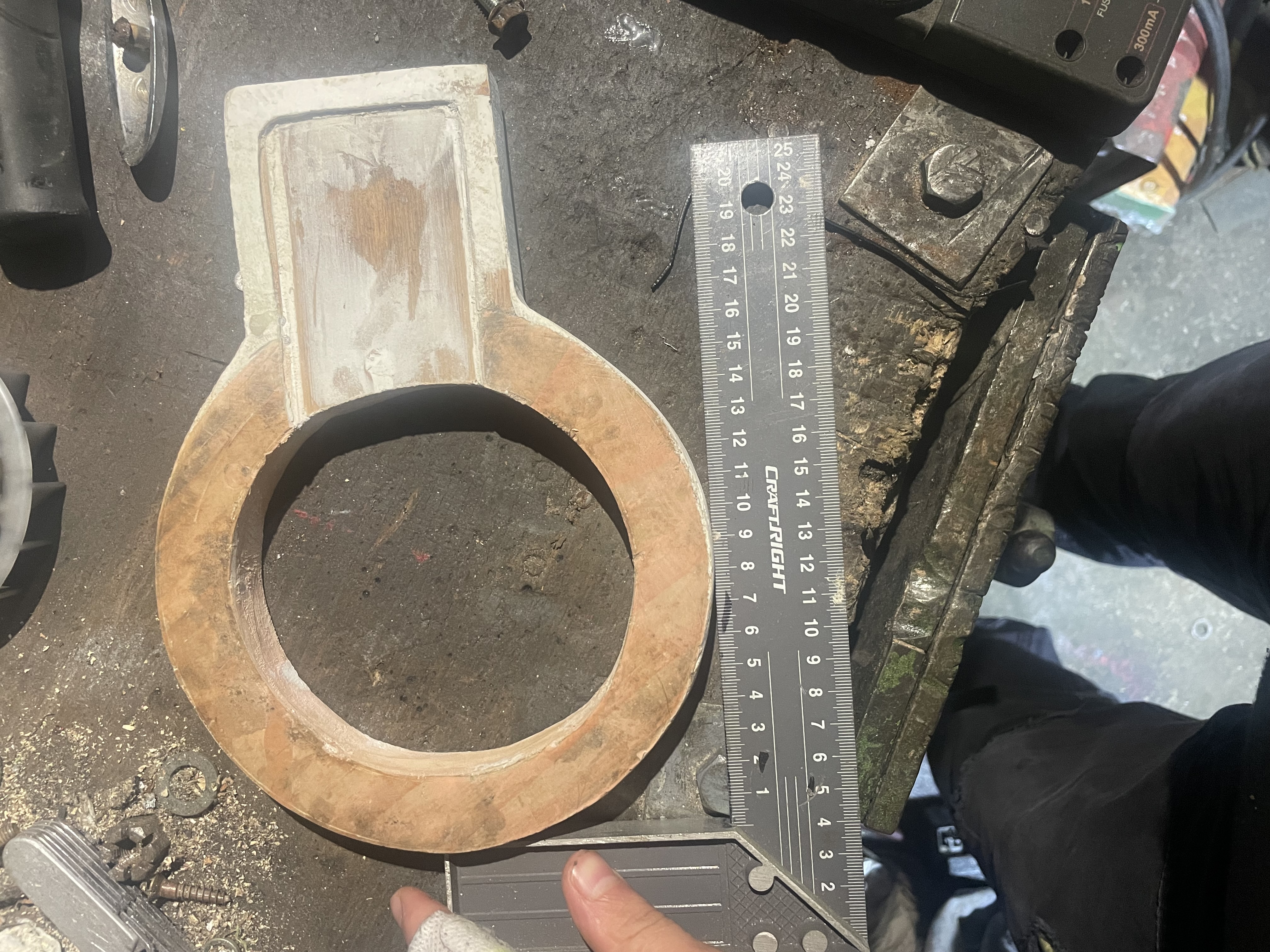

ImageHey everyone been following this thread from shadows for some time 😂. Had some difficulties creating an account for some reason, ss109 I tried reaching out on YouTube but to no success. I’m currently working on an KDX200 electric start design. My design, instead of using a one way bearing that requires oil and is constantly moving and adds yet another moving parts to worry about. I decided to go with a bindex instead, my design goes as follows a gear is bolted to flywheel (using the three threaded holes already available the bindex (CCW bindex so engine rotates in correct direction) engages with this gear via the starter motor which will fit nicely in that space under the reed block area and carburettor. Currently I have the CCW bindex, I have access to a cnc plasma cutter which will be able to cut the two gears I need and I’ve made a furnace and gotten a clay graphite crucible for the casing part of the e start system. Since the gear for the wheel has to protrude out beyond the edge of flywheel I’ll used a two part case design the bottom one will be a circle with a rectangle attached the circle part will mount to the existing mounting holes on the engine case using counter bored Allen head bolts and the rectangle part will be were the starter and bindex are attached to. The second case will be way you could call the cover basically a dome with another rectangular portion to cover over the bindex/e starter area. I’ll provide more pictures of technical and cad drawings tomorrow. Currently I’m trying to make a 3d model of the gears so I send it for plasma cutting but computer can’t handle it and when I used the school laptop it worked but I couldn’t get the right diameter gear (something wrong with my math) I’ll update when more progress is made I’m super happy with drain currently the only moving parts added mover when the electric start is used over-wise you have the gear on the flywheel but that’ll just add more flywheel weight which for me, someone who rides enduro is just perfect. BTW I’m based in Wellington, New Zealand (I have a 1995 KDX200H) the photos attached show a rough fusion 360 design it includes a gear between the bindex and flywheel this was before i discovered the CCW bindex the wood a filler part is a mould I created this is the bottom case it’ll be cast in sand out of CC601 aluminium alloy you can see the kind of circle and rectangle shapes I was talking about. Included is also the photo of the cardboard this is a very crude was of showing roughly what the shape of the case Will look when I’m done.

Here’s the other picture I didn’t wait for them to upload just getting used to using this forum 👍🏻
