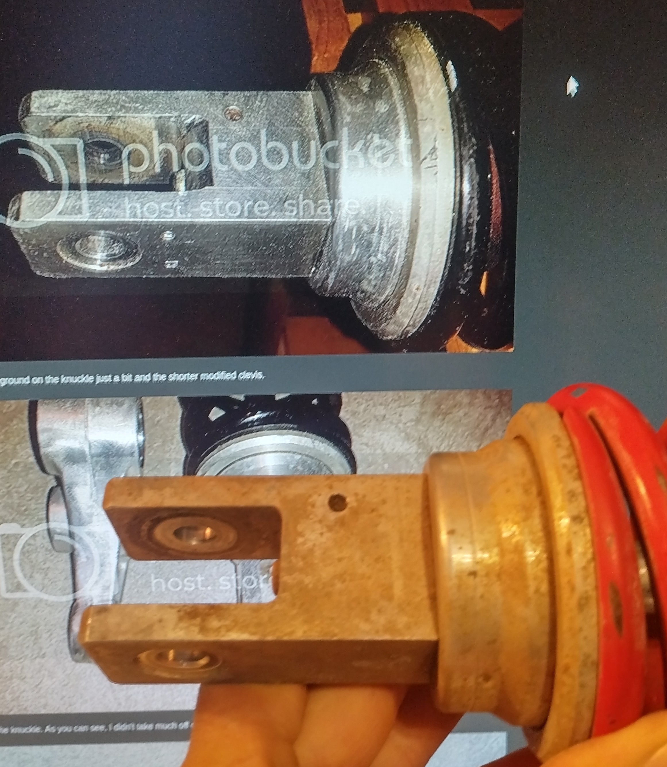

Okay so those dimensions are exactly the same as the stock RM125 '01-'06 clevis... Except I believe you meant to type 22mm where you typed 21mm for the inside width. My '03 RM125 is 22.0mm, KDX '95-'06 is actually 22.5mm, so unless you ground down the rocker linkage / knuckle's inner bushing by 1.5mm (0.75mm per side), you must mean 22mm? Still, the KDX measures 22.5mm, a slight interference fit without filing/grinding 0.25mm off each side...?
What I determined more importantly when comparing all sorts of photos from eBay parts is that Don@ZR1 appears to have used the DRZ400 lower spring perch / seat, as it is about 5mm or even 7mm shorter height than the RM125's. The clevis looks identical to the RM125 unless the DRZ400 is in fact 21mm inside width but otherwise exactly identical.
Here's your final setup on the Full Showa thread, inner part of clevis beveled on a 45 degree angle to clear the KDX linkage rocker, also showing this spring seat is shorter than the stock RM 125, which appears to be identical to the DRZ lower spring seat perch:
That way Don@ZR1 could lower it for you internally without losing the softer end of spring preload adjustment range, or else needing a shorter length spring. That's the best I can figure out. I was going to post this on your original thread but you beat me to it.
Here's my '03 RM125 lower spring seat/perch collar vs an eBay DRZ400's (both nearly identical Showa 50mm piggybacks but DRZ reservoir is flipped):
@ SS109 - can you measure your lower spring seat height? It definitely looks exactly the same as the DRZ400. The RM 125 spring seat here measures 21mm as pictured:
I'm tempted to use a piece of 1/2" 6061 T6 aluminum plate and set it up on the lathe and cut my own custom lower spring seat that is 3/4" shorter, have the shock lowered internally 1/4" (I'd really want to make sure I had enough shock travel, need to figure out the stock leverage ratio for the KDX linkage), & swap out the stock 112.5 mm suspension linkage dog bones for something slightly longer (117mm stock KLX250 links) to both fit the longer motocross shock better without the rocker linkage topping out on the frame crossmember, as well as to both keep the suspension height reasonable but still about 5/8" (or 7/8" max) taller than stock for log/boulder clearance, and additionally to soften the MX compression valving, but not knowing what effect this would have on the rebound damping. I might be best off only running 1" or 1.125" lowering links at 117mm or 118mm to keep the valving closer to stock KDX (who knows what the RM125's leverage ratio actually is as well), and just run more race sag to keep the rear ride height where it needs to be to match the front end 98 RM125 forks slid up slightly in the triples,

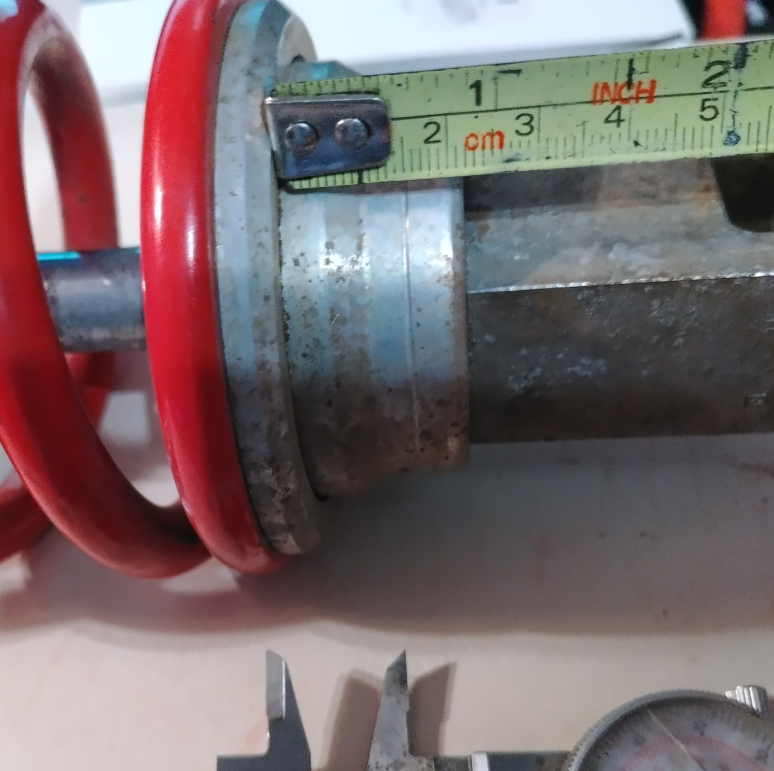

I measured the collar like you asked. As close as I can get it it looks to be 14.25mm.
BTW, Donnie did not lower the shock internally at all. Every thing was external so it had to be with the spring mount/collar and/or clevis. He did not mention using a shorter shaft at all.
Did you compare the length of the RM125 shock vs the stock KDX shock after Donnie was done?
I believe I read you stating it was a 1/4" longer approximately? Stock 01-06 RM125 shock is almost exactly 1" longer vs stock 95+ KDX.
The clevis you have is the same length as the stock RM clevis.
Your approximate spring seat collar perch cup whatever measurement is 6.75mm shorter than the stock '01+ RM125 part. But that doesn't affect the fully extended height of the shock at all, only spring preload adjustment.
So if the shock body itself is still stock dimensions and not somehow shaved down shorter & rethreaded (HIGHLY UNLIKELY!), then either the shaft must be shorter or the shock has an internal lowering spacer in it.
That makes me think that perhaps Donnie used the entire shaft and clevis assembly off of the DRZ400 shock. Perhaps it was a DRZ400SM (supermoto?) and it was a shorter ride height than the off-road model? I can't remember if the E or the S was the street legal model versus off-road model. Perhaps they are likely all the same height but different valving and spring rates.

So, the 01-03 RM250 has KYB shocks and forks in this era, but they look like they may stand a chance of fitting into a KDX in a similar fashion. And the clevis is already beveled on a 45° angle like you did SS109!
Length is uncertain, but like the 2001-2006 RM125 Showas, these also have two compression damping adjustment circuit clickers externally for high-speed and low-speed.
EDIT- 04-07 RM250 uses a 50mm Showa like the 01-06 125
2nd EDIT - 04-07 Showa 50mm RM250 piggyback shock has a noticeably longer clevis, so that would not work out well there's enough material that you could chop the bottom off and drill a new mounting bolt hole.
For a purple spring though, it looks like the Showa 98 RM250 spring and seat on an 01-06 RM125 Showa shock is the ticket!
