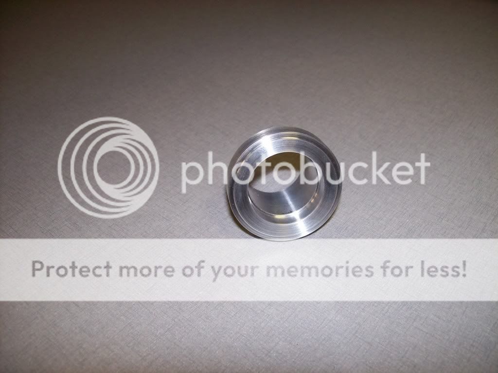

2006 KX450F KYB fork (48 mm) to my 2005 KDX 220
Thanks to all the people who's helped make this project a reality!
Here's a better drawing of the perfect spacer to fit my 2006 KX450F top crown to my 2005 KDX stem. I'm sure RB does a great job of this, but I've got too much mechanical engineering and a machine shop at my disposal to not do this myself.
No knurling required, although I am making a 30.1 mm ID X 38 mm OD x 1.9 mm thick washer to fit between the lower bearing and the bottom crown. The KDX stem has 1.8 mm of material that has not been ground that sticks out from the lower KX crown and will slightly lengthen the KDX stem fit into the headtube. Not sure if I need it, but my machinist works for cheap.

This turned out to be a bad idea. No washer/spacer needed, and now I have to get my brand new lower bearing off to remove the washer.heckler wrote: No knurling required, although I am making a 30.1 mm ID X 38 mm OD x 1.9 mm thick washer to fit between the lower bearing and the bottom crown. The KDX stem has 1.8 mm of material that has not been ground that sticks out from the lower KX crown and will slightly lengthen the KDX stem fit into the headtube. Not sure if I need it, but my machinist works for cheap.
- Mr. Wibbens
- Posts: 4884
- Joined: 02:57 am Nov 07 2004
- Location: Playing in the Poison Oak
bummer
go find someone with a press
