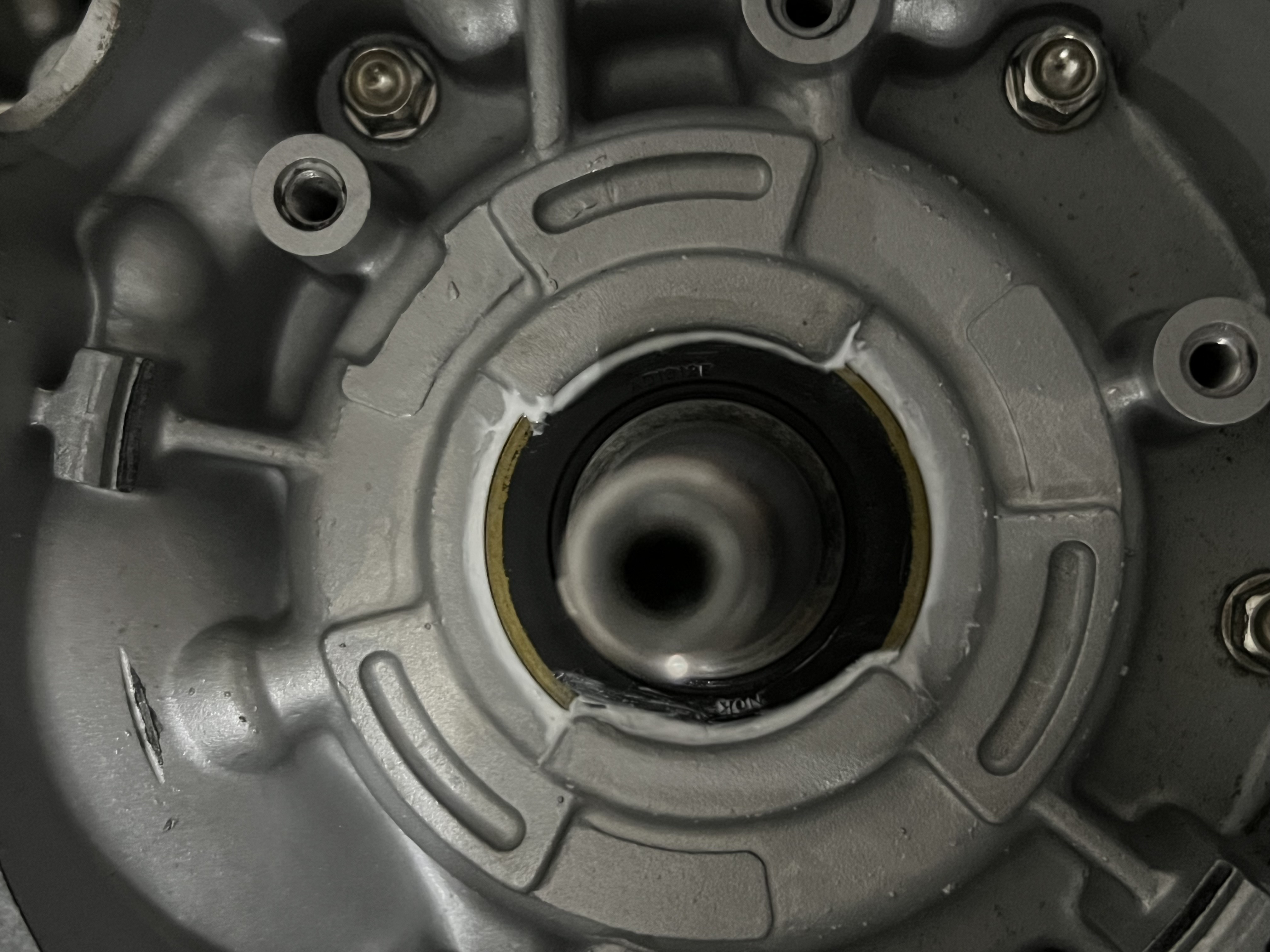

I watched a video on a loctite representative discussing the loctite 290, and he mentioned there was a lot of customers that used it for casting porosity. I immediately thought about the steel bearing retainer indents on the exterior of the case halves and thought this might be a really good alternative choice versus the typical JB weld.
JZ05220r
- Posts: 669
- Has thanked: 7 times
- Been thanked: 21 times
Re: Sudden rough running
Well, as you can tell from the picture I ended up going with the threebond 1211. I’m pretty confident this will hold up. Going to do a final leak down test in a few days, order a jet block gasket and throw the engine back together.

I’m not very proud of doing this, but at the same time I think it’s cost effective.
- SpruceItUp
- Posts: 244
- Has thanked: 142 times
- Been thanked: 64 times
If it works, it works! At the very minimum it will tell you if it was why you couldn't get your bike running properly so long as it holds. At best, it holds until you decide to replace the seal!
