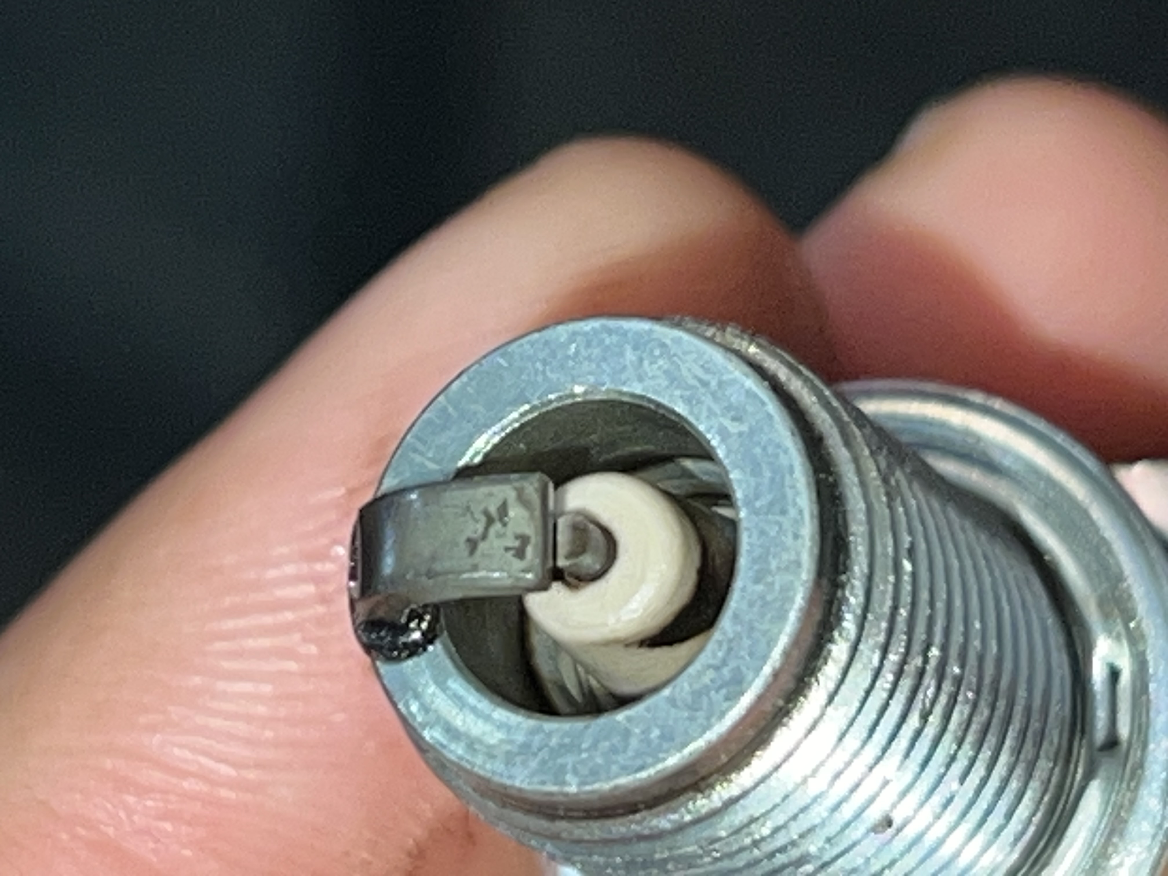

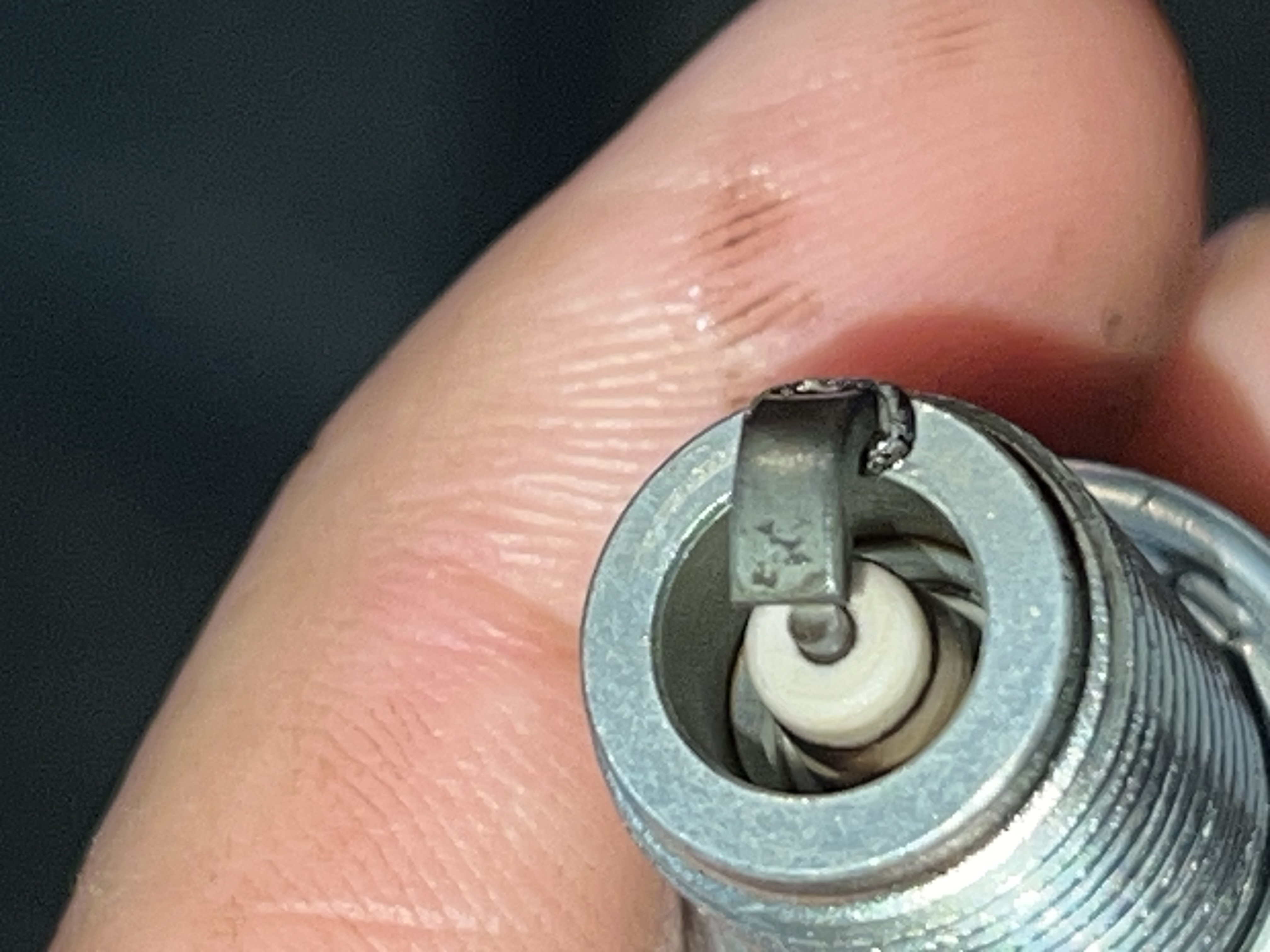

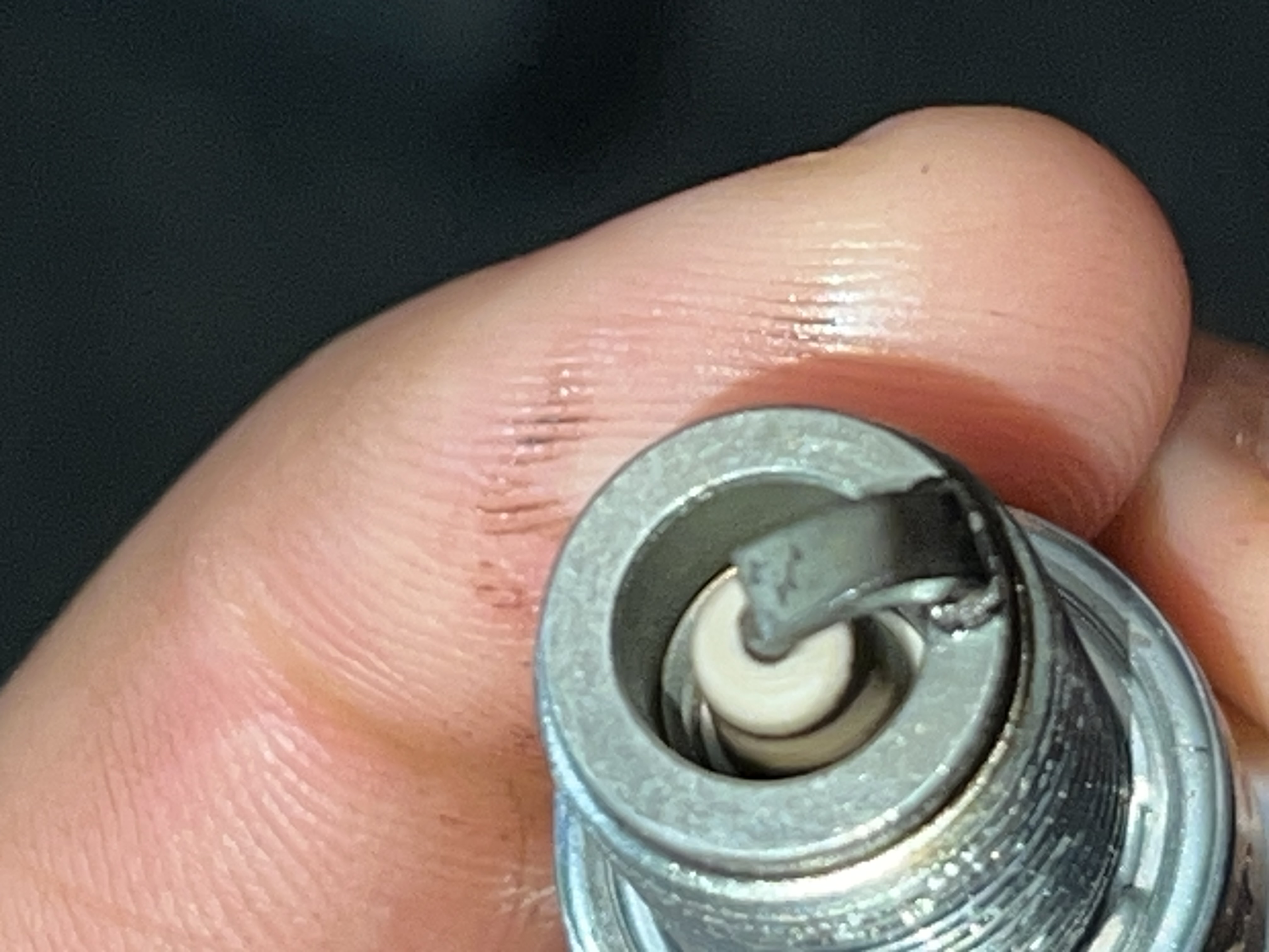

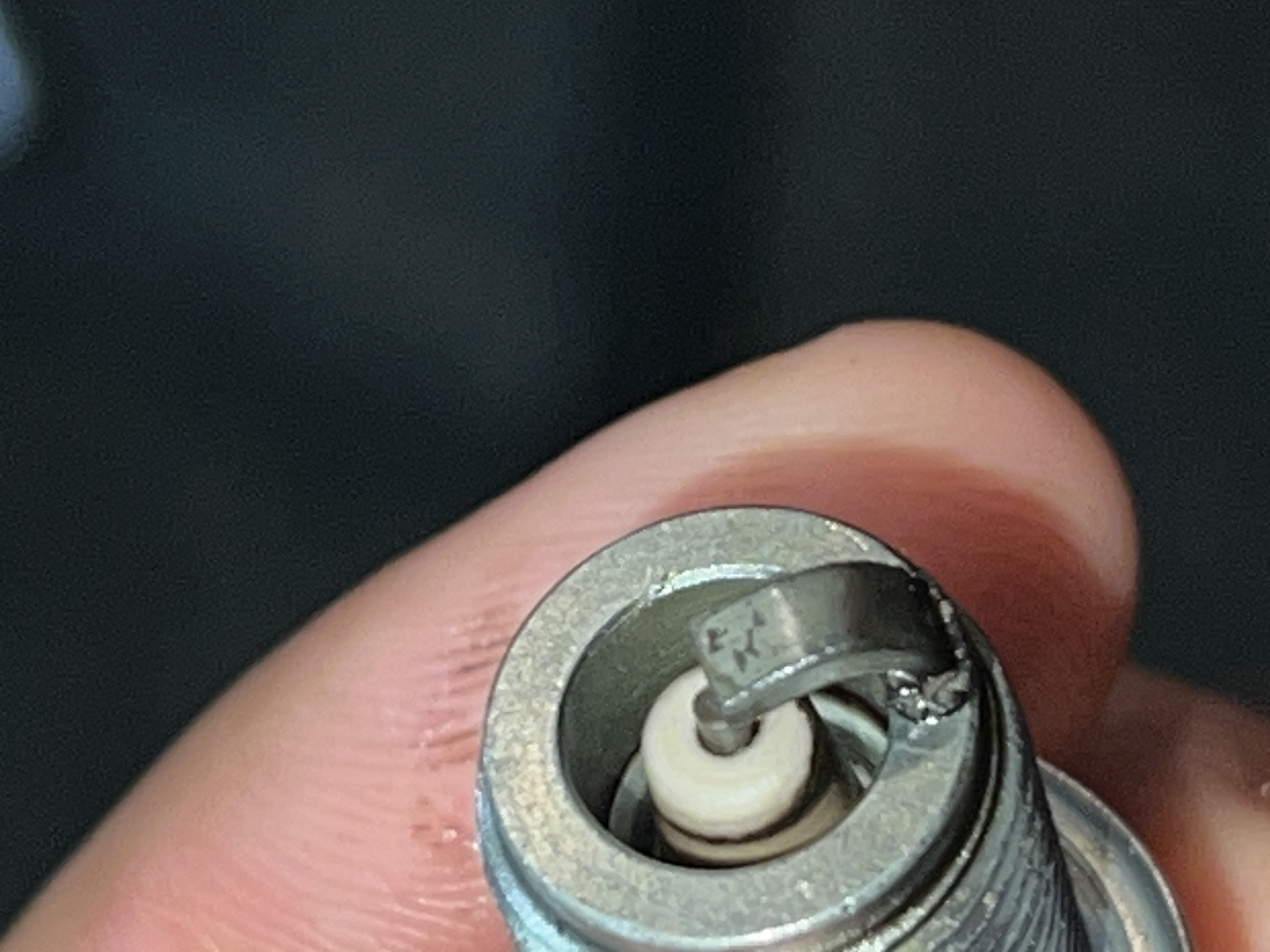

Here’s one of the plugs on my shelf. It looks lean. I believe this one was the one I pulled right after a stroll around a 6 acre field with the choke on by accident. Something I don’t do often

- SpruceItUp
- Posts: 241
- Has thanked: 137 times
- Been thanked: 62 times
Re: Sudden rough running
What jetting were you running with that plug, is it from when you really leaned out the jetting? How long has it been in the bike as well. If it has been in the bike for a while I'd say that's dangerously lean. Especially if that is from running with the choke on.
You can't really say exactly without a plug chop, but with how white that porcelain is I'd say so unless it's a new plug with only a couple of runs on it. I like to have a chocolate brown color on my plug (if I'm just looking at it from long term use, not plug chops).

JZ05220r
- Posts: 644
- Has thanked: 3 times
- Been thanked: 15 times
I agree it’s reading lean. There are absolutely no lean symptoms when running. Never any big from low rpms even if I stab the throttle. When the engine was fresh I purposefully started where it sputtered and went to a 148 and it stopped sputtering. I ran the 148 for the longest time. It was only until this year I realized that I can go down one more size to the current 145 to clean up some mid range jetting as I was on the 2nd clip position on the needle and needed a small reduction at 1/4 to 1/2 throttle.
