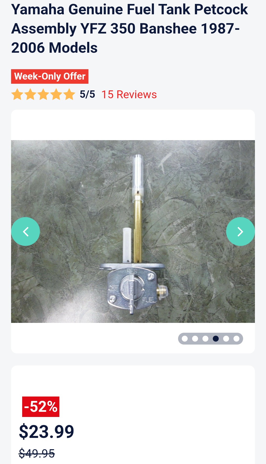

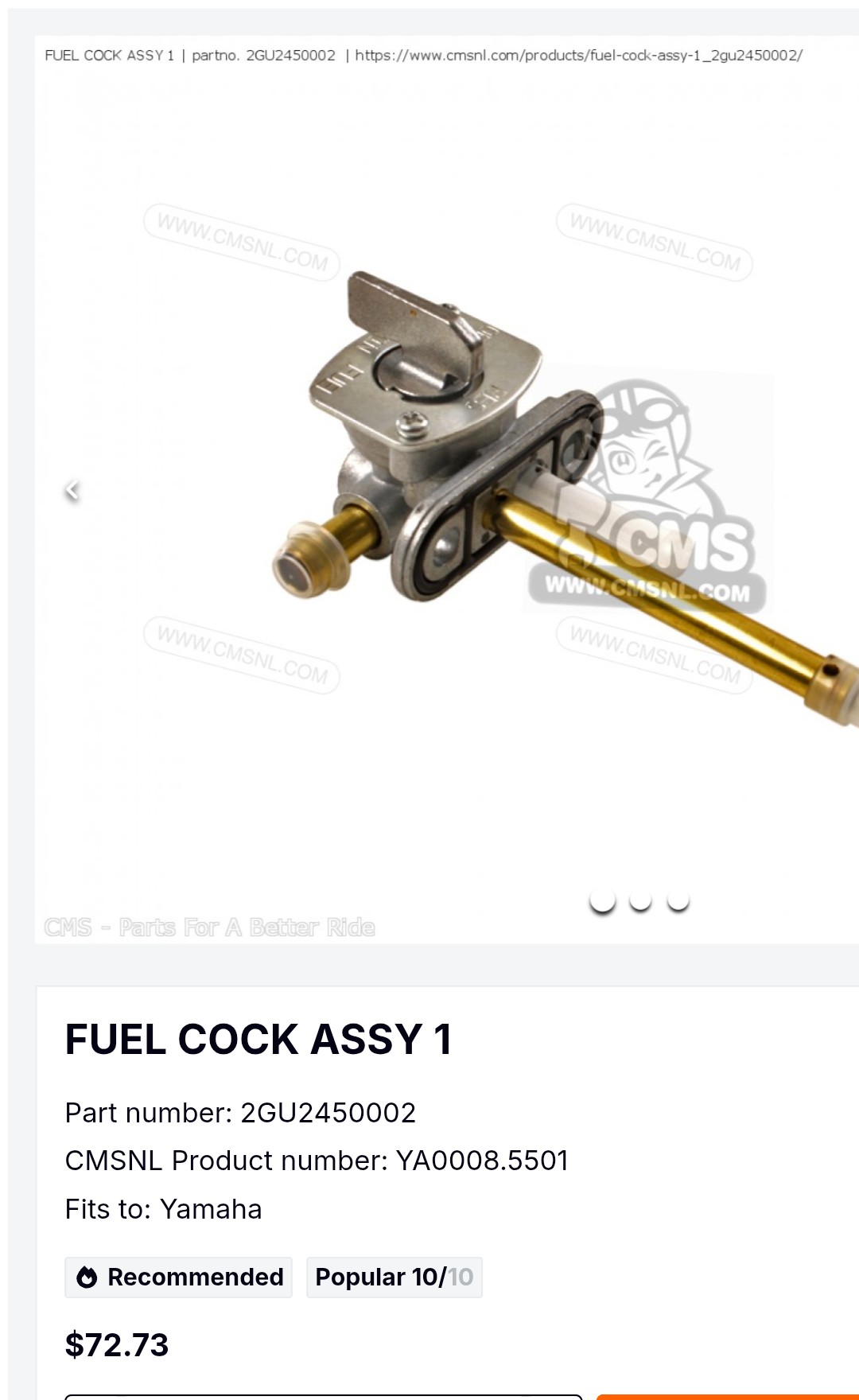

Here's the 2005 WR250F version, if the 2004 version is slightly taller, which I can't really determine from the angle of that photo, the 2005 version looks to be hugging tight up to the tank, although it's not 52 or $55, it's $71....
Double check to make sure it uses the same gasket to the tank, as that will verify that bolt spacing.
Perhaps trying to find some photographs of actual versions of the 2004 petcock, sold on eBay using seller photos instead of stock default photos, might be a good way to tell if the 2004 version is also tight to the tank like this. It could be that the only difference is the reserve pick up tube height.
EDIT - the 2004 WR version part number is also used on the Banshee through 2006, here's a different photo angle, I also saw a used one on eBay that verified it also sits tight to the tank, so if the side outlet is needed, this one is probably the trick then.

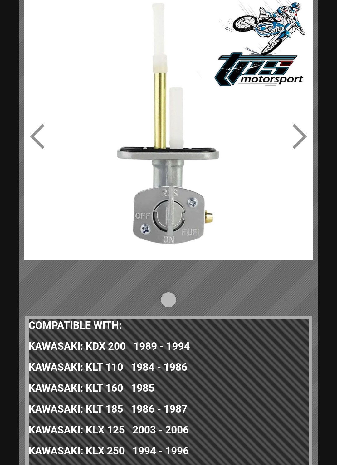

And here's the best photo I could find of the no longer available 1989-1994 KDX200E petcock, granted this is aftermarket, it looks the same as the used ones on eBay that I see that are either missing the fuel nipple that has a habit of falling out (on my H-Series petcicks also !!), or else sitting at a downward 45° facing angle:
So I think that the WR250F 2004 petcock would likely be the best one, maybe we can get you to get one of those on your bike as a test fitter to see if that added clearance keeps the fuel line up high enough above the choke knob?
I can ship one to you if that '16-'22 YZ250X downward facing outlet doesn't work, if you want to ship me the X version once determined.
Sorry to chime in later after the fact of you ordering the 250X petcock, but that one may work out also.
The 2004 WR250F petcock appears to be the best to use both for the E-Series as well as KX125/KDX hybrids, where the 2016 YZ250X seems to be the best to use for the KDX200H/220 tanks.]
