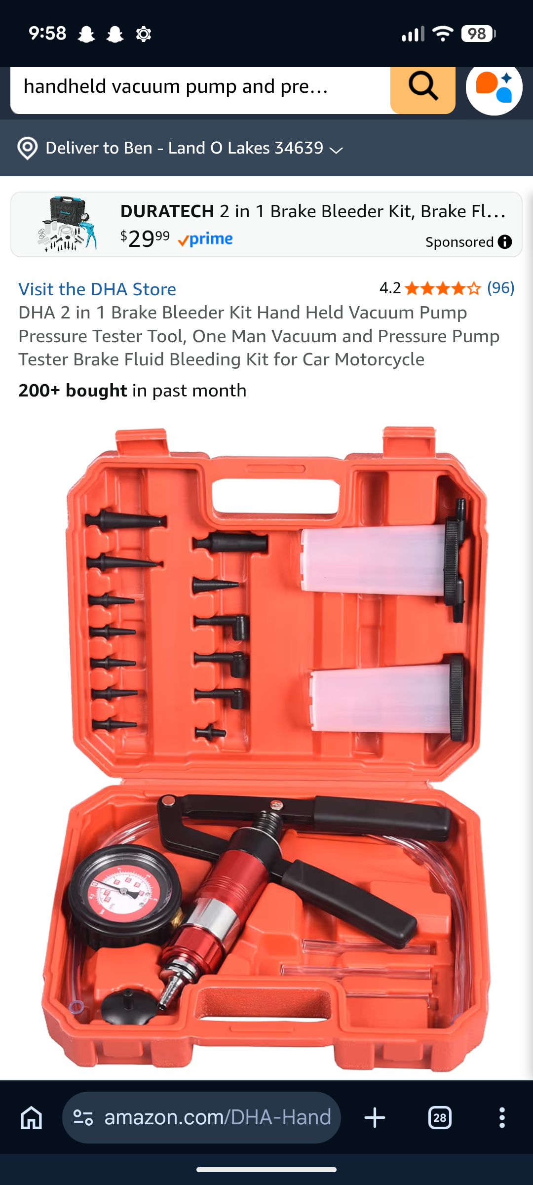

A vacuum test just pulls a vacuum in the engine instead of applying pressure to it. Some seals only spring a leak one way with pressure or vacuum, so only doing one test can be inconclusive. Since the engine has periods of vacuum and pressure in the crankcase while it's running, it's best to test them both.
Now, you don't actually need an expensive setup to do this, I made one from a handheld vacuum and pressure pump for bleeding brakes.
Something like this:
(My amazon link is not working, at least not for me, so I attached a photo)
And then I used an adapter from my compression tester to connect the hose to the spark plug hole. If your adapter has one, remove the schrader valve stem.
When you have that together, make sure you put the piston at bottom dead center so the pressure and vacuum can get past the piston and enter the rest of the case, and plug the exhaust and intake. Also, I've read you don't want to pull more than 7 inHg (vacuum) on the cases. I've pulled more in the past, but I stick to 7 now. And no more than 5 psi of pressure.
I ended up making this specifically for the KDX as removing the airbox on it, or at least the E series, takes more work than I'd like if I'm just testing. I had made a another that goes in the intake for my 125 that works just fine as well.

SpruceItUp wrote: 08:57 am May 06 2026 A vacuum test just pulls a vacuum in the engine instead of applying pressure to it. Some seals only spring a leak one way with pressure or vacuum, so only doing one test can be inconclusive. Since the engine has periods of vacuum and pressure in the crankcase while it's running, it's best to test them both.
Thankyou! I will get that vacuum pump on the way and see what we are looking like. I did a leak down and compression test(135psi)when I first got it and it passed but I'm wondering if it is more likely to leak the other way like your saying. The bike sat for a long time after being rode hard. Got to a spot were it was running good and now this 👎 thought it was a little too good to be true just tossing it together and getting the jetting set up right haha
Hopefully have some numbers this weekend on the tests. Thanks for the help.
