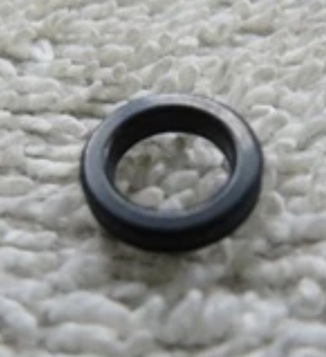

While the dimensions were on here as measured on at least 3 different NOS and used KIPS packing seals, as measured by at least 2 different forum members, I've had the part # on my eBay saved search alerts for ages now, & one just popped up NOS in OEM packaging from a dealer in Canada, & I decided to jump on it in order to get my hands on an unused one for my own references.
I have several of the silicone o-ring substitutions to use, which were graciously sent to me by no less than TWO different generous forum members participating in this thread, as they typically are so low priced that you must order a minimum quantity of them for the sellers to make any profit. Thanks Jamie & Billie! This NOS packing seal that I should have from Canada soon may just remain a reference piece.

where he said he ordered two of these on an OEM parts order through his local Kawasaki dealership, but instead, received 2 separate smaller X-rings per each single KIPS packing seal ordered...???!!!
REALLY? So Kawasaki may have briefly been substituting two off-the-shelf X-rings to replace one single packing seal...??? This is perhaps the biggest news on this whole 6 or 8 page thread on this part number in my view at least... Now, if we only could have gotten dimensions off of Kawasaki's substitution part before they just simply listed them as NLA?!
Perhaps there was some sort of service bulletin on this that would still be able to be be looked up in Kawasaki databases???
canyncarvr wrote: 04:12 pm Jan 18 2007 ...I just ordered the OEM stuff.
What I just got? O-rings! NOT what the bike came with! They are special O-rings, though. They look like X-rings on a chain..but the 'relief' or cut is on the outer diameter as opposed to a lateral diameter.
