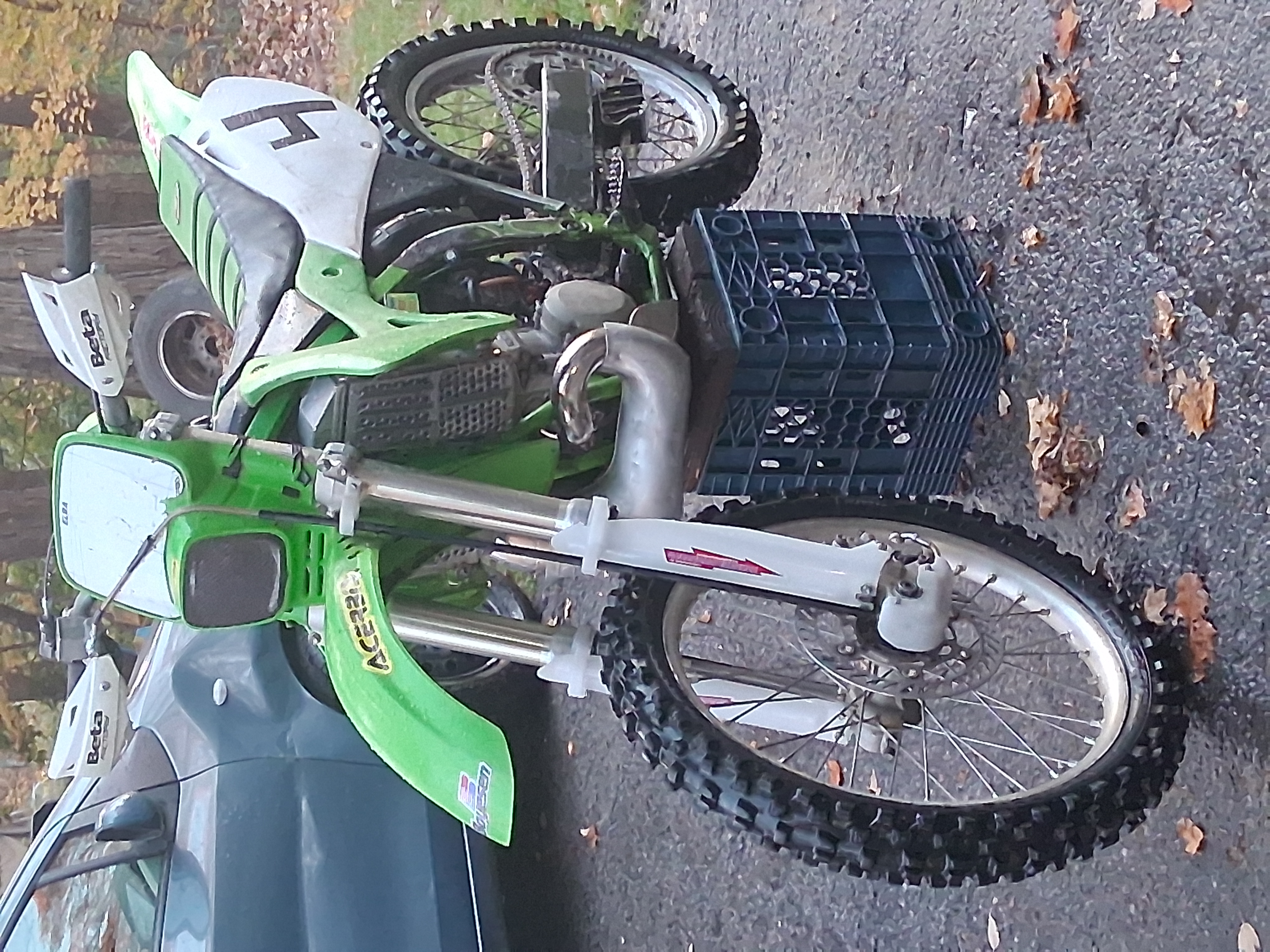

So I recently did a top end on my e series. I milled the head a little with Emory cloth and a glass plate. Unfortunately I used ebay gaskets and the head gasket isn't a multi layer gasket. I noticed my bike lost its top end today after running great for several tanks of gas. I took the head off and both powervalves were broken. I think it was due to the 1 layer ebay head gasket and the milled head. Where the powervalves go through the holes on head gasket the head has some large releifs. I think I should have taken away some material from the head reliefs to keep the head from pressing on the top of the powervalves. I think that may be why they break so often. They were very we'll lubed and didnt have a spe of carbon. There's a company in Czech @kxpowervalves on facebook that sells aluminum sets I had ordered and should be here this week along with a oem multilayer head gasket. I just wonder if I should go with the steel powervalves as there less likely to break unless these are higher quality aluminum. Im going to keep a spare cylinder so might as well have two sets of valves considering their reputation. Any thoughts.

Post by Kx200x »
