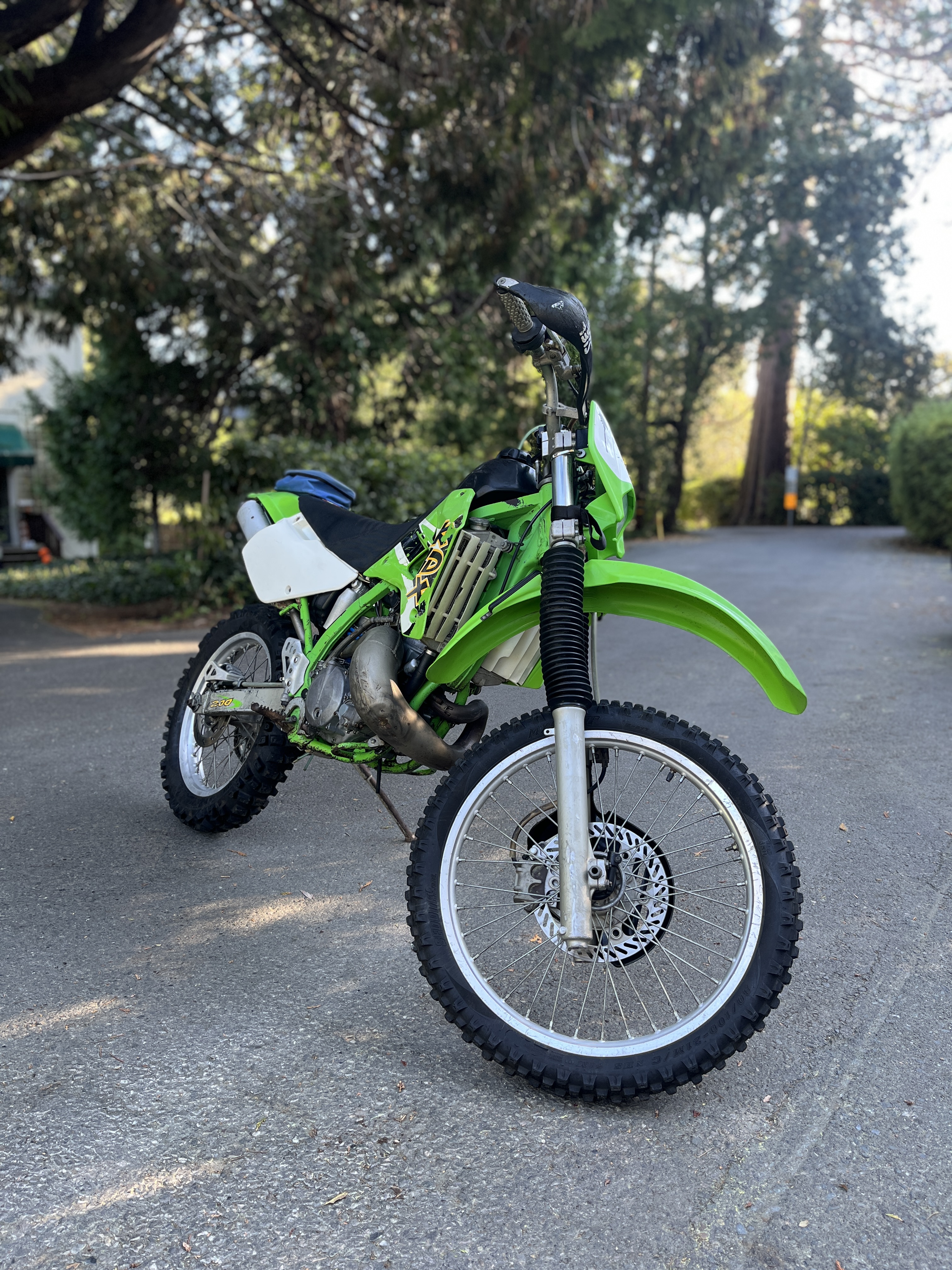

Stoked to be here. Recently purchased a 2001 KDX 200. Unknown hours, but likely a bunch given how worn the frame is around the pegs.
Cylinder was sleeved some time ago and compression readings are good (150 average) and I'm starting to tear into it for everything it needs...
In order:
  • suspension: rear shock leaking and bumper gone, sent to House of Horsepower
  • Tires are 10 years old, replacing with 524/525 Shinkos and fresh HD tubes
  • Greased all the linkage bearings, they only had surface ruse no pitting wooo
  • Greased the swingarm pivot bolt and bearings
  • Cleaning/Rebuilding the carb and Proper Jetting
  • Dump and fill oil for front forks just to check them
  • ... and probably more fun things along the way

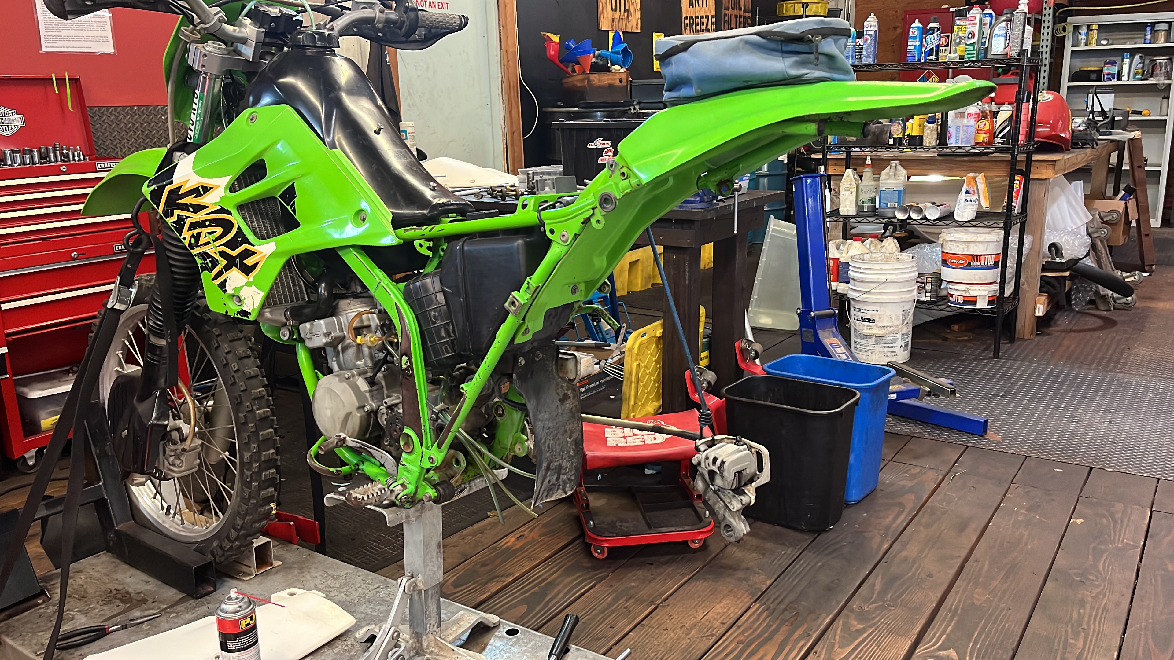

Build (fix?) is slowly progressing, carb has been given a baseline jetting and did some odds and ends like replacing the severly frayed throttle cable. Rear tire replaced. Yamaha Petcock installed for a better fuel line routing.
Anxiously waiting for the delivery of my rear shock. Then, it's more small things like chain replacement, pad replacement and front tire replacement... then maybe we'll be able to ride this thing.
