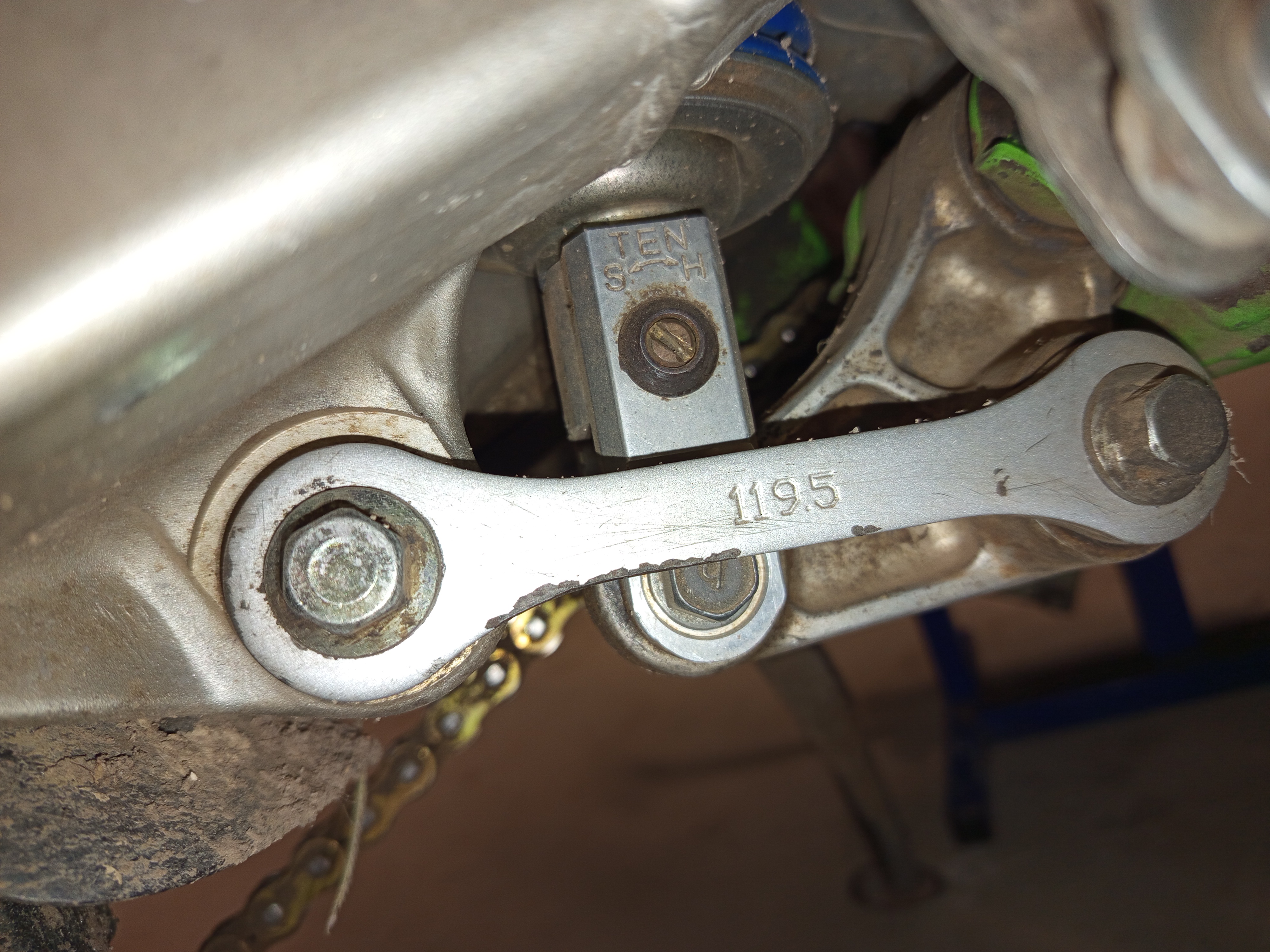

kdxdazz
Posts: 621
Joined: 07:51 am Dec 28 2017
Country: thailand
Location: Thailand
Been thanked: 41 times
Re: Lowering Link KDX200 H series
Post by kdxdazz »
Chuck78 wrote: 10:07 pm May 20 2025 A quick tip - use KLX250/300 links + their matching bolts. They are 117mm length, but slightly thicker steel, or some used significantly thicker aluminum links. The length of the bolts must be matched to the thickness of the links, and the steel KLX are a bit thicker than the '95-'06 KDX's, & the aluminum KLX300 are even thicker.
Also, with the stock shock, the tire may aldo potentially bottom out on the fender if using 117mm or longer links. I have not trsted this, but with a slightly longer RM125 or DRZ400 shock, & 117mm KLX links, my swingarm was able to press the chain tightly against the upper chain roller before any fender to tire bottoming... So if you do this,be mindful of that potential, and don't try to run 120 rear tires, stick with stock as it'll also keep the ride height lower.
I'm using klx250 lowering links on my kdx200, as you say they are thicker and also need the klx bolts, I'm pretty sure they are stamped 119mm but I will check again
Shorter rear shock from the kdx220sr is the best option but impossible to find
kdxdazz
Posts: 621
Country: thailand
Location: Thailand
Post by kdxdazz »
Australian model klx250 links, think from memory they give a 45mm reduction in height measured from the rear axle straight up
