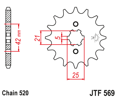

- Posts: 1175
Re: Front sprocket issues
KDX/KX/YZ/Banshee/etc sprocket:
https://www.jtsprockets.com/catalogue/part/JTF569/
(As thin as the chain inner link bushings)

- Posts: 1175
STOCK KDX etc:
KDX/KX/YZ/Banshee/etc sprocket JT569:
(pro tip, RaceTech Titanium makes these in lightweight anodized titanium advertised for the Yamaha Banshee quads!)
FITMENT as follows.

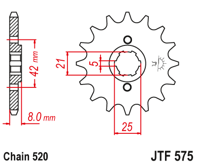

- Posts: 1175
Here's an extended spline version off of a few older Yamaha models, 8.0mm width splined portion:
https://www.jtsprockets.com/catalogue/part/JTF575/
It lists "Available sizes:13, 14, 15, 16" but only shows application listings for 14T and up. The full part number for a 13T JTF575 would be JTF575-13

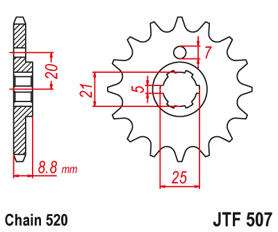

- Posts: 1175
...AND... the widest spline sprocket fitment of interest, the early KX/KDX!
JTF507 (Steel Front Sprocket)
Available sizes:13, 14, 15 (JTF507-13, etc)
8.8mm spline width!
