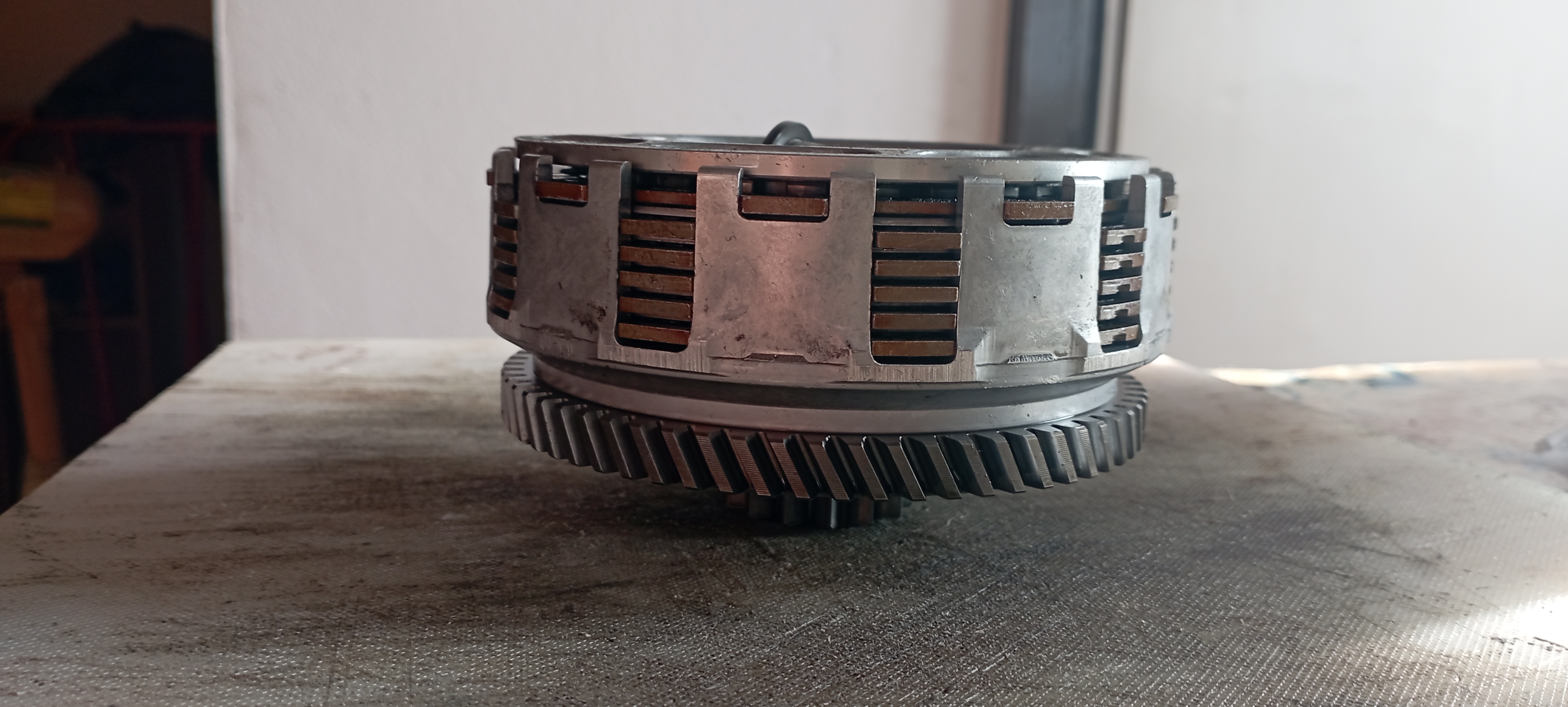

Re: Clutch rattle
My nsr150.clutch with helical gear, over 30,000klm and near zero notches on the basket

Kdxdazz I appreciate all the effort to quieten these bikes down, I did your KIPS mod the following teardown and no more rattle, but I have been wearing ear plugs for the past 20 years due others in the group on 4-strokes so they drown out the KDX big time.
Did the modifications you did in this clutch rattle video help at all? The helical cut gears are certainly quieter and have greater contact area, I think on average the contact area on a helical cut gear is 1.5 tooth vs 1 on a straight cut gear. The straight cut transmission gears use in autos use to put out a real good whine. The helical cut gear could possibly also give a little bit of axle(side) load on the basket maybe tightening up the clearance(slop) a bit also, making it quieter??
I notice on my bike when in neutral and you pull the clutch lever the tone does change, just curious do you run a full liter/quart of tranny oil, I think Jeff Fredette use to recommend running a full liter/quart as it would quiet the clutch some, I have been running a full liter of the same oil in the KDXs since 1990, it is basically a sump/splash system so the full bottle does not hurt.
Curious if maybe a straight 30 or 40 weight motor oil might make a difference, might give that a try one day.

JimmyB wrote: 01:27 pm Oct 22 2024 viewtopic.php?f=77&t=26264&p=227328&hil ... le#p227328
[/quote
Thankyou
I use 10w-30 motor oil now, was using ATF but feel it is a bit too thin at 7w
The kdx clutch is just not a great design in terms of how it is mounted to the input shaft, it has a bronze bush which wears out, Honda uses solid steel bushes, interestingly the nsr150 clutch plates fit the kdx.
I have no idea on the advantages or disadvantages of helical gears but I'm inclined to think they are better if Honda uses them. If straight cut gears were causing noise and backlash then I think the clutch wouldn't go quiet when pulling in the clutch
When I get chance I will analyse the kdx clutch and nsr clutch side by side and see what can be learnt,
as I'm getting older I really don't like noisy bikes, yesterday I was out on my other kdx with the stock expansion chamber and it's a pleasure to ride compared to the noisy pro circuit expansion chamber, I live in the middle of a city so not looking like a noisy idiot is important to me
Changing out the clutch plates is probably the easiest option in partially quiet down the clutch
Adding extra oil may slightly reduce noise but it's really just a band aid, I know Americans like to follow Jeff fredette but I personally haven't seen one ounce of information put out by him addressing kdx design flaws and how to fix them
I like to wear ear plugs too, in the video I forgot to wear ear plugs while testing and now my tinnitus is back
