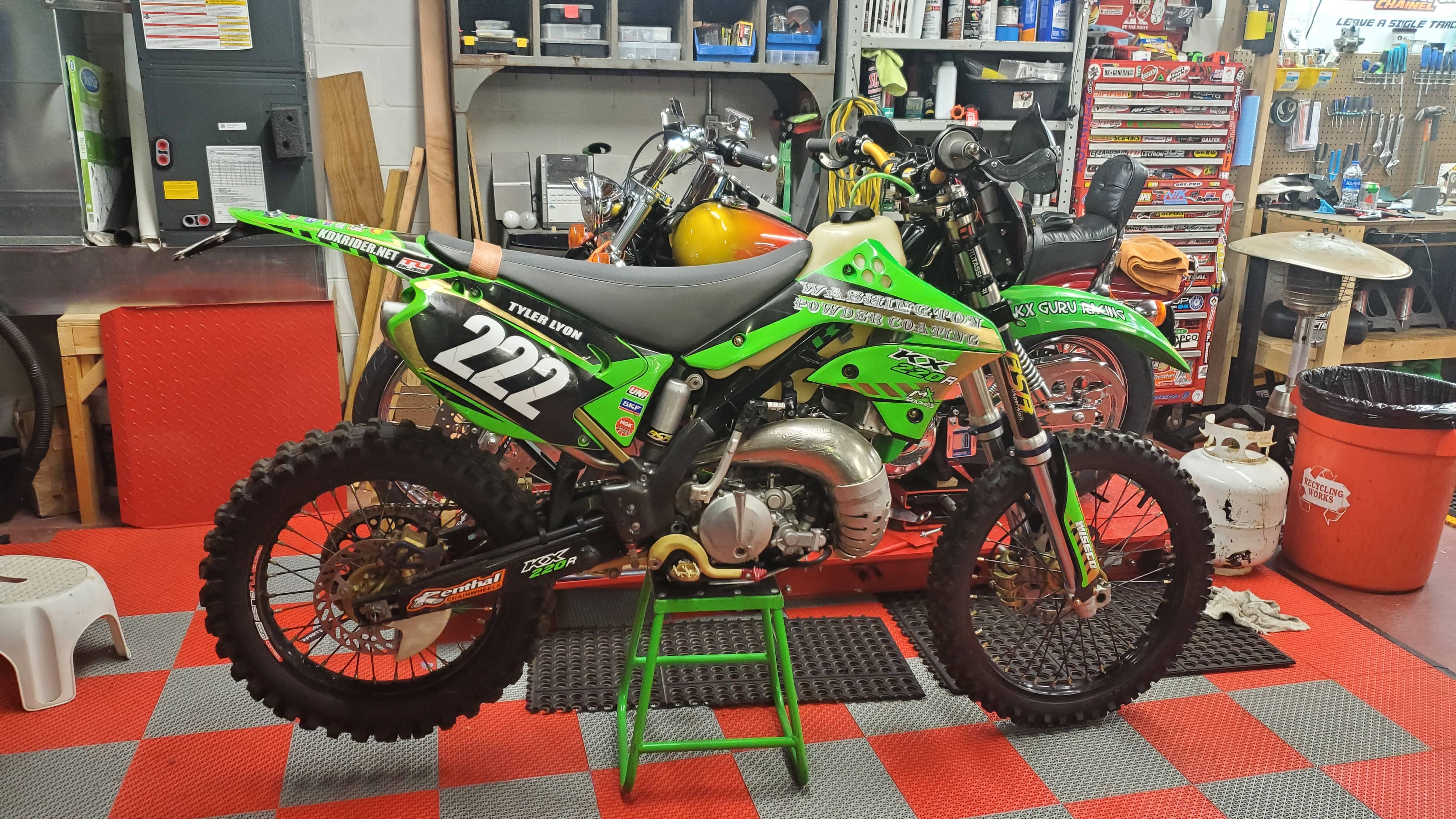

Like Tyler said, check out the hybrid section of the forum. Lots of really nice ones have been done. I have about 10 years on mine now and love it just as much as I did in the beginning.
