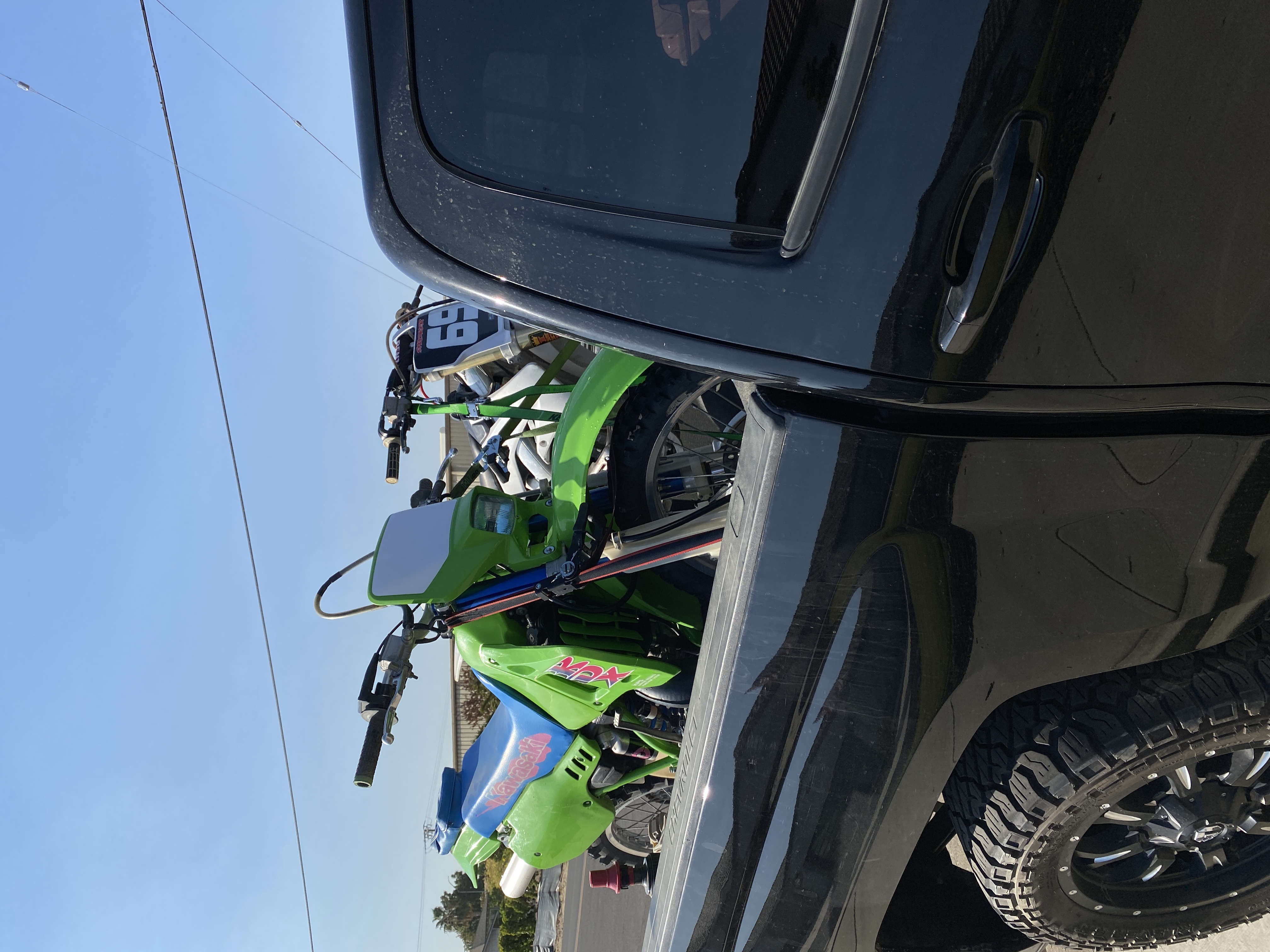

Hey guys!! Here is my 93 KDX 200 E with the inverted forks. The forks currently have a 30kg spring in the front(stock). They are way to soft and sketch for the things I’m doing with the bike. Im wondering who still sells .37 or .38 kg springs (would go well since I’m 145lb) for this year of bike? I’ve called Racetech and the softest thing they said they have is a 42kg spring! Please let me know if I place where I can still find one, becuase the bike is amazing but the front forks are sketch! If you guys also have those weight springs I mentioned I will be willing to buy them from you, just let me know!

Call Jeff Fredette at FRP Offroad or Cannon Racecraft for custom springs.

It is a great looking E bike. I like it a lot. Those forks will work pretty well with proper springs. I have a set I refuse to get rid of and might swap back on. They are so much better on the tight technical trails than the mx forks are. At least that is my opinion.

Man! Those look great.
What years had the inverted forks?
I was riding Zuk last weekend but bemoaning that I need my green machine back in action and telling him about my goodies.
He asked me if I had KX forks or the cool blue KDX ones. Some KTM guys still know their KDXs better than I do.
Posts: 14741
Has thanked: 181 times
Been thanked: 46 times
Re: 93-94 KDX 200 Forks
1991 - 1994 KDX250 and 1993 - 1994 KDX200
