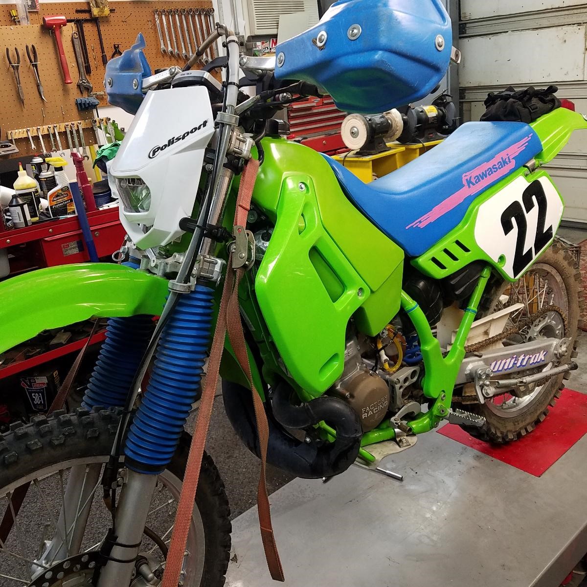

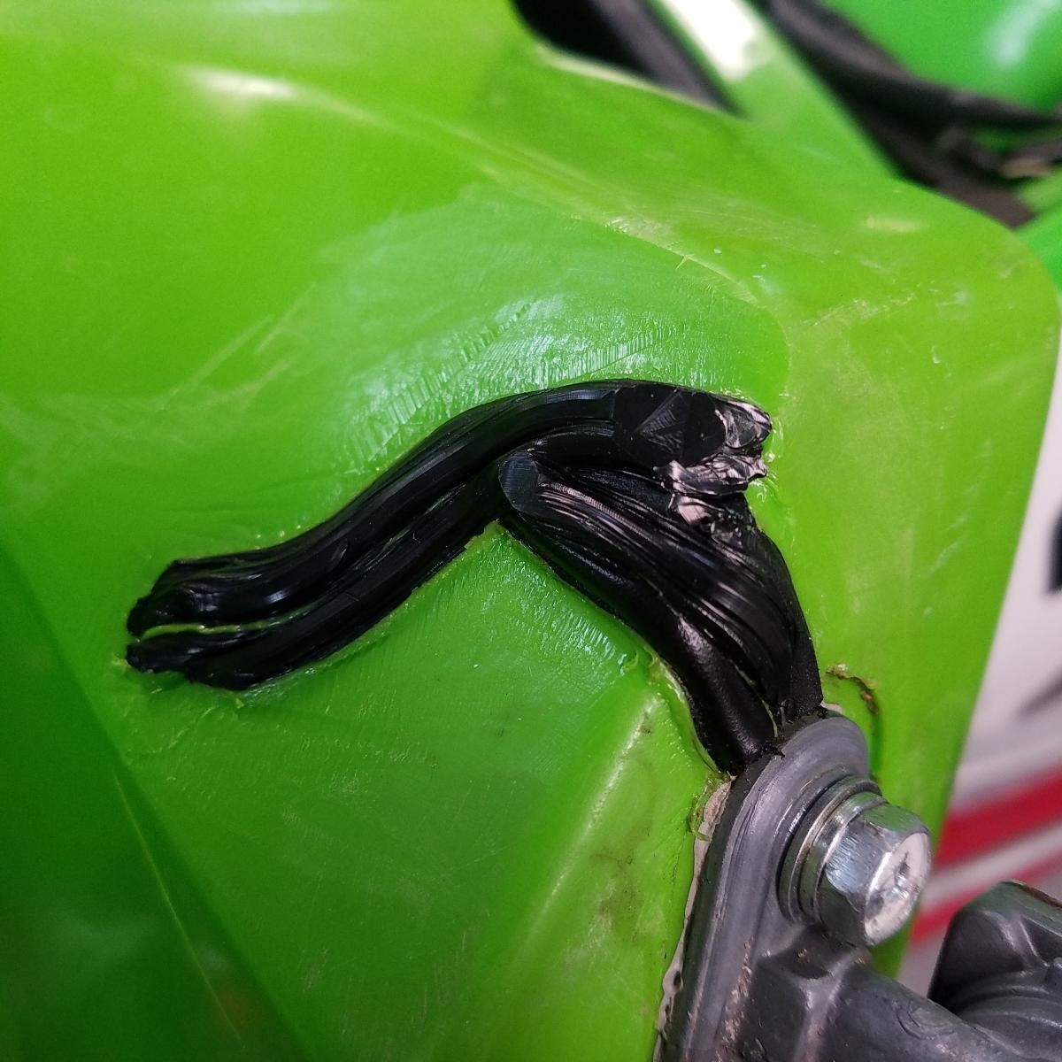

Took my cracked tank to "Phil's Plastics" in Phoenix. The guy who does their plastic welding is brilliant. I told him I didn't care what the repair looked like but wanted it to be reliable above all. I'm pretty sure the tank will crack again later on. I'll be removing the tank while the bike is in storage shed during the hot months here (140 degrees in shed) in hopes that might help. In the mean time, I'll keep contacting Clarke. Hope you do too.

Toonces, those repairs look heavy duty!
What did that cost?

Repair was $80. I told the plastic welder guy that I didn't care about cosmetics and durability was top priority.
I went riding yesterday and another small lead started. I'm going to keep bugging Clarke till they make a tank. I don't think they have any idea about how many people could use a new tank and that they would be the only supplier in the world for this particular tank.
