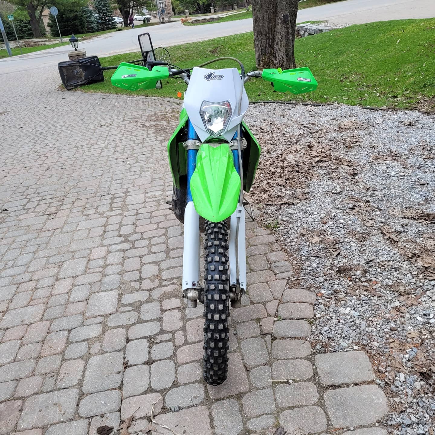

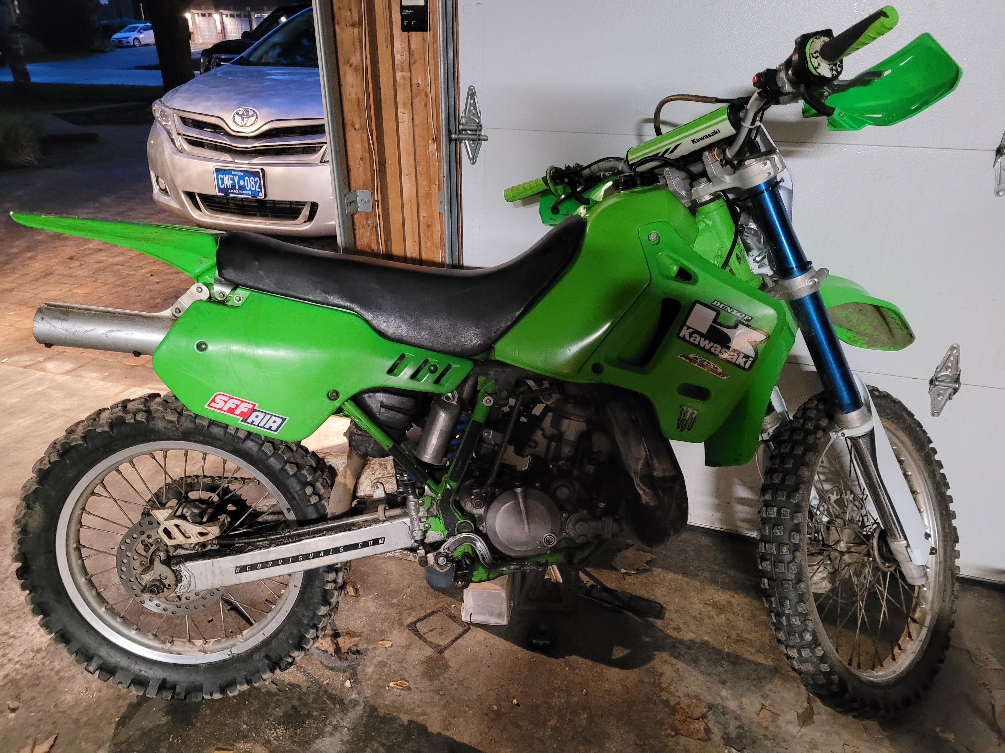

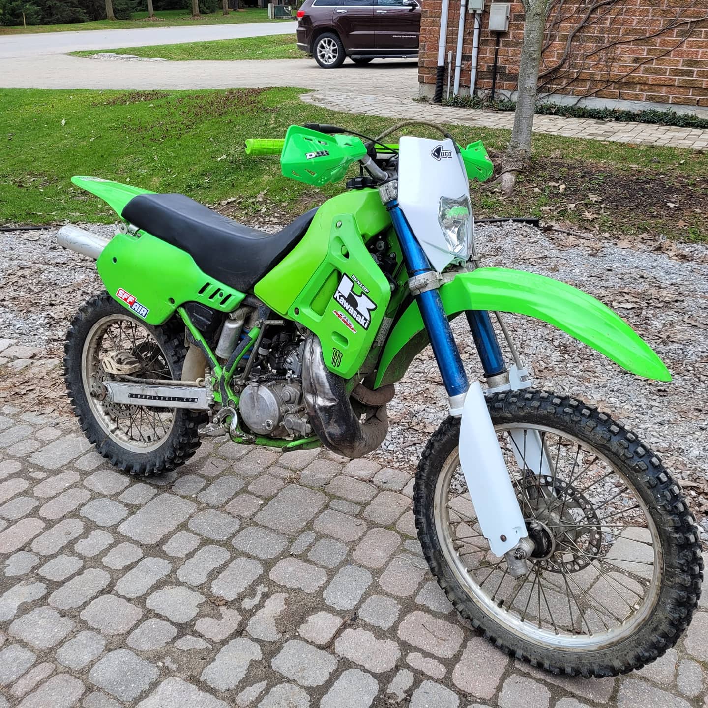

Bought this bike in 2019. Gave it some visual and engine upgrades. Definitely not done with it. More plastic and possibly seat upgrades coming in the future. What do you guys think so far?

Congratulations on the '93. Looking good!
Which type of fork guards and guides are those?
Thanks.
Thanks.

Love it! I still got a soft spot for the E-series bikes.

They are from a 2005 RM250. Guides fit right up. I had to modify the left guard to fit the odd brake line connector that the e series has, and drill a hole on the outer face of each guard to fit up to the side mounting hole. The front mount lined right up.KDXGarage wrote: 08:06 pm May 01 2021 Congratulations on the '93. Looking good!
Thanks.

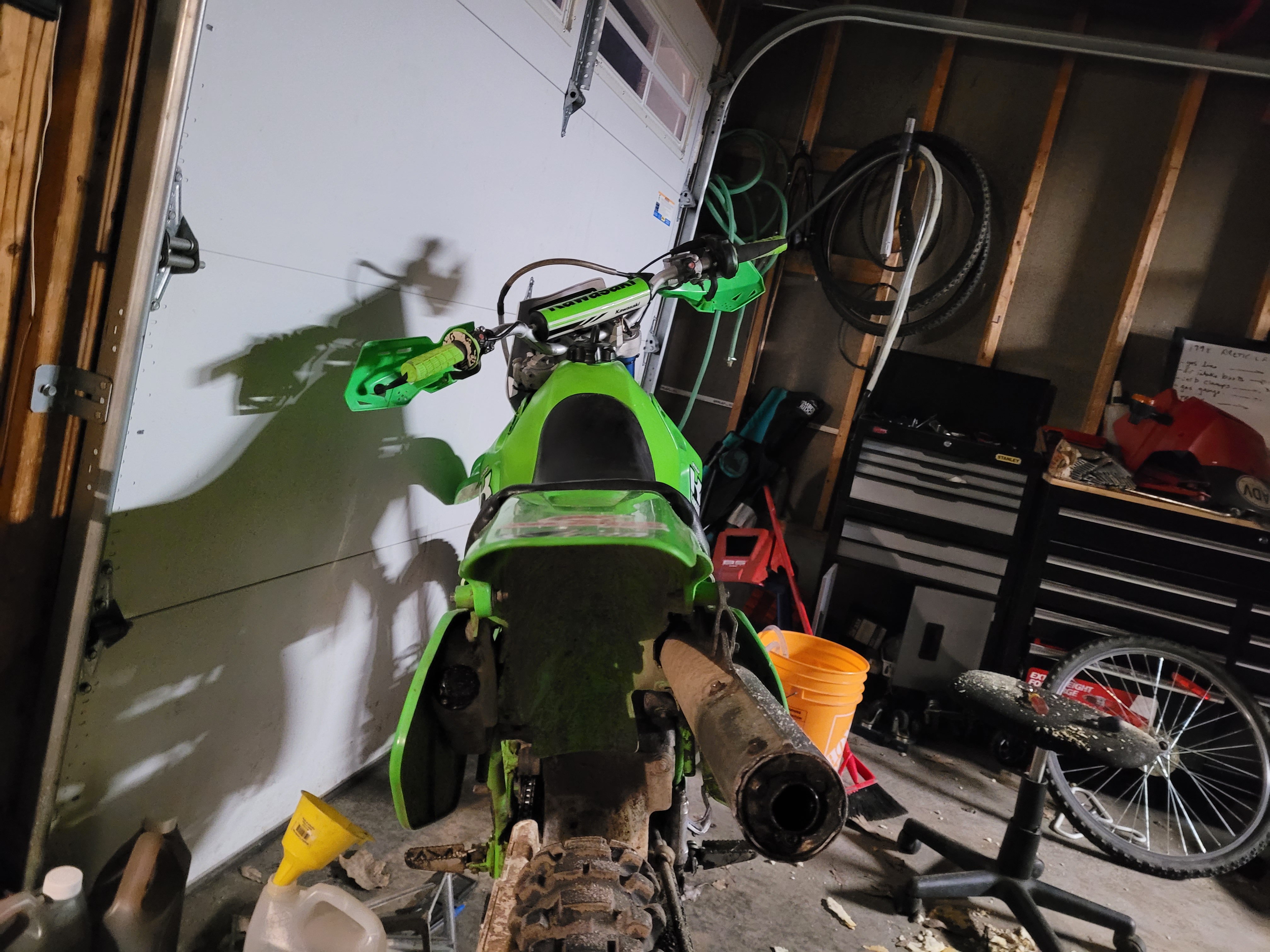

A little update on the '93. So the other day I pulled the seat off and did a little modification. Shaved down the backside of the seat, and trimmed the corners off so the seat can sit pretty much flush with the rear fender. IMO I think this little mod makes the bike look a lot cleaner on the backside.

Re: My 93 build
Hey, it does! Good job.
