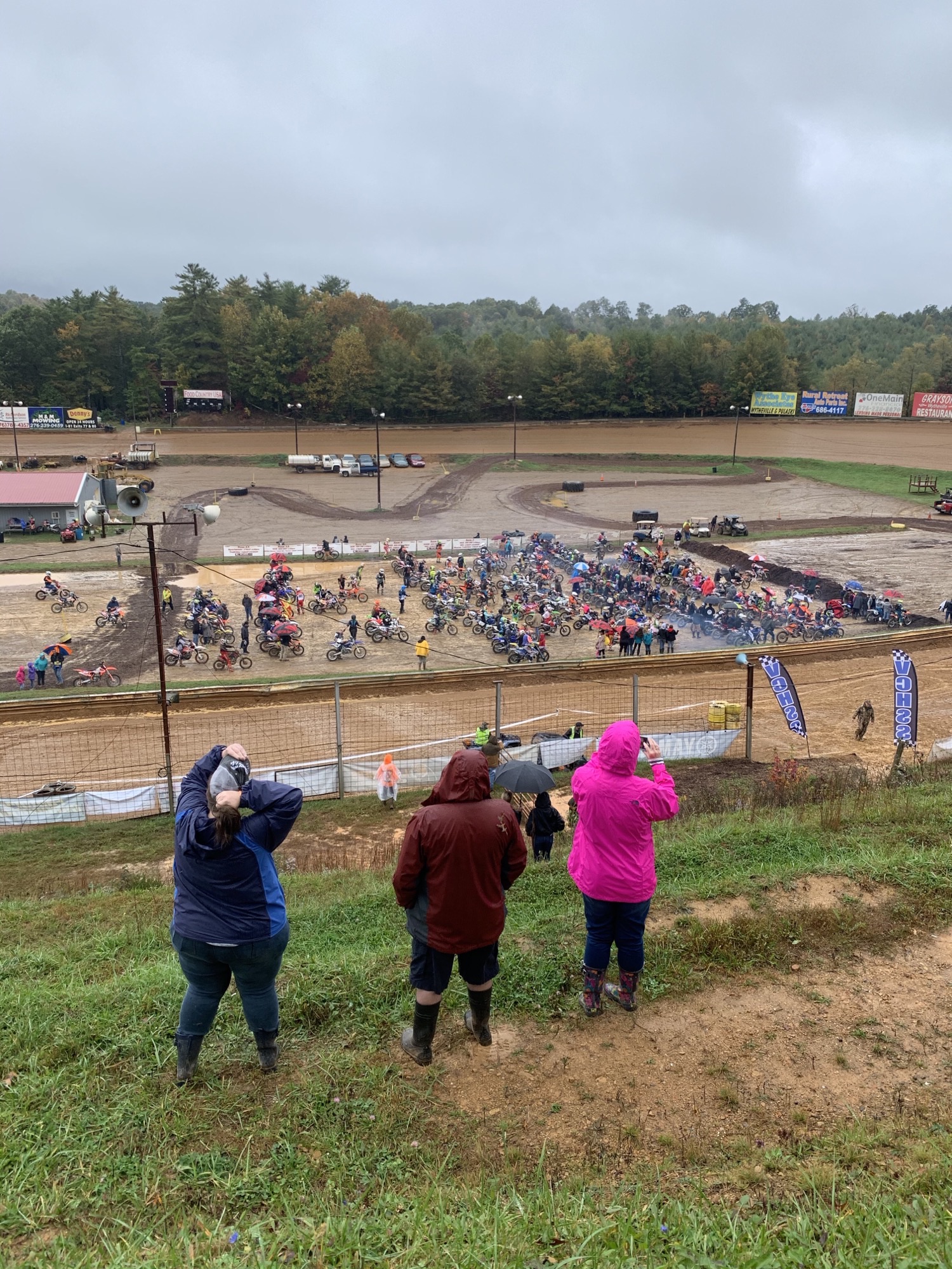

This Sunday we were looking forward to The Rattlesnake Hare Scramble of the VCHSS, a race where you expect to actually use the upper end of your transmission range, a course around and through a dirt track, over an enduro obstacle course, and off into some high speed woods single track with banked turns and steep WOT ups and hang-on-for-dear-life downs.
Was not to be. Well not the upper end of your transmission part anyways.
The tropical storm arrived Friday night with other ideas.
But, this was going to be my second race and what's a little rain and mud right? Apocalyptic, apparently.

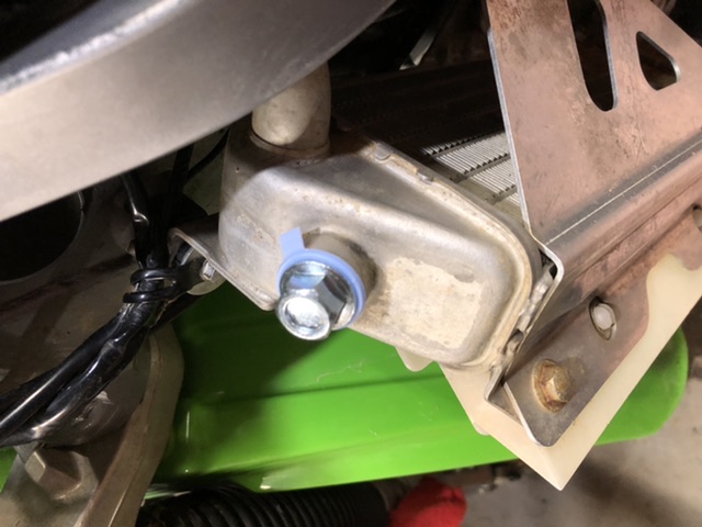

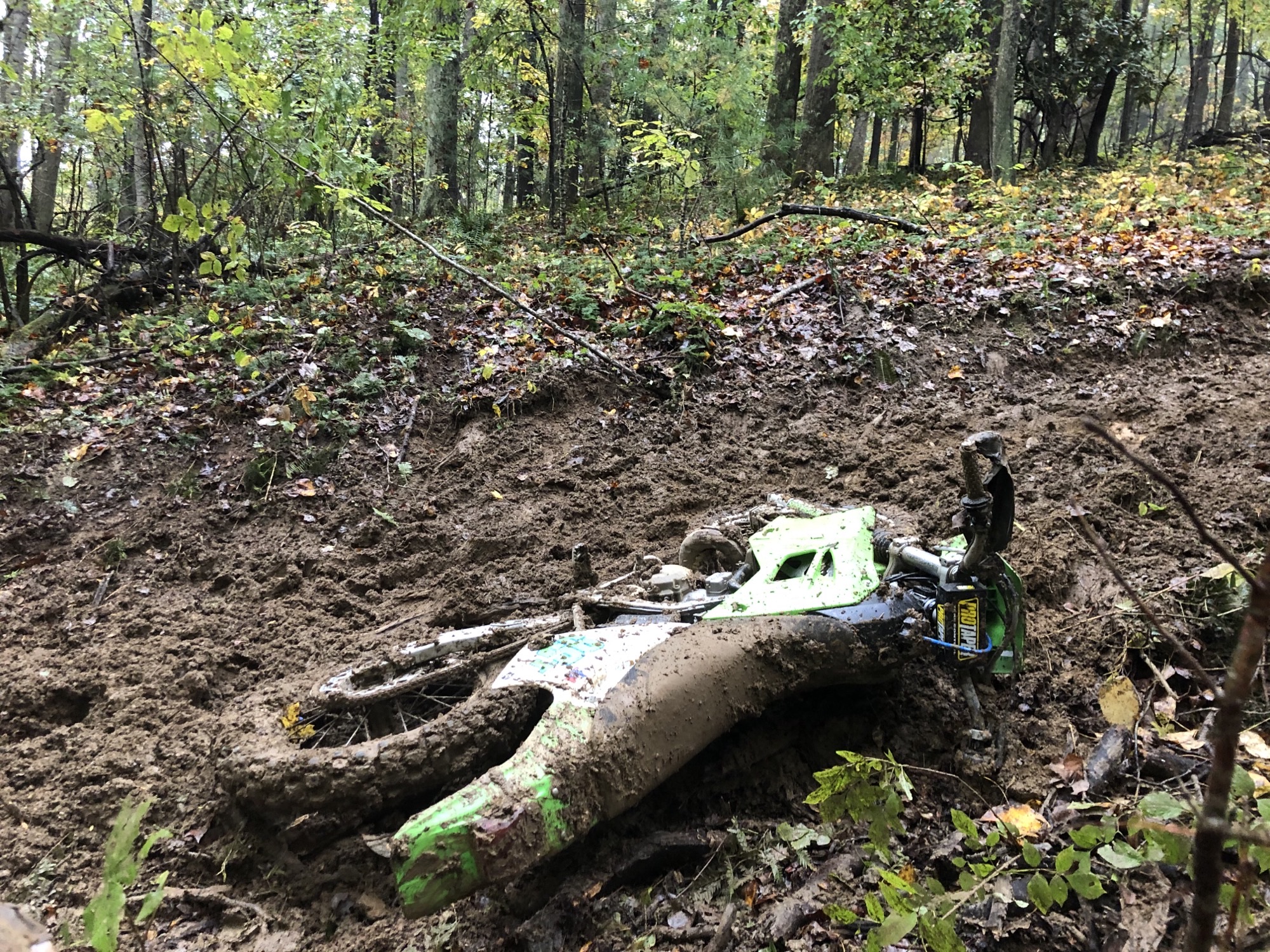

Then as the steam cleared I looked at my bike - the head was intact, what happened?!? Then I saw it, the plug on top of the left hand radiator had blown out. I thought I was done for the day and began to drag my bike out of the rut to clear the way for those behind me. I sat down and caught my breath as I tried to asses my situation among the din of roaring motors, yelling racers and flying mud. The top of the hill wasn't too far above, but was so far out of reach now that my bike seemed to be disabled. I took out my camera and recorded the crazy scene surrounding me as I became aware of all the others around me struggling with their muddy and almost helpless plight. some were just standing there staring at their machines - full on catatonic, or lying on their backs and looking at the clouds above as the drizzle fell and coated their goggle lenses. Wheels spun as engines shrieked, curses rang through the air and pierced the smoke both above and below as racers struggled and refused the fate of victims strewn around them. I laughed, 'Man, this was kind of fun!'

This worked out, as I got to the top I could see the hill climb I was stuck on was finally being rerouted by the marshals for the coming lappers. By text my buddy suggested I refill the radiator with water from my camelback and screw a small stick into the bung where the plug had disappeared, then get back in the race. I wasn't done yet. The bike fired to life and up we went as the now clear trail allowed momentum to be created and rewarded with my release from this slippery mud pit of smoke and destruction. My one lap took 93 minutes, but I didn't care. I got another victory lap around and through the speedway oval and another much easier shot at the enduro course before reaching my checkered flag. As I caught my breath at the finish my son rolled in after his 4 lap run, he finished in 7th place in a packed field. His buddy Mason had won their 200C class and Russ had won his 250C. That evening Mason's dad pulled a 5th in 50+A and Trevor Won the 250A. All of us had finished and brought home hardware. I even managed fifth out of five but did not DNF!

Great story! Congrats on getting her going again. A tip for you: Throw away that plastic plug in your radiator. Go to a automotive parts store and find the closest matching metal oil pan plug. It won’t be the same thread but should be close enough you can retap the threads in the radiator to match your new metal plug. Did this to mine and never had the problem again.

doakley wrote: 12:59 pm Oct 12 2020 Great story! Congrats on getting her going again. A tip for you: Throw away that plastic plug in your radiator. Go to a automotive parts store and find the closest matching metal oil pan plug. It won’t be the same thread but should be close enough you can retap the threads in the radiator to match your new metal plug. Did this to mine and never had the problem again.
Thanks,
I figured that it was loose or just old plastic that caused it to eject under pressure. I thought the radiator cap was supposed to prevent this. It freaked me out - thought I'd blown the piston straight to kingdom come.

Haha! Happened to me in a mud race too. Scared me as well. I don’t know if the plastic gets old, hot, overtightened and damaged or some combination.

Would love to figure out a better than OEM replacement - any idea what the thread and bolt size is?

MoonStomper wrote: 02:32 pm Oct 12 2020 Would love to figure out a better than OEM replacement - any idea what the thread and bolt size is?
Sorry, I don't recall exactly which I used. My radiator was tapped metric but the closest oil pan plug was US. It was close though. I had a mechanic I trust retap and it took him about 60 seconds. He said it was already very close. Just take the radiator to your auto parts store and try a few. I found them hanging on a peg board at AutoZone. About $5-6 as I recall.

PROBLEM SOLVED - after scouring this site I determined the proper bolt size and thread pitch for H model plastic radiator plugs: M12 X 1.25
Then I went to Advance Auto parts and picked up a drain plug complete with gasket. I wrapped the threads in Teflon tape and installed. No issues so far. This part was about $7 cheaper than the plastic OEM replacement by the way. I've added a new Mylers earless, high-pressure radiator cap to my cart at RMATV also which will bring my boiling point up as well which Jeff Fredette suggested for muddy conditions. He also said that he thought the old plastic plug had "probably just gotten brittle."
