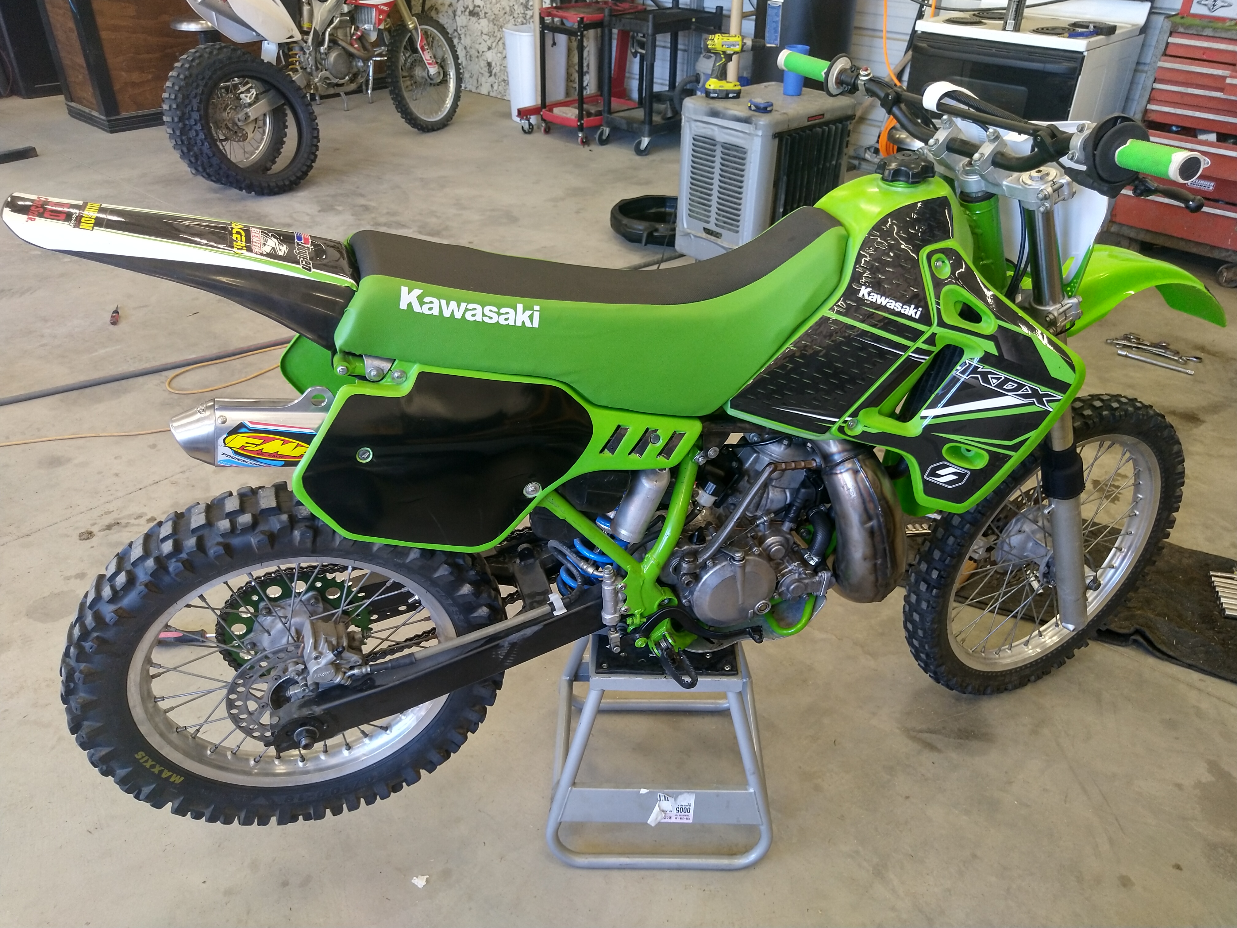

Here is a pic of the bike completely restored. I just finished the plastics graphics and replaced the water pump shaft this week.

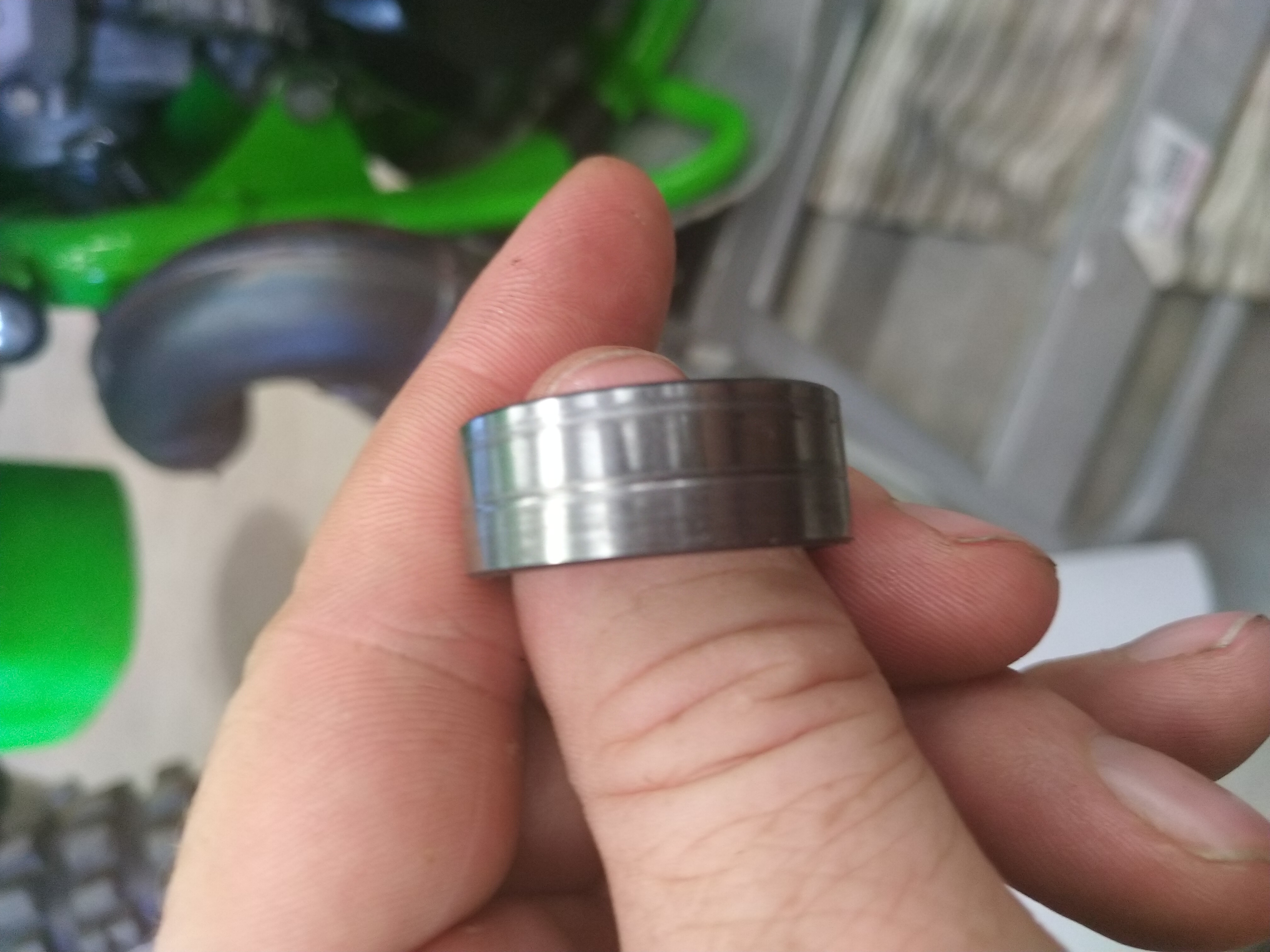

I've taken it apart again. The collar over the output shaft has some grooves. The other thing I found and that I'm confused on is the o-ring that goes on the counter shaft before the collar. When I took it apart it had two. In my service manual it shows only one so I only replaced the one. I went to Rockie mountain ATV and the exploded view shows 2! Arg! I'm assuming this could be my main problem. I've attached the pics of the collar. Not sure if it needs to be replaced. I ran my fingernail over it and it his a little groove but it doesn't catch at all. I also checked my output shaft, it has no up down or side to side play. It does however goes in and out about an 8th of an inch.
Re: Counter shaft seal leak
There should be 2 o-rings behind the collar. You should also use a new snapring on the countershaft sprocket. Finally, depending on the make of sprocket you use you may need to place a shim between the collar and the sprocket. There should be no in/out play of the collar when installed.
Posts: 14743
Has thanked: 184 times
Replace the collar, o-rings and circlip when replacing the seal.
Yes, that collar is shot.
