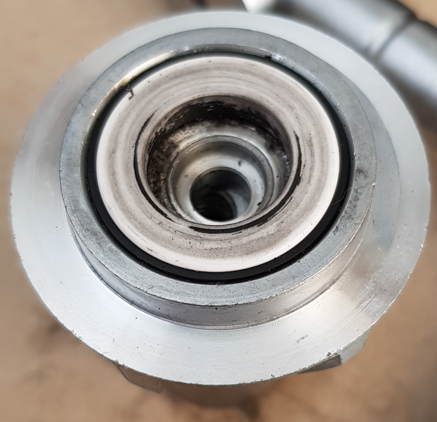

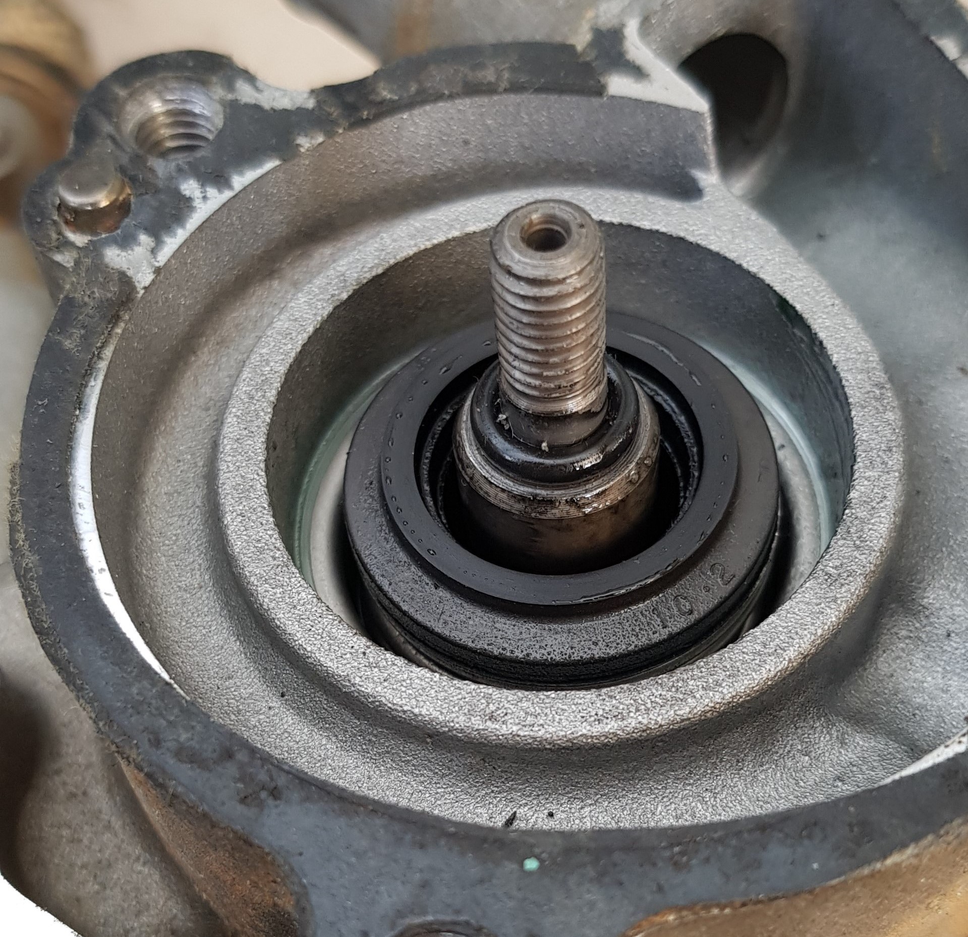

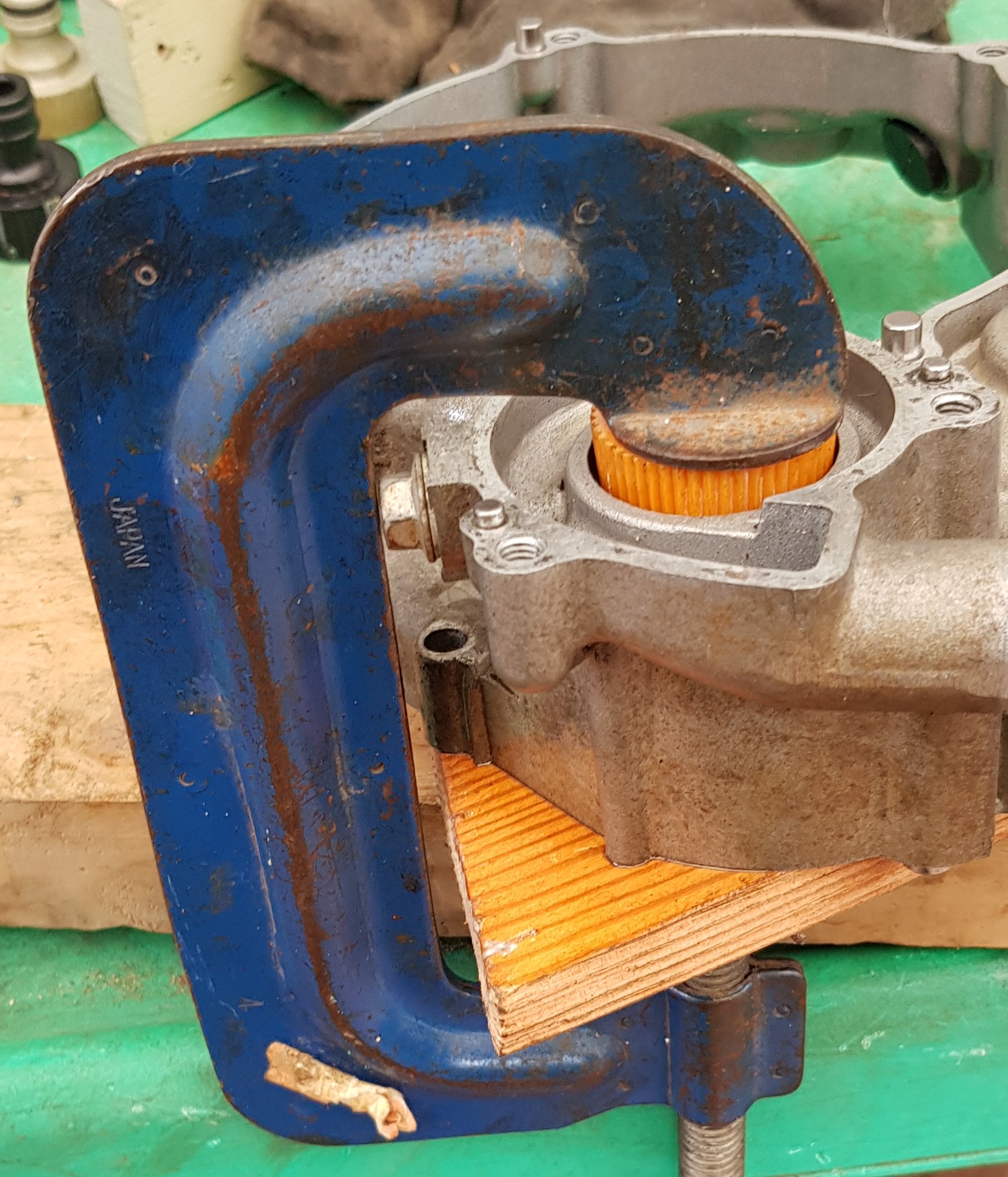

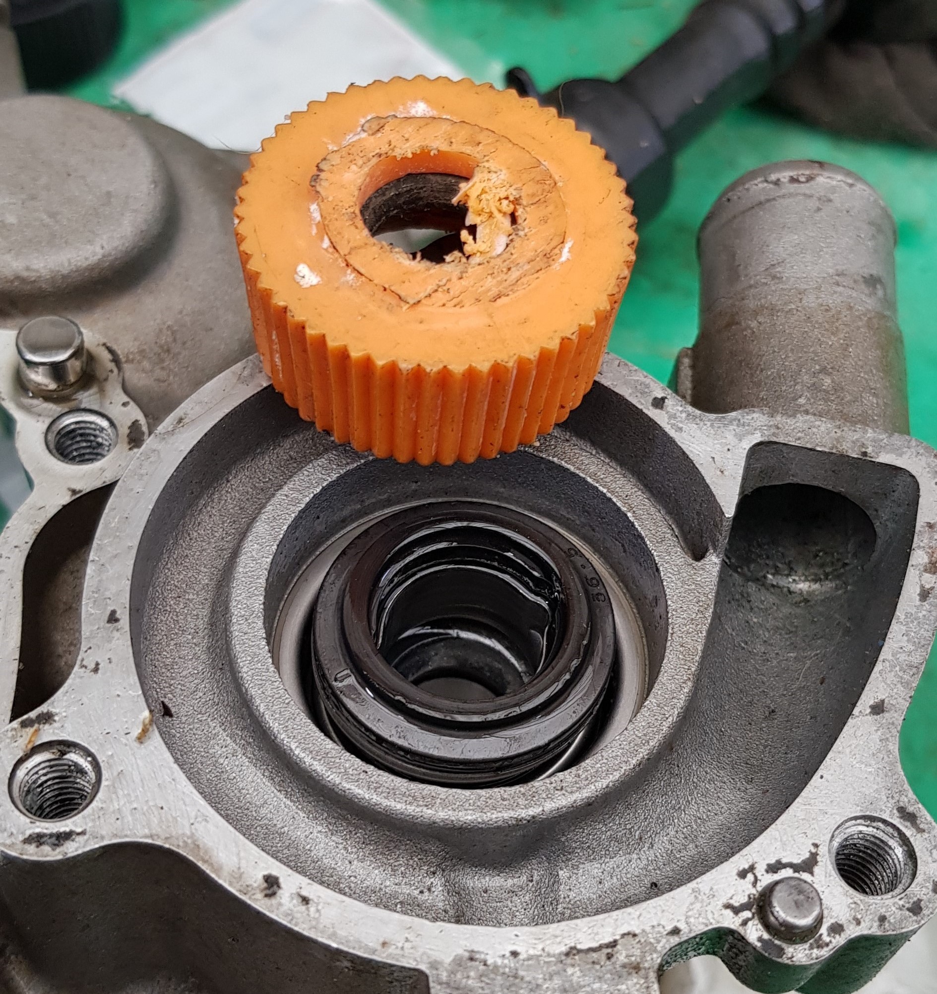

See my photos. Image I pressed the mechanical seal in. What if it was not pushed in far enough? I thought it was, though...

Logically, it sounds like a problem with the mechanical seal, but why would it not seat properly? Is it possible to take the impeller off and use a plastic pipe exactly the size of the outer metal of the seal and tap it in? Can I do this without taking the clutch cover off? Would the blue locktite (?) ring around the mechanical seal have bonded?

If the coolant got into the oil then you have 2 bad seals. Where exactly is the coolant going?It looks like your water pump seal is correctly seated though.

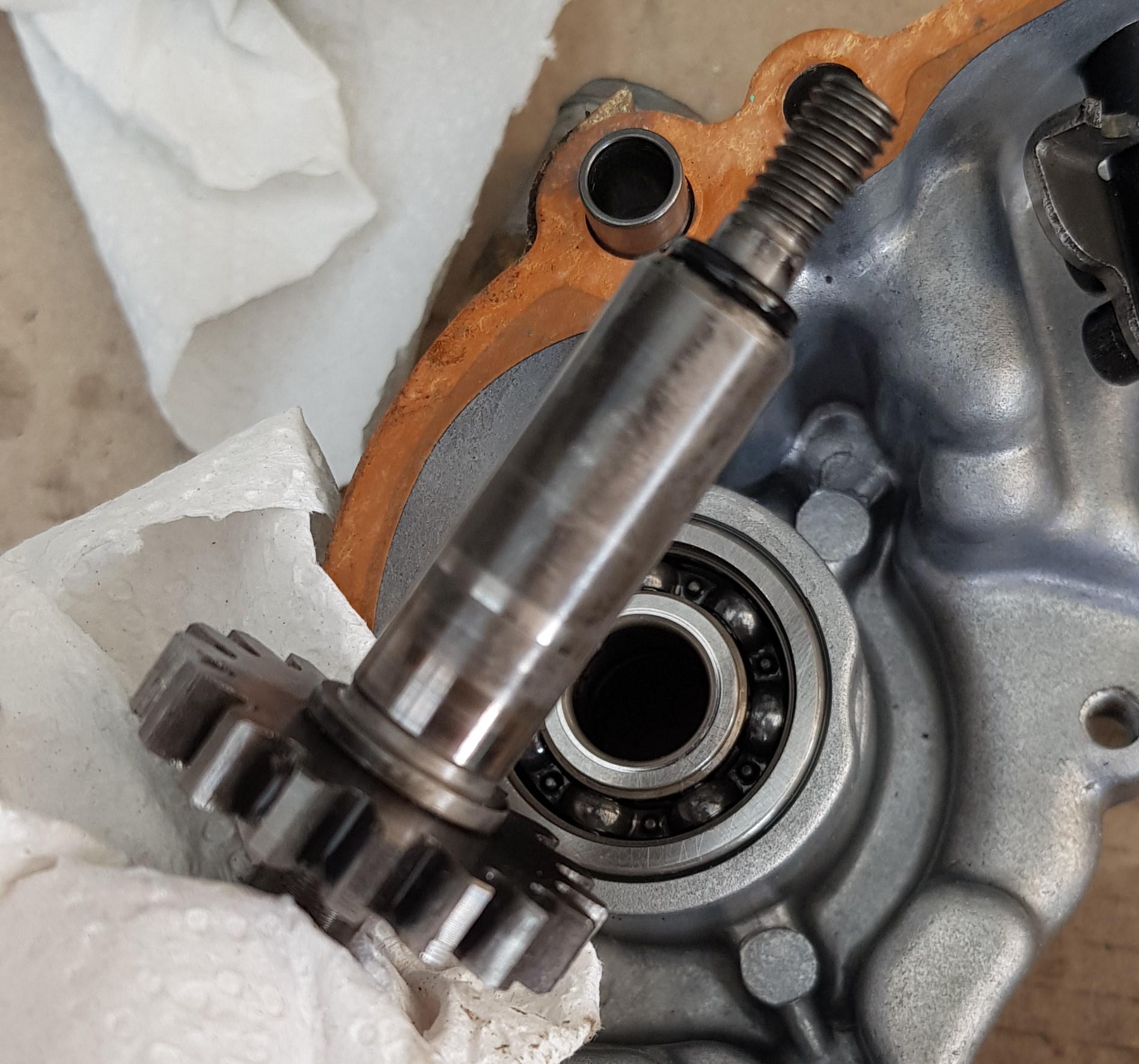

What condition was the pump shaft in? Any wear on the shaft when took it out?

Here is a photo of the shaft (slightly out of focus). It is not shiny smooth but it did not feel pitted under my fingernail.
I looked a the mechanical seal photo again. Zoomed up, it does seem seated correctly.

Did you replace both the mechanical seal and the oil seal? They need to be changed as a set. Take some scotchbrite to the shaft and buff it up also, might help if there’s any tiny grooves in it.

I used some sort of metal polish to rub out what I could, but it was not rough enough to hook my nail when scratched over it.

in the first picture it appears the seal is cocked to one side.Did you lube the face of the mechanical seal prior to assembly?A dry seal face can be destroyed in one rotation.

kdx633 wrote: 01:01 pm Jun 18 2019 in the first picture it appears the seal is cocked to one side.Did you lube the face of the mechanical seal prior to assembly?A dry seal face can be destroyed in one rotation.
I did not notice that it was cocked. It does not mean that it was not, though.
I lubricated the (blue strip) surface that touches the wall of the pump. The problem is there is no way to know, unless I open it up and do it all over again, it seems...
If you were referring to the side facing the back of the impeller: I lubricated it with coolant, as per (my understanding of) the manual.
