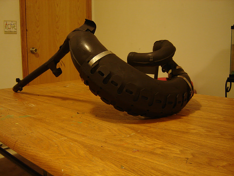

Spose I could chip in. I'm new, but I have fooled with bikes alot and had a pristine '90 KDX200 White edition back when I was a teen and I just recently bought another KDX200 and am In the process of rebuilding it. Anyhow, the thing about the stock KDX expansion chamber is that it was designed with quietness in mind. Why? Duno, my best guess is because it was a dualsport bike over seas and had to comply with dB limits. Regardless, the expansion chamber itself has a sort of silencer in it. It has a perforated baffler material and is packed with fiber glass. If you cut the pipe apart and remove this baffle and packing you can have a pipe that performs nearly as well as an FMF pipe but for $250 less. Now here's you're WARNING- it's not an easy mod. I'm pretty intense and capable but it was not a fun job. obviously be familiar with a welder before you start cutting. So here we go!
Tools: Hack saw, Hammer, long slender punch or flat tipped screwdriver you don't mind killing, welder (mig preferably), pliers
First you need to find the spot welds around the pipe. There are two rings of spot welds around the expansion chamber and you will want to saw through the center of these tack welds to make them easier to break when pulling your baffle out. Also it is good placement for being able to access all the baffle material.
Once you find the tack welds make a line running through these welds to help guide your sawing. After that's laid out make a mark with a nail or your screwdriver in the paint (See the shiney verticle line on my pipe?). This will be used to help line up your pipe later to weld it up.
Now go ahead and saw away! This is what you should end up with
See that nasty baffle junk in there?!
Now begin using your screw driver and pliers to loosen the baffles and pull them out. It will be hard work and MESSY! I highly advise you do this on some cardboard you can throw away later otherwise you'll make a huge mess like I did that's really hard to clean up.
Again, it takes a while but you can do it! This is what should come out leaving you with a nice clean spanny chamber when you pull the fiberglass out (kinda comes out in the process).
You will have to do this with all three parts of the pipe, but for me, the middle was the hardest part.
Now once you get all that crap out, it's a good time to take a hammer and a large piece of tubing and hammer some dents out if your pipe is dented like mine.
That being done it's time to line up your previous scribe mark and the former weld lines and tack weld it.
Next you'll need to clean and degrease your pipe and probably yourself. Now it's time to weld it completely up. If you're like me you'll also want to grind your embarassing welds a little. Then I used VHT black paint for 1000 some degrees from advance auto and then cured it in the oven when the wife is asleep and here's the final product
Now remember you might have just affected your jetting! This should be a pretty big improvement. Now, this is not my original idea, the idea is taken from justkdx.dirtrider.net, but the pictures and write up are my own original work. Enjoy!

Nice pics, thinking of doeing this myself to but how does a gutted pipe perform in comparison to a DG pipe?
More torque or more at high rpm?

Frysk wrote:Nice pics, thinking of doeing this myself to but how does a gutted pipe perform in comparison to a DG pipe?
Couldn't tell you honestly. Over the stock pipe it just has more all over. I've not got to ride it yet and it's been YEARS (atleast 10) since I have rode another KDX. My old bike had an FMF on it back in the day, but I can't afford a pipe currently so this is my solution. I'm not a fan of DG's stuff in the fourstroke world, but I don't recall how they are in the two stroke world. I won't even be able to compare it to stock since the bike didn't run when I got it. I'm doing the pipe mod, air box mod, reeds and jetting it and it's got a silencer so it should run pretty good when I'm done. Pondering a flywheel weight too because I'm wanting to get back into single track :cool: Sorry I can't really answer your question.

bholmes,
Excellent write up on the kdx exhaust.
FYI. If you drill all the spot welds, and cut off half the pipe leaving the majority of it intact you don't need alignment marks, and the baffle comes our fairly easy.
