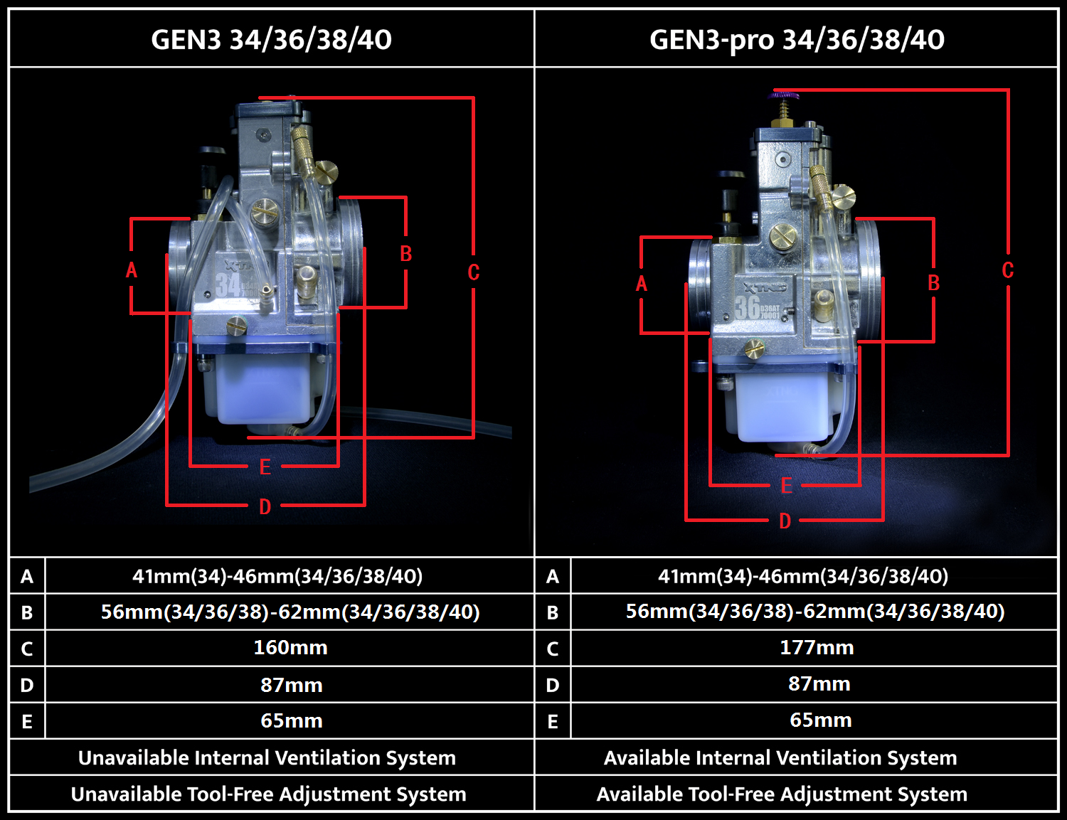

Another thing to look into perhaps would be the new Gen3 XTNG carbs. They're a hybrid of the best features of the Lectron and SmartCarb combined. They're Chinese, but allegedly a rider-owned company, & one that seems pretty serious about R&D. I doubt you'll get one thats so close to perfect fuel metering for a KDX out of the box like the Lectron fuel metering, but we won't know until we try!
I'm pretty seriously considering one for my vintage woods racer 1977 Suzuki PE250B build... Probably put my KDX's stock PWK33 into the '83 PE175 then, or sell it for another XTNG!

These:
Darnit it won't let me remotely display .png or .jpg images from the XTNG carbs website!
I think it just flagged me as a spammer for trying... I get an errir/warning message on my kdxrider.net posting editor screen saying that my IP address has been blacklisted for spam by SpamHaus... What gives? It's clearly working in conjunction with this forum. I found 2 other posts with mention of this Spamhaus/IP Blacklisting, kdxgarage thought that spamhaus had nothing to do with our forum site. Clearly it's written into the forum software.
Here, I've uploaded it to our KDXRider.net server instead of remotely linking: Link:
http://www.xtngmotosports.com/p/2T.html

BUT... nearly EVERYTHING aftermarket these days is outsourced to China... Including OEM parts quite often.
I think these XTNG carbs might be very much worth running. I'll try one on my vintage bike restomod project ('77 Suzuki PE250B 2T enduro) and compare it to the Lectron. This isn't just some made in China cheap carb, it's a performance company based out of the leading manufacturing nation in the world. Leading in both cheap junk and the highest quality technology simultaneously. It's up to the buyer to filter out the good from the bad.

I agree with your statements on the majority of China-based products, but these carbs and this company are perhaps an exception to all of that, as they are supposedly a rider-owned company, they are dedicated solely to making the carbs that Lectron and SmartCarb have failed to (they are a hybrid of the best features of both Lectron and Smart Carbs), and they very clearly put extensive R&D into these carbs, as they have made many revisions and are on the Gen3 redesigns now, improving them every time...Tyl3r wrote: 12:13 pm Dec 05 2022The difference is (with industrial products, motorcycle parts, etc), those things that I look to purchase are designed in countries that have solid reputations for design and engineering (USA, anywhere in Western Europe, Japan, Korea, etc) and they outsource the manufacturing to low cost countries and then fight the quality control battle to have them remain good products. These companies have solid design, engineering, R&D, testing, troubleshooting, etc resources to learn and support the products, they just outsource the manufacturing.Chuck78 wrote: 10:33 am Dec 05 2022 it's a performance company based out of the leading manufacturing nation in the world.
From my experience working as a mechanical engineer in the industrial world, engineered products that come from China based companies are rip offs of a well known product. That country is not know for innovation AT ALL, they are known for ripping things off and then not supporting them very well later on because they don't know how they work because they didn't go through the R&D exercises to properly design them and learn the ins and outs.
Motorcycles may perhaps likely outnumber cars in China, so there is surely incentive for innovation there.
There are also a lot of riders worldwide who are running these carbs, with reviews all over the internet. They are slow to catch on widespread in the USA due to Lectron and SmartCarb being based out of the USA as well as skepticism such as yours, but I feel there's a high likelihood that these will be quite good quality. I've spoken to their tech support customer service representatives several times now already, and they definitely seem very adept and knowledgeable about the very fine and intricate details of fuel metering requirements.
And these would likely fit a KDX better perhaps?

The real problem with the Billetron is that I believe it only comes in a 38mm version! 36mm is the maximum venturi size for a KDX200 or modified 220 for someone who wants to run in tight woods and have crisp low end throttle response, unless perhaps you have an Eric Gorr Big Bore kit and ported cylinder, + Gnarly Desert rev pipe + modified squish band head. I would welcome someone to prove me wrong with firsthand experience between an Air Striker PWK35 or Ron Black 36mm bored version versus the Lectron Billetron, but I'm skeptical that a 38mm could provide the low end response that one of the Ron Black modified Air Strikers or my 34mm Lectron on my 220 provide.
Secondly - I don't believe the Billetrons will fit on a KDX H-series whatsoever... Too tall. Did you try one before switching it to your hybrid build Tyl3r?
There were a few YouTube reviews of the XTNG carbs, and a lot of reviews internationally on them if you spend some time searching. TT is mostly USA residents, where these carbs have just started garnering a bit of interest recently. The first generation had some design quirks to be worked out, and there are some reviews of those floating around on the web, but the second generation redesign fixed nearly all of those issues, and the third gen design was additional upgrades.
Also, the SmartCarb SC2 etc, like the Billetron as far as I can tell, are absolutely too tall to fit on a KDX H-series frame... One of the Technologies Elevated (SmartCarb parent company) employees told me they definitely do not fit, but they absolutely fit many KDX hybrids, as he has experience with assisting on one, and said it runs quite awesome on the hybrid build.
The XTNG features are sort of a hybrid of the adjustability features of the Lectron Power Jet + the low end "pilot" adjustment of the Smart Carb, and with external metering rod adjustability on some models. That was one of the most appealing features of them in addition to the price, the adjustability of both.
My Lectron 34mm does me quite well, although it would do even better if the previous owner hadn't installed a V-Force3 reed block intake, it mounts it further back and the carb is at an angle. I would also be more happy with it if I had one of those custom Barnett throttle cables illustrated in the Barnett engineering drawing I believe earlier in this thread. with fat bar adapters on these KLX300R triples and CR High bend handlebars, the cable supplied by Lectron is barely long enough, and I have to be very careful about how I route it otherwise I get unwanted accidental throttle input from turning the bars...

If you haven't bought one yet, the more expensive brand new Lectron Billetron Pro Series are easier to get dialed in especially for a 200, and they fit significantly better. If unmodified, you will have to stretch out the intake and air box to fit around the larger Billetron, but the "38" venturi size is still the same as the Legacy series Lectron that they spec for our bikes. 34mm.
You also need the long body adapter they offer for $22 extra, as these carburetors are much shorter length - which is why they fit significantly better than standard Lectron offering.
Both will run awesome, but I'm now realizing that I've been a bit rich overall on that older style Lectron. The Billetron Pro Series has a low speed adjustable jet and the power jet for high throttle openings, so you can custom tailor the fueling curve a lot better throughout the throttle range.
They ARE NOT CHEAP, however!
Neither are SmartCarb SC2 36's...
The 34mm Legacy era Lectron Power Jet carbs work awesome on the 220 engine. Some love them for the 200's, but others say they can never quite get them dialed in ideally on a 200.
If I have time tonight & tomorrow night I'll be installing the real version Billetron Pro Series (previously they had sent me a scrapped test fitting body with the intake spigot machined down in diameter). Not sure I'll have time to get it dialed for our Saturday single track ride though if it needs metering rod adjustments and tinkering to get perfect. Hopefully it's set up pretty good out of the box but it's the first one of these that Lectron was aware of going onto our bikes.
I did some R&D for them as far as 95-06 KDX fitment concerns. They fit better than the older Lectrons they currently sell for our bikes. They machined mine down to PWK35/33 spigot diameter, and the long body adapter down to PWK33/35 airbox bell diameters, but that's not 100% necessary especially if using a Boyesen RAD Valve.
That's the other huge bonus, the standard Lectron barely fits with the stock reed cage and intake manifold)shoves it back into the frame crossmember, it's a long and tall carb despite looking quite slender vs the Billetron Pro Series (which is fatter/bulkier looking but also shorter in 2 very critical dimensions).
The Billetron Pro Series actually fit BETTER WITH a Boyesen RAD Valve reed cage and intake assembly or Moto Tassinari VForce3 reed cage assembly.
XTNG Gen3 carbs absolutely do not fit our bikes, and the Smart Carb SC2 36 is uncertain, Smart Carb told me they had reports of frame interference issues on 95-06 KDX, & therefore they do not recommend them for our bikes, although they have no firsthand experience or even photos to document these interference issues. They did say the newer billet SC2 etc carbs are shorter than their original cast versions, but still, comparing dimensions and scaling other dimensions off of their photos, it'd be tight, but may work.
