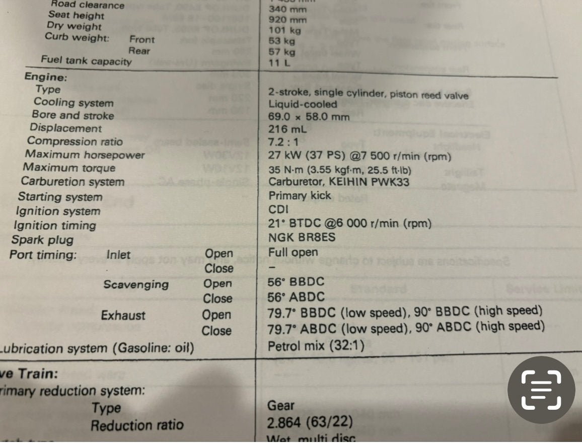

Just saved these from a recent 69mm overbore 200 thread on ThumperTalk:
200H port timings:
220R port timings:
https://www.thumpertalk.com/forums/topi ... swap-dyno/
(thanks to James Zichelle)
