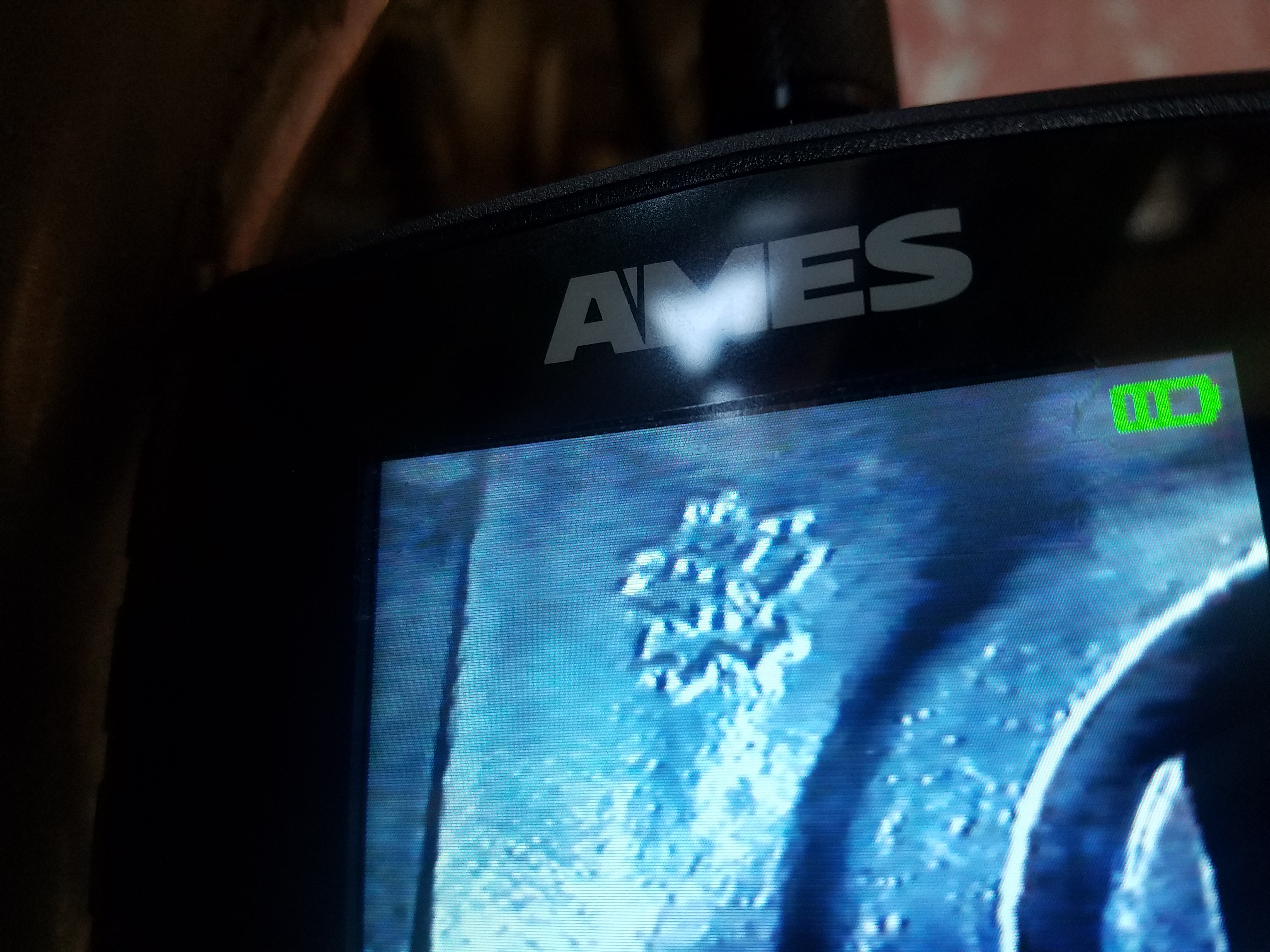

The provided image shows both the “double star (maple leaf) SK letters” symbol and the numeral “2” above the symbol. These markings exist on the inside of the piston skirt near one of the wrist pin boss. The piston was placed approximately mid-stroke and the camera was inserted through the intake ports located left and right of center. It is possible to see the symbols from either of these two intake ports. The “good” image was made with the camera inserted through the right port. The “poor” image was made with the camera inserted through the left port. The “poor” image’s value is that it shows it’s not necessary to get a “good” image to identify the stars. If not for this forum, I would not know to look for these symbols.

4) Secondly, it took me a good while to comprehend the features displayed on the camera video screen. Even though the "good" photo is good, a fair effort was expended to reliably locate the star symbol. However, now that it is known where it "lives", it is easy to re-locate it.

Man. That's pretty cool. Thanks for sharing. Yes, it is OEM. It may not be the original, but it is indeed OEM (stock).

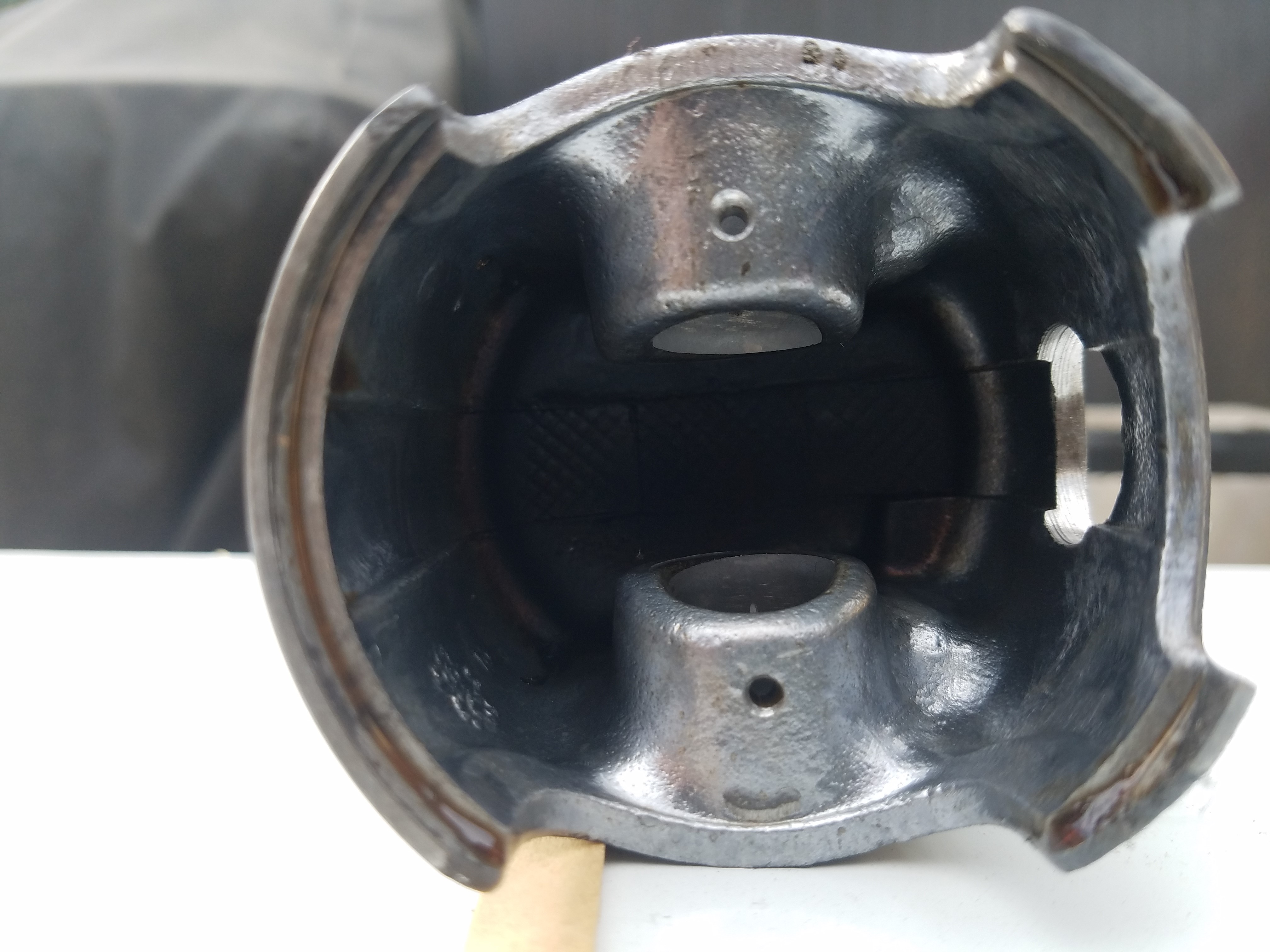

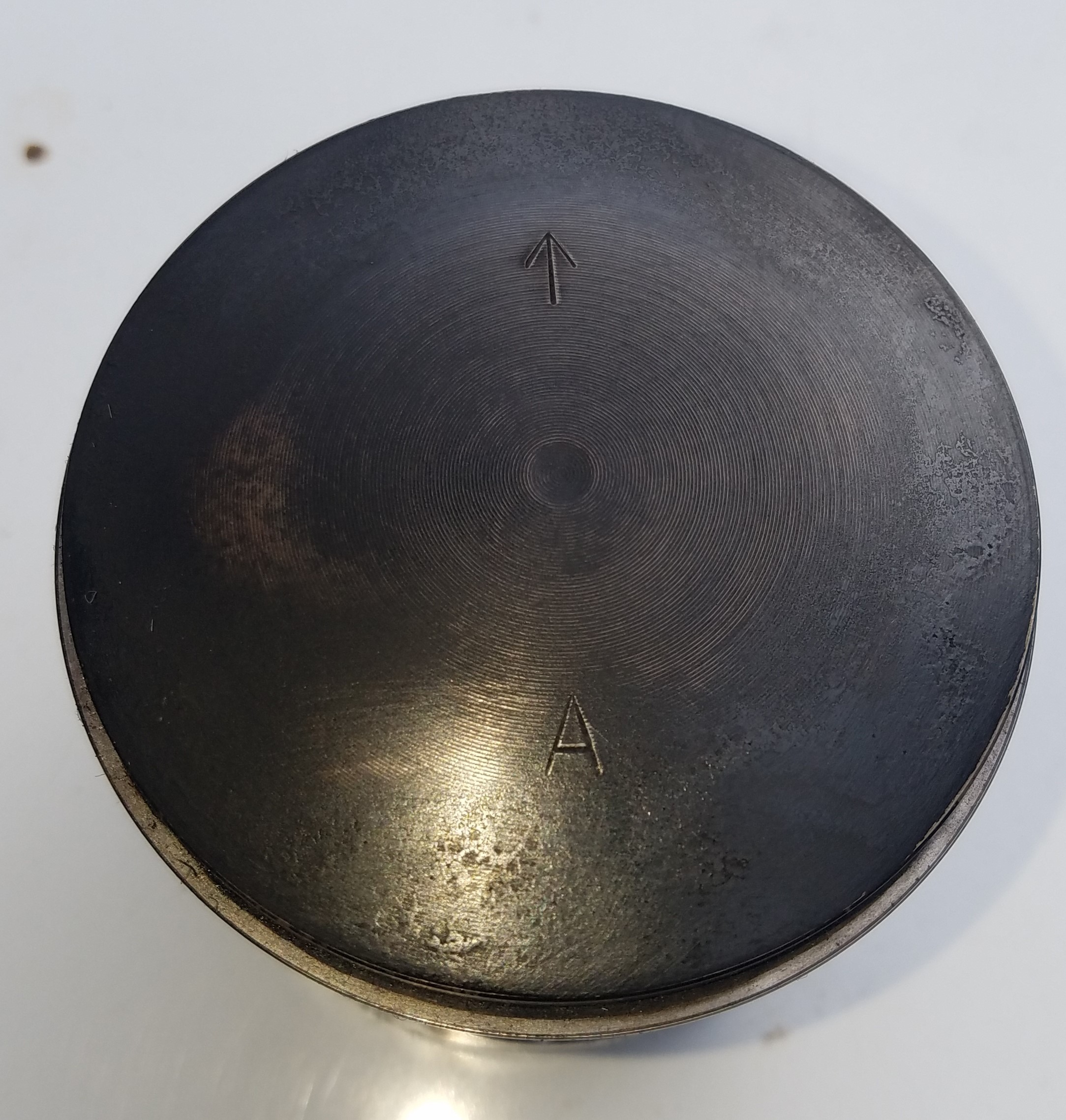

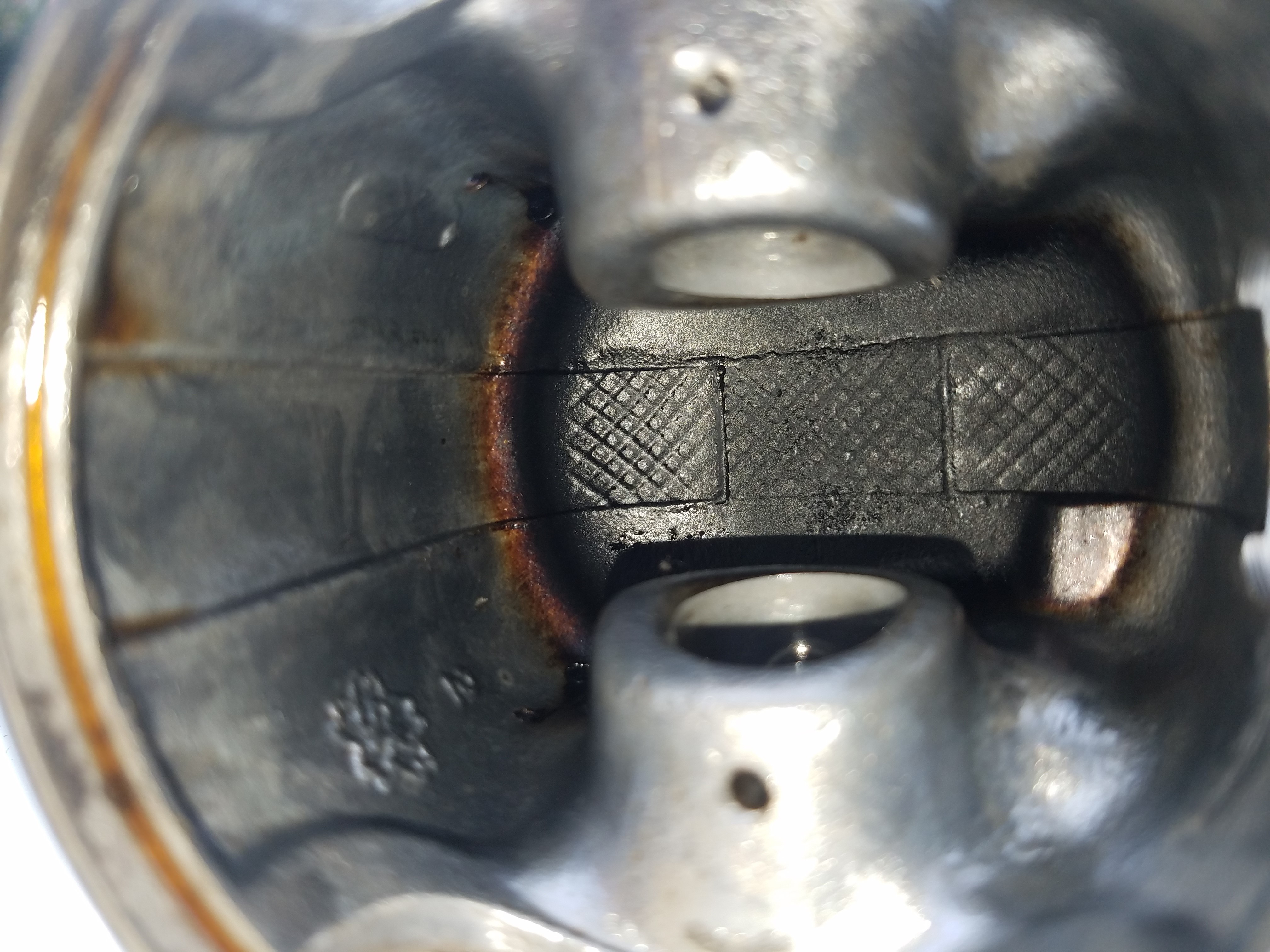

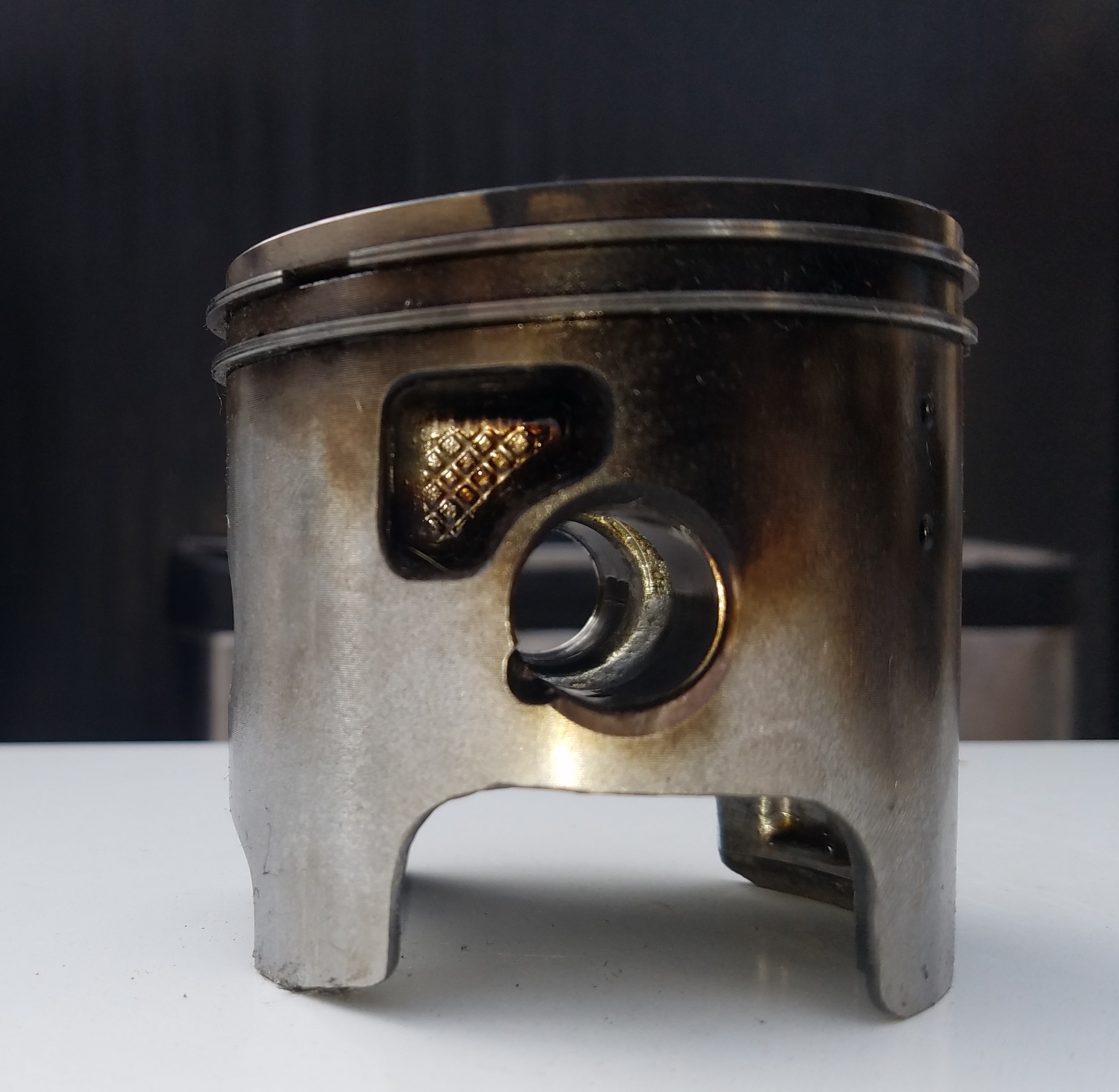

For the benefit of those that want to know what the OEM (stock) piston looks like, here's a series of "good" photos. These photos show the top, side view with casting "waffle" pattern displayed, wrist pin bosses (big, round shoulders, whereas forged pistons require less material and are squared / squarish), and underside view with casting "waffle" pattern displayed (this is the underside of the top).
If this were a Wiseco piston, then you'd see numbers across the top.
It's possible to see the "SK" star and numeral 2 in the underside photos, which are key indicators for OEM piston.
