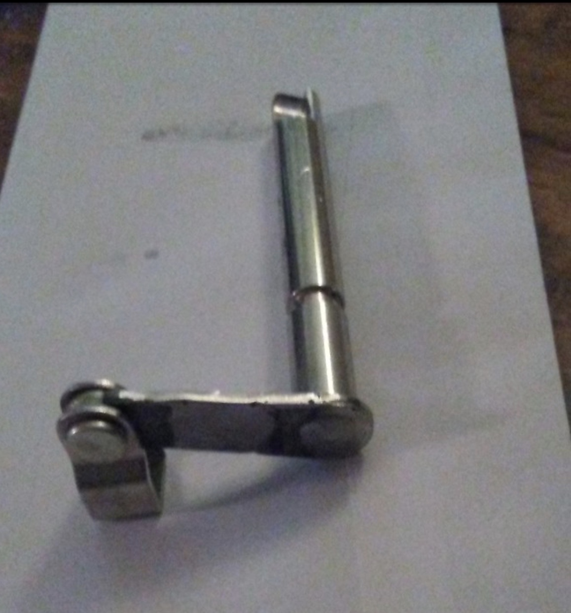

Wr450f Yamahas have a tremendously tough clutch lever effort, I rode a friends that had the lever/cable end location redrilled and it wasn’t bad at all. Lengthening the clutch arm and a ratio reducer also do the trick

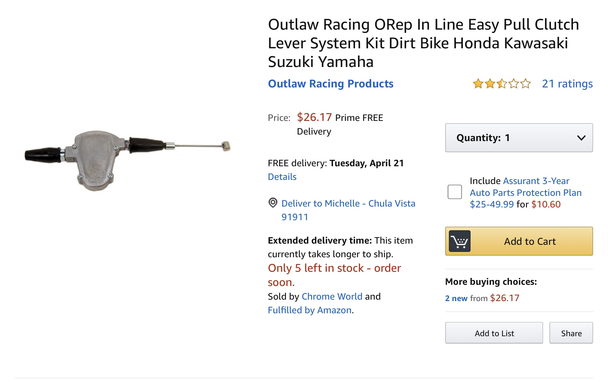

I didn't know about this Outlaw Racing product but it looks interesting and is cheap enough to be worth a try. I switched to a Magura hydraulic system AR first and loved it. Ultimately I ended up putting in an an EMF Autoclutch and just eliminating the clutch lever. I had other reasons for wanting the autoclutch though. Not sure I would recommend it for a lung rider as it will keep him from learning proper clutch control.

Trust me, don't waste your money on the Outlaw Racing system or any like it. Yes, technically it does work but it totally changes how your clutch feels at the lever. Expect to have to pull the clutch to the bars to get it to disengage the clutch and it might not even then. Tried one on my bike as it was given to me. I ripped it back off after my first ride with it. Just horrible.

I’ve never ran that Outlaw ratio changing device but lengthening the clutch arm and redrilling the lever does improve lever pull effort. Lever mod is cheap too, isn’t to complicated to perform.

I forgot to add another problem with this type of unit. It flops around like crazy smacking your bars and whatever else is close to it.SS109 wrote: 10:00 pm Mar 22 2020 Trust me, don't waste your money on the Outlaw Racing system or any like it. Yes, technically it does work but it totally changes how your clutch feels at the lever. Expect to have to pull the clutch to the bars to get it to disengage the clutch and it might not even then. Tried one on my bike as it was given to me. I ripped it back off after my first ride with it. Just horrible.

OK. I trust your experience. Sounds like junk! (It did seem too good to be true.)SS109 wrote: 05:47 pm Mar 23 2020I forgot to add another problem with this type of unit. It flops around like crazy smacking your bars and whatever else is close to it.SS109 wrote: 10:00 pm Mar 22 2020 Trust me, don't waste your money on the Outlaw Racing system or any like it. Yes, technically it does work but it totally changes how your clutch feels at the lever. Expect to have to pull the clutch to the bars to get it to disengage the clutch and it might not even then. Tried one on my bike as it was given to me. I ripped it back off after my first ride with it. Just horrible.

Here's a link to some info on extending the clutch arm like SS109 mentioned above - Clutch release arm extension . I've been thinking about doing this mod, but just haven't gotten around to it since my clutch lever isn't too difficult to pull.
