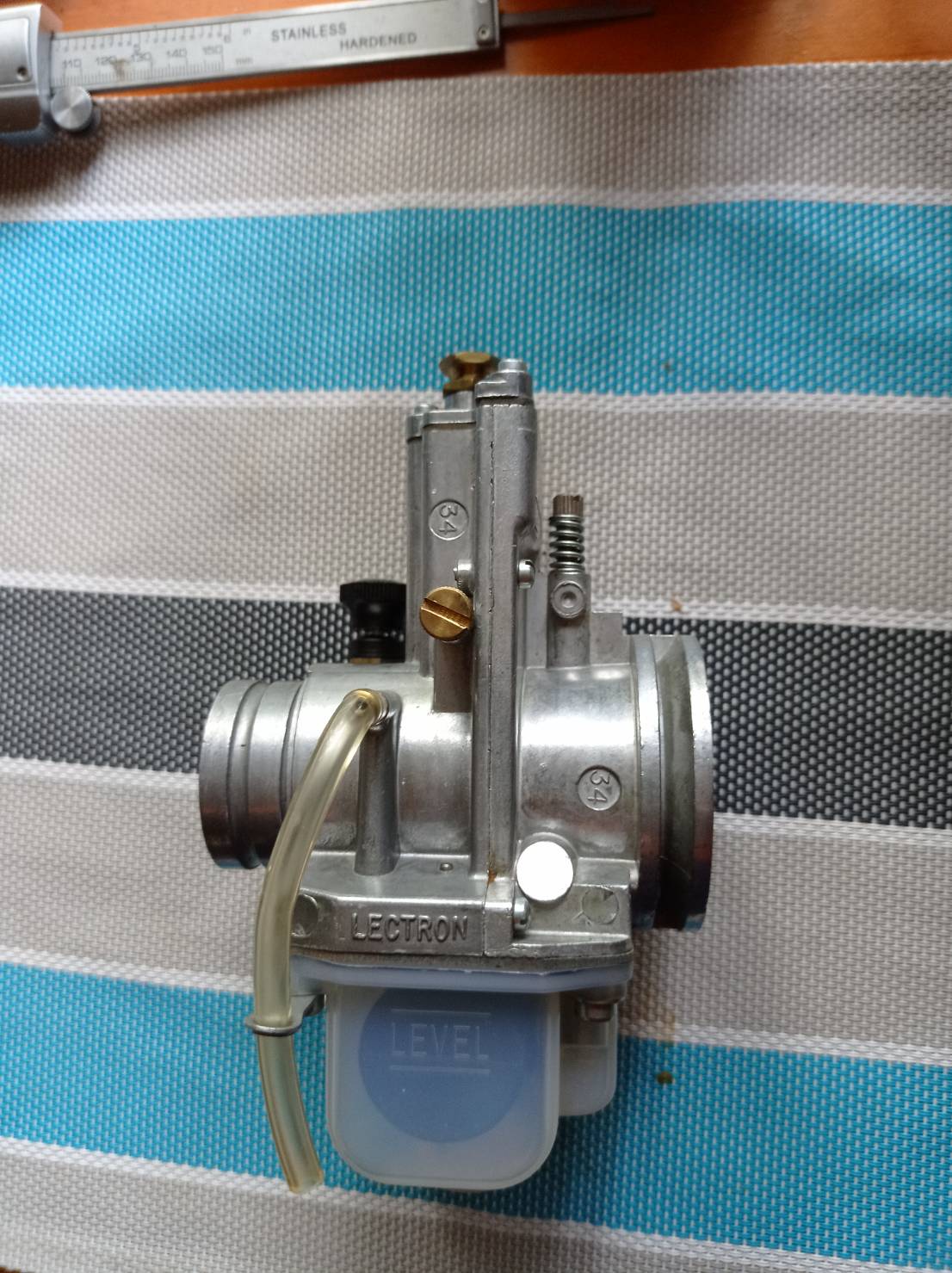

I ordered the Lectron for my KDX in July 2021 and received a 34mm Power Jet carb, part# 1530-KDX. It was $515 and came with a new Barnett throttle cable and metering rod adjustment tool. Lectron recommends the Motion Pro Vortex MX-style throttle, but they were out of stock so I searched the internet and found one.
My Lectron looked well-crafted. I'm a retired machinist so I recognized the good workmanship. I removed the gas tank, rear fender, and air box so I wouldn’t have to struggle getting the Lectron into the rubber manifold and air box boot at the same time. I tried to insert the carb into the manifold, but it wouldn't go. I removed the manifold from the bike and tried to push the Lectron into it, but it still wouldn’t go.

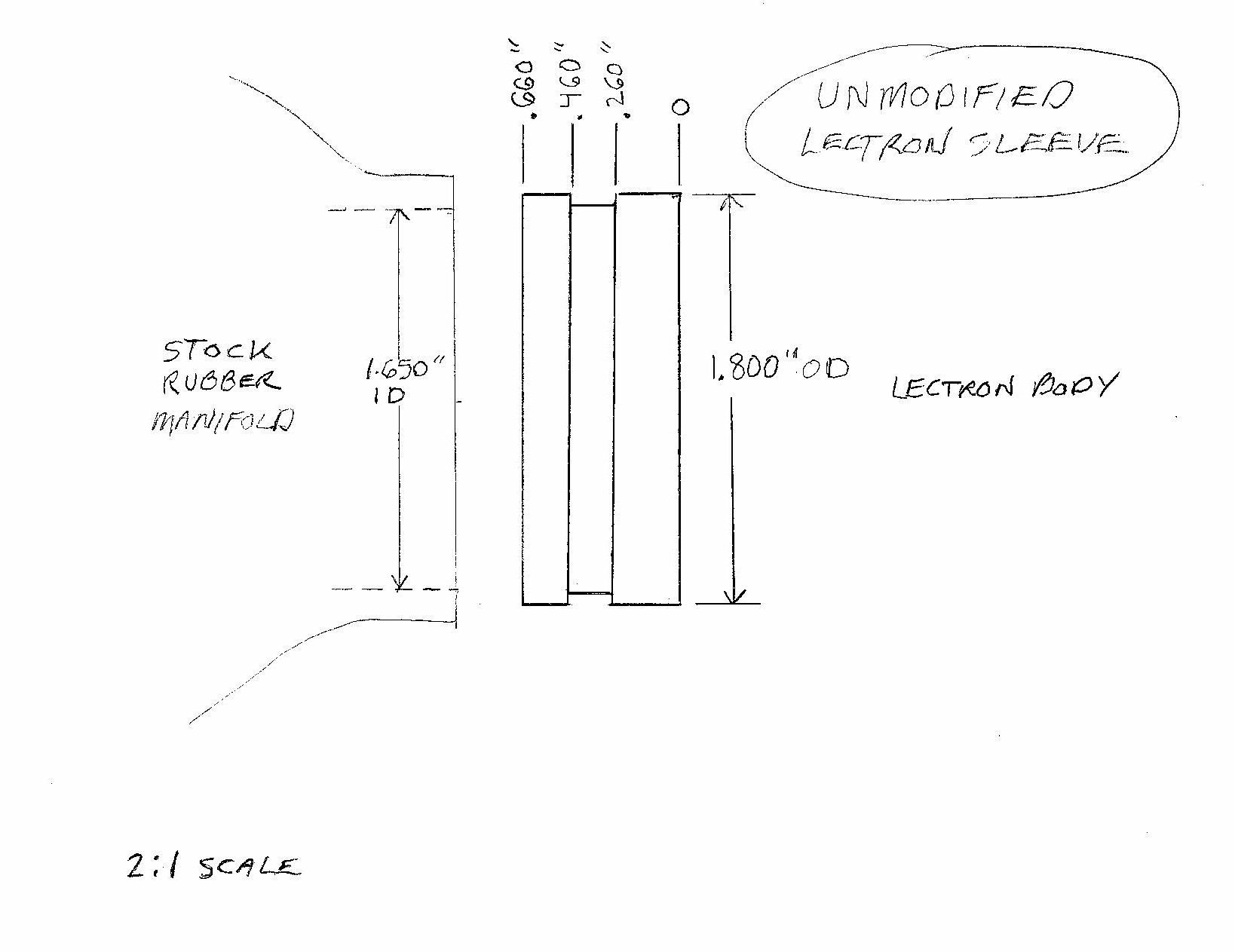

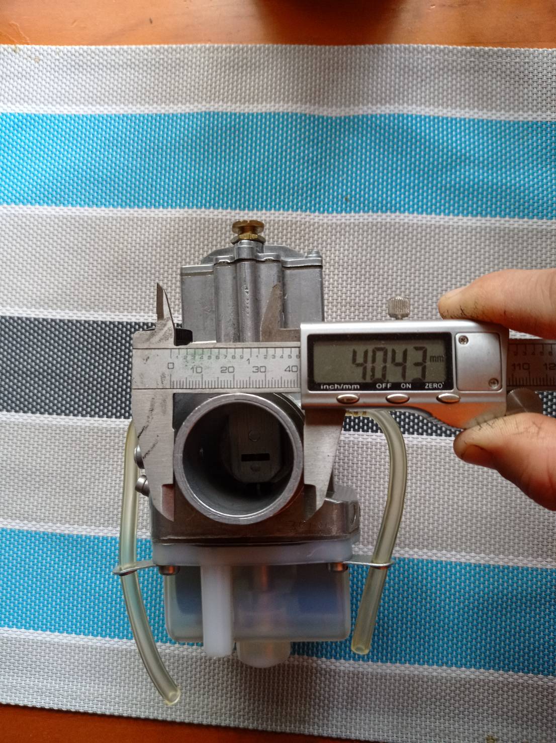

There are machined sleeves on both ends of the Lectron. I measured the diameter of the front sleeve and it was 1.800” (45.7mm). The stock Keihin diameter is only 1.650” (42mm). The Lectron wouldn’t go into my rubber manifold because it was .150” (3.8mm) bigger diameter than the stock carb. The stock carb fits into the rubber manifold like a glove. I was surprised the Lectron wasn’t machined to the same dimensions. In contrast, the rear sleeve of the Lectron that goes into the air box boot was machined to the same dimensions as the stock carb and fit perfectly there.
ABOVE: I put the Lectron and Keihin face to face to show the big difference in diameter to fit in the manifold.

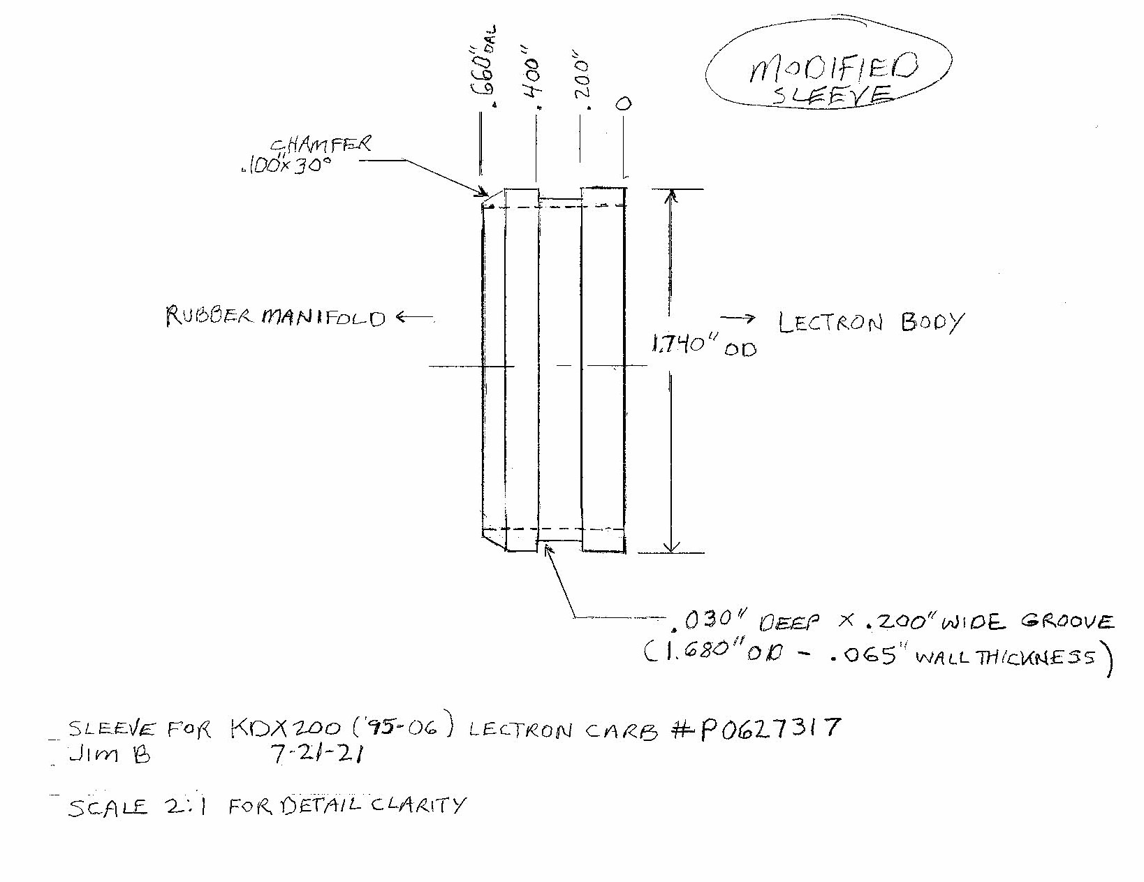

I made a list of modifications for the front Lectron sleeve as well as for the rubber manifold in order for them to fit better together. My biggest fear was of the carb coming loose from the lathe chuck and flying through the air (and hitting me in the head) while I was machining it so I made a plug to insert in the carb bore and used a live center to hold the plug. My second concern was damaging the $100 rubber manifold. Here are the modifications I made:
1. Lathe: I turned down the outside diameter of the front Lectron sleeve from 1.800” (45.7mm) to 1.740” (44.2mm). I wanted to turn it all the way down to the diameter of the Keihin, 1.650”, but that would remove the majority of the sleeve and leave a very thin wall thickness.
2. Lathe: I chamfered the leading edge of the sleeve so it would go into the manifold opening easier.
3. Lathe: The existing sealing ring groove on the sleeve disappeared when I turned to outside diameter down in step one so I had to cut a new groove into the outside diameter in the correct location of the sleeve for the manifold sealing ring.
4. I used a Dremel tool with a small sanding drum as described above to sand a small lead chamfer in the rubber manifold to help insert the Lectron.
5. I also used the Dremel sanding drum to carefully sand down the molded stop in the manifold at about the same angle as the chamfer on the carb sleeve to allow the Lectron to be inserted far enough in (forward) so the carb clears the frame enough to be able to stand it upright, or nearly upright, as it turned out. I had to beware of damaging the sealing ring surfaces of the manifold lest I suffer the dreaded vacuum leak.
ABOVE: This is the way the sleeve came from Lectron.
ABOVE: These are the dimensions for the modifications that allowed the sleeve to fit inside my manifold far enough to stand the carb almost upright. I sent this drawing to Lectron and told them these changes made the difference in fitting their carb.

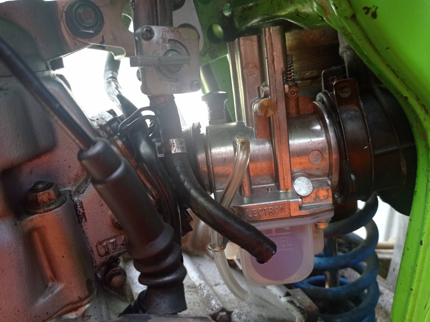

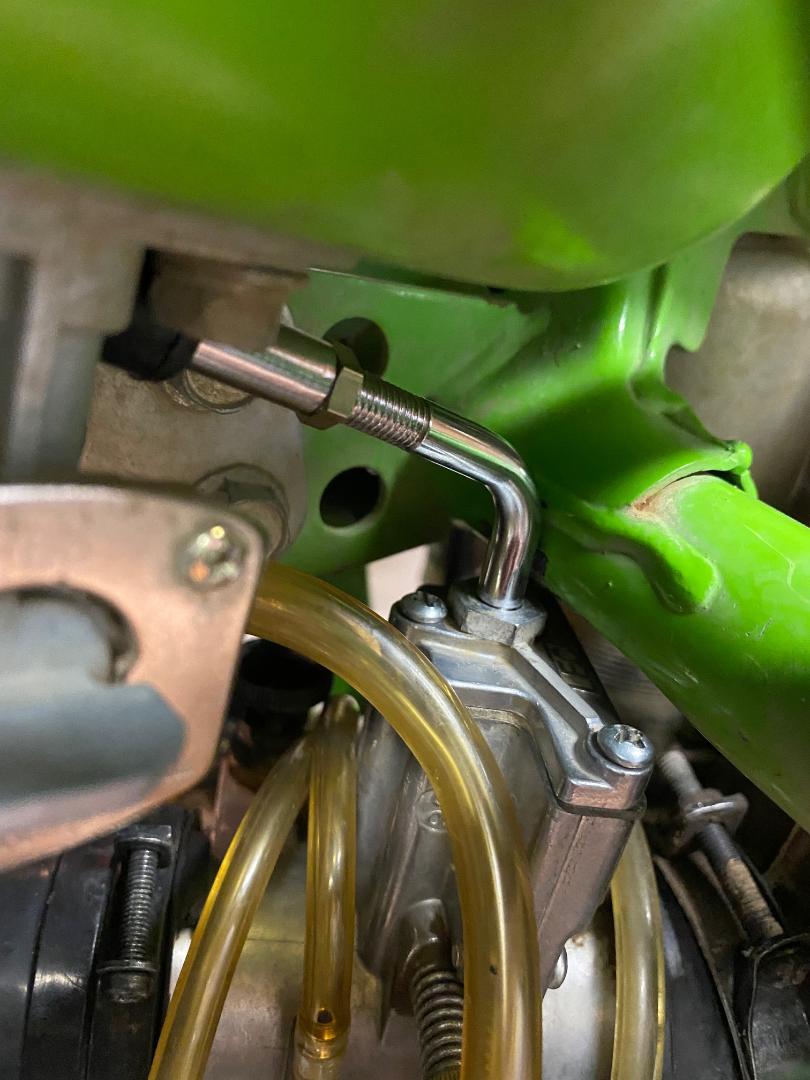

Here is the modified Lectron installed on my '99 KDX200. Notice the top of the carb is against the frame, preventing the carb from sitting completely upright, and the throttle cable wraps to the left (outside) of the petcock. It clearly isn't a factory installation but it works great!

Wow, that was a lot of risk on your part to get it to somewhat fit. Kudos to you! It's sad that I know Lectron has been made aware of the fitment issues with the KDX but still hasn't done squat to rectify the issues. Eh, as long as you're happy with it is all that matters!

Looks good! With the new Billetron I think it's much more compact and should fit more easily.
That is the factory location for the throttle cable by the way.

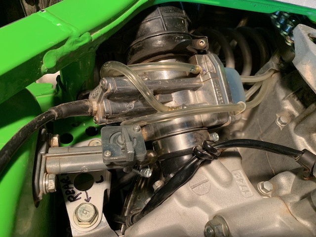

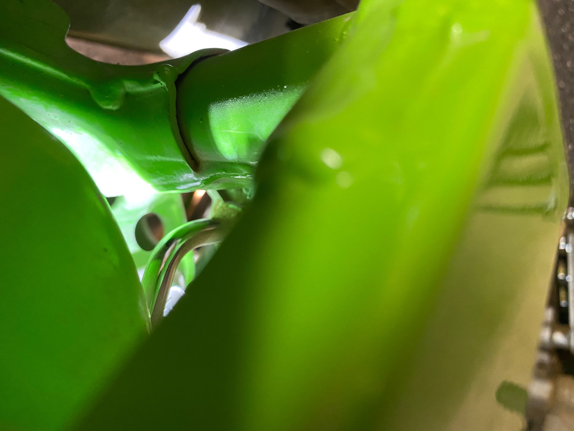

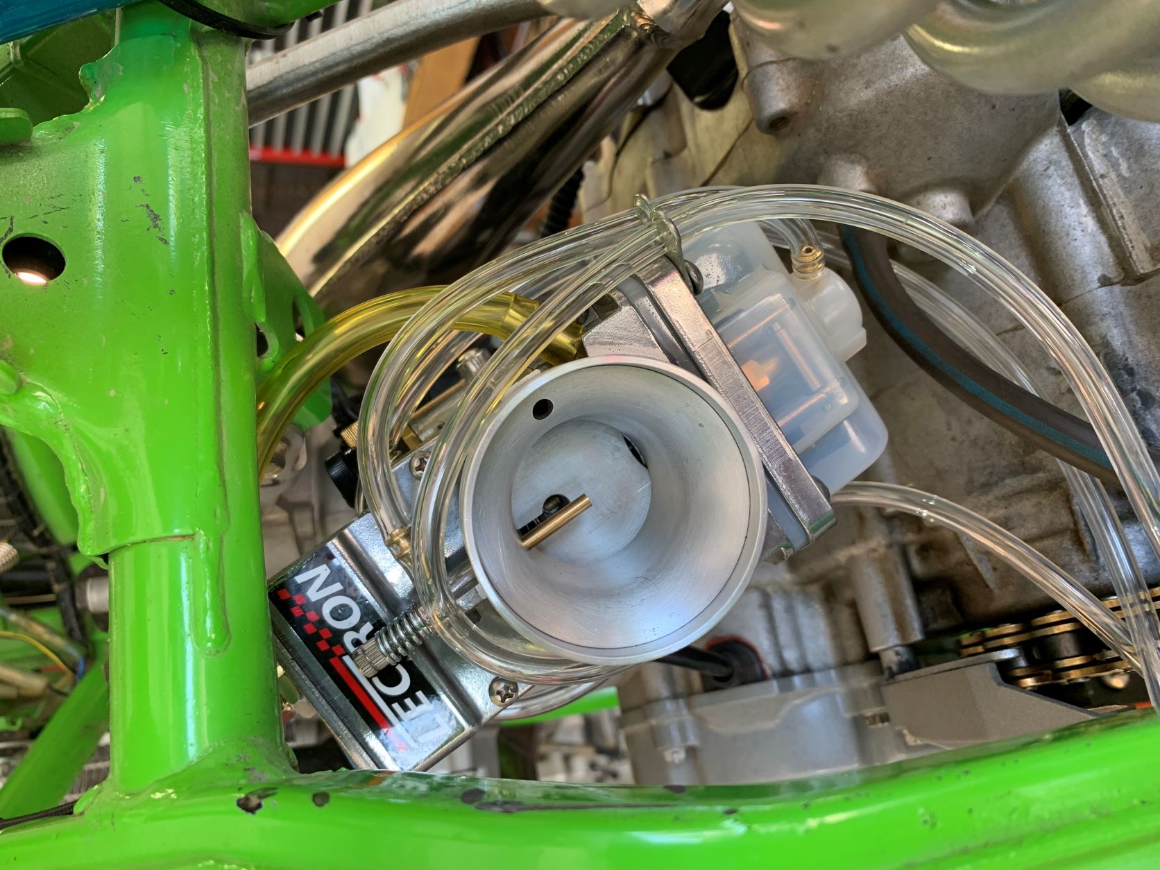

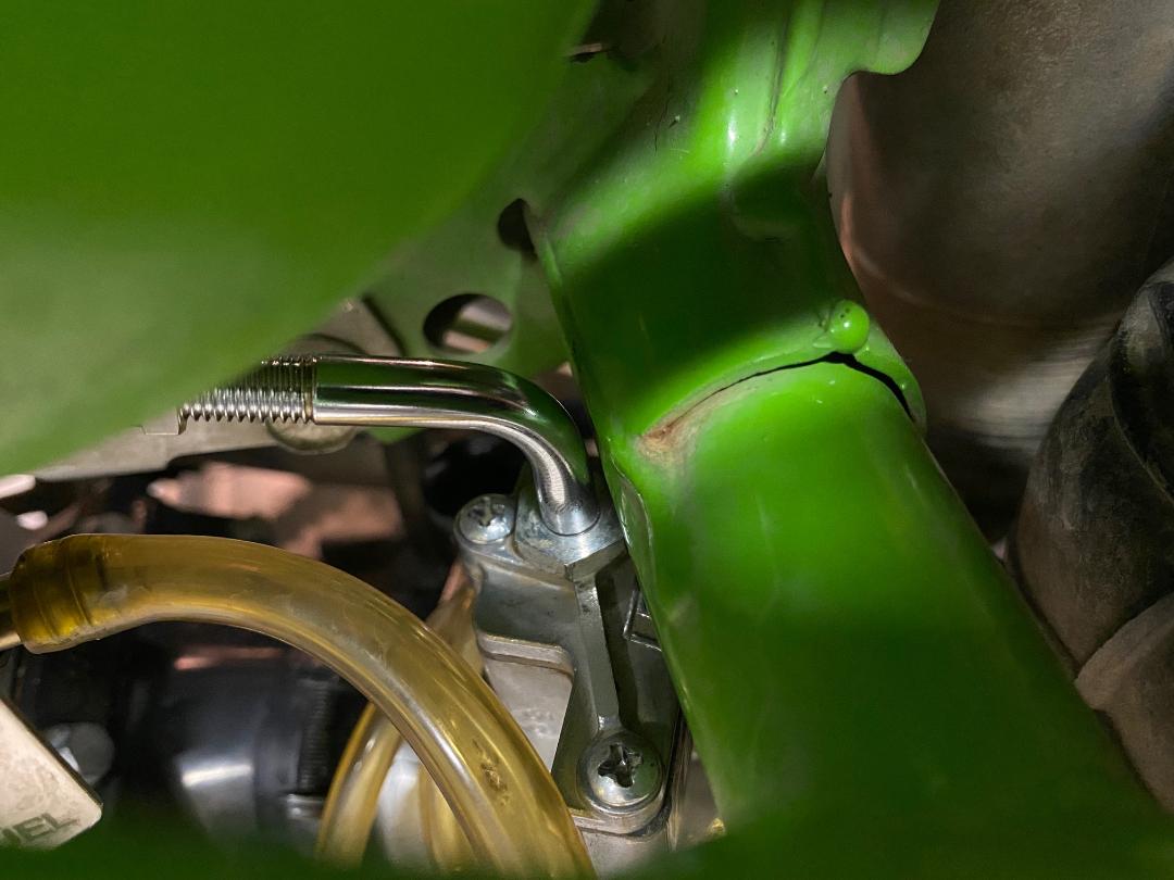

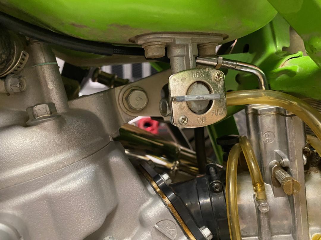

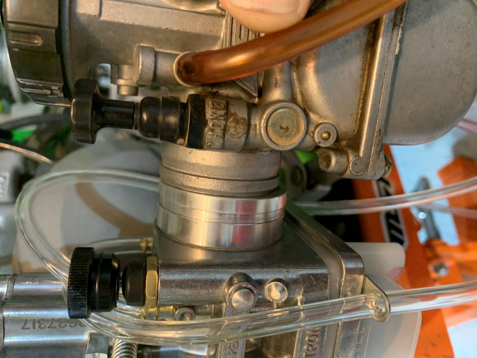

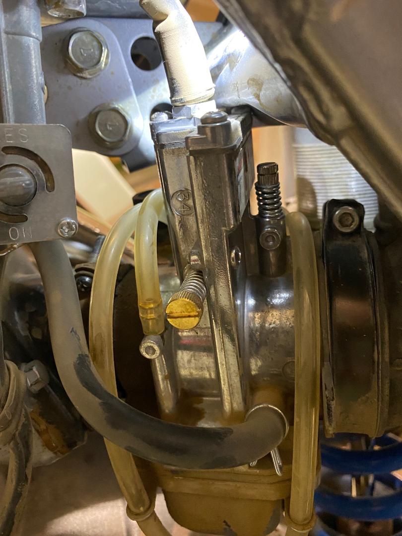

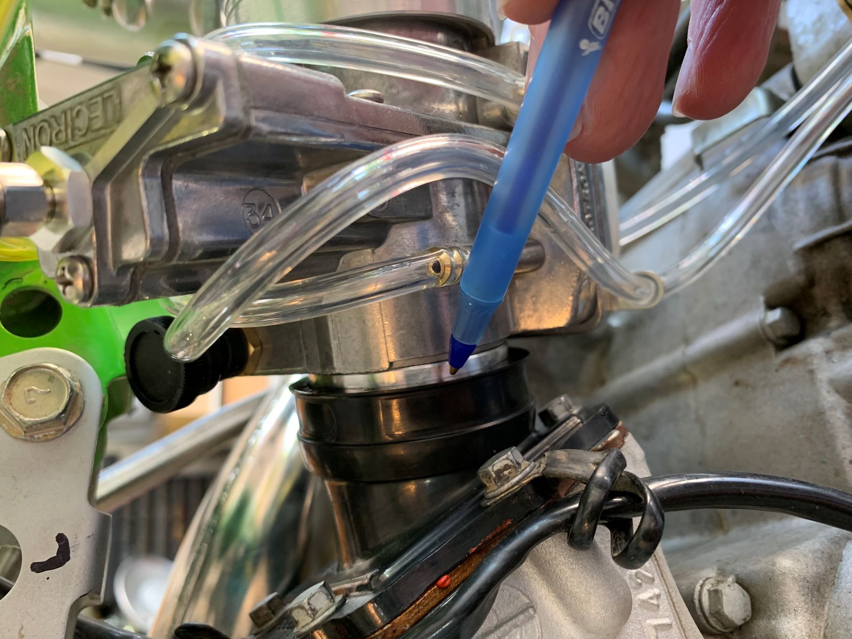

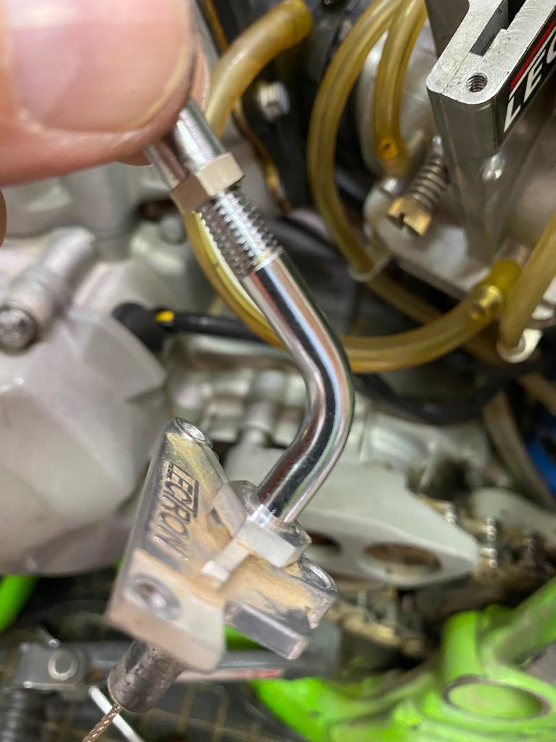

Wow! I'm surprised at all of the issues you experienced! I've been running a Lectron on my 220 for several years now, and it's worked great from day one. The only concern I had was with the Barnett throttle cable, and had to max it way out to take up the slack. I picked up another Lectron for my 200 a few months ago, and that one installed fine as well without any issues.
Since a member on here (Tyl3r, I think) worked with Barnett in the past to get a custom cable built, I reached out to them to tell them how crappy the cable they provide with the Lectron is, and that pretty much everyone says it won't adjust enough to take all the slack out. I thought that we came up with the perfect solution with the elbow and a mid-adjuster, but I still have one issue. The problem is with the elbow that screws into the top of the carburetor. Once it bottoms out into the top plate, there's only one direction it can face. If it's not towards the front of the bike, as is the case with mine, the elbow isn't completely tight. The cable setup works awesome and gives enough clearance to go under the tank, but the elbow isn't all the way tight. Here's the drawing and a few pics of how it looks installed.

Is that elbow bouncing off the frame so much to remove paint??

Wow! That is puzzling GATOROC, that you were able to install both your Lectrons without a fight.
Which bike are the photos from?
Do your Lectrons have a machined aluminum sleeve pressed on over the front of the casting? The sleeve on mine was so much bigger than the stock Keihin that it would have taken a crowbar or sledge-hammer to force the carb in far enough if I hadn't machined it down.
Did your Lectrons fit into the rubber intake manifold as easily as the stock Keihin carb, or did you have to force them in?
Are your 200 and 220 pretty much identical as far as the way the Lectron fits the intake manifold and within the frame?
Your photos show the top of your carb sitting about 1/2" lower than mine, below the cross tube of the frame, while mine hits it. I can't imagine how I could get my carb any lower to clear that frame tube.
I'm wondering why my installation was such a nose bleed.
Thanks,
Jim

No, the paint missing was from during the initial install a few years ago. As you probably know, the Lectrons fit really tight on a KDX, so you have to wiggle it a bit to get to the point where it fits straight up and down under the indentation in the frame. The pics I provided was when I was installing the new cable. After getting the boots on properly, there's about 1/4 inch between the elbow and the frame.KDXGarage wrote: 03:16 am Nov 20 2021 Is that elbow bouncing off the frame so much to remove paint??

jimboe wrote: 03:18 am Nov 20 2021 Wow! That is puzzling GATOROC, that you were able to install both your Lectrons without a fight.
Which bike are the photos from? The photos are from my 220, and when they made these for the KDX a few years ago, they used 36mm carbs. Now they use 34mm.
Do your Lectrons have a machined aluminum sleeve pressed on over the front of the casting? The sleeve on mine was so much bigger than the stock Keihin that it would have taken a crowbar or sledge-hammer to force the carb in far enough if I hadn't machined it down. I didn't recall a machined aluminum sleeve pressed on over the front of the casting.
Did your Lectrons fit into the rubber intake manifold as easily as the stock Keihin carb, or did you have to force them in? They fit into the rubber intake manifolds just like the stock carburetors, and that was on both bikes. Absolutely no issues at all.
Your photos show the top of your carb sitting about 1/2" lower than mine, below the cross tube of the frame, while mine hits it. I can't imagine how I could get my carb any lower to clear that frame tube. They do fit a little differently. My 220 seems to have a little more clearance than the 200. Even though I can get the 200 Lectron under the frame, it's really tight, and not all the way straight up and down. I didn't spend much time on the fitting since I was getting ready for a ride, and it was running great. I've provided a pic of my 200 Lectron below.
I'm wondering why my installation was such a nose bleed. If I ended up having the issues that you are having, I probably would have just sent it back. I commend you for working on a solution! It's really strange that you're having so many problems with it, as most of the problems I heard of were during the early releases where the top of the carb wasn't milled down, so it wouldn't fit under the frame. Also, like I mentioned, there were (and still are) issues with the throttle cable they provide. I thought I received the perfect solution, but it's not perfect. My throttle response/snappiness is incredible now with the 220. I'm going to follow up with Barnett again to see if they can come up with a solution for the elbow piece, and then order one for my 200 as well. Todd
Thanks,
Jim

GATOROC, thanks for the feedback on your installations.
I am somewhat irritated that Lectron sent me a carb with a sleeve that was too big to fit in the rubber intake manifold without modification, especially after reading that your carbs both fit into your manifolds (the same part number as mine) just like the stock carb.
I seriously considered returning the Lectron before making any changes, but then I would have had to figure out what was wrong with my Keihin and fix that, then fuss with the jetting for the 6,000 foot differences in elevation where I ride. My desire to get the Lectron to fit to enjoy its benefits overcame the common sense to send it back. I believed that if I modified the carb at all they would NOT take it back so it was an all-or-nothing risk. Thankfully, it worked out. It would have been painful to try to explain to my wife that I paid $600 for a carburetor that I couldn't get to fit and could not send it back for a refund because I modified it.
I just looked on the Lectron website today and searched for the carb for the KDX 200 & 220. It showed the following statement: "We can't find products matching the selection." Hopefully, they are doing some more research to correct the problems I told them about, or will switch gears and figure out how to fit one of the new "Billetron" carbs to the KDXs.

just saw this post,great write up,ive just purchased a new, older lectron and i'm having the same fitment issues, my carb already has a small diameter intake flange but won't go all the way into the carb boot, could it be that we are both using older lectrons and not the H series which has a shorter body, i emailed lectron but as per there policy they refuse to answer any questions about second hand carbs, they simply said my carb won't fit, terrible customer service, as i am a welder by trade and not a machinist my plan is to cut and weld the frame, there is already a factory indent there but i may cut and weld in a larger indent
- 80786.jpg (138.8 KiB) Viewed 19215 times
- 80784.jpg (225.71 KiB) Viewed 19215 times
- 80785.jpg (272.35 KiB) Viewed 19215 times
