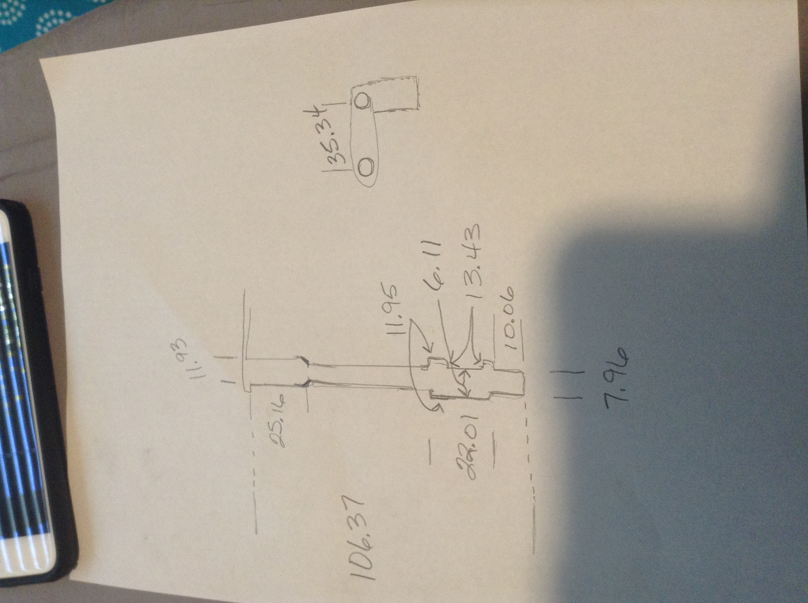

Eric I found one on eBay for a 93. I bought it but have no idea when I'll get around to trying it. I' don't know if you have dimensions of what would work but I'll measure it if it helps at all. Maybe someone has an H series one out of their bike that they can reference.

Listed for a 93 KX 125
- image.jpeg (1.45 MiB) Viewed 54105 times

Re: Clutch release arm extention
I forgot the length of the skinny middle part of the shaft. That would be 106.37 - 25.16 - 22.01 - 10.06 = 49.14
I wish I had more time to install but with everything going on I'm trying to work as much as I can.
Just curious if you ever tried the '93 KX125 clutch actuator. I would love to have a definitive working part number for members, including myself, to go on.John_S wrote: 11:03 am Mar 28 2020 I forgot the length of the skinny middle part of the shaft. That would be 106.37 - 25.16 - 22.01 - 10.06 = 49.14
