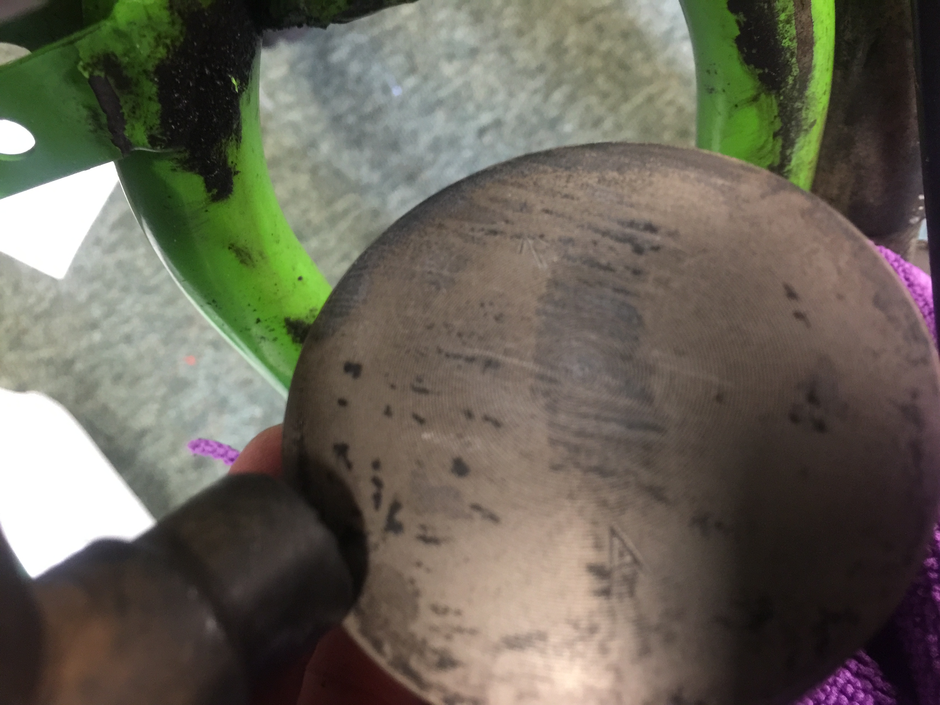

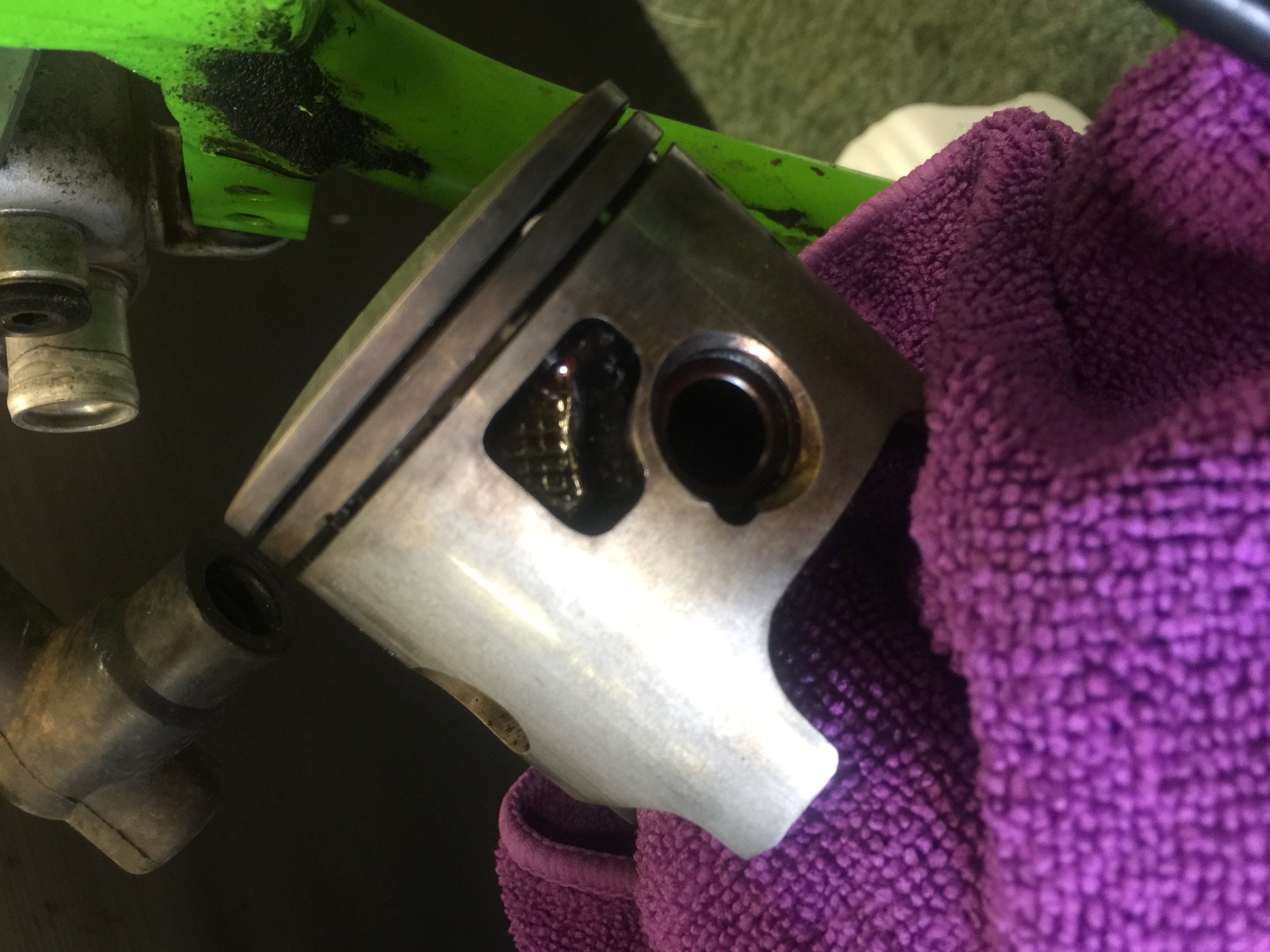

Took a picture of mine it’s got the letter A on top

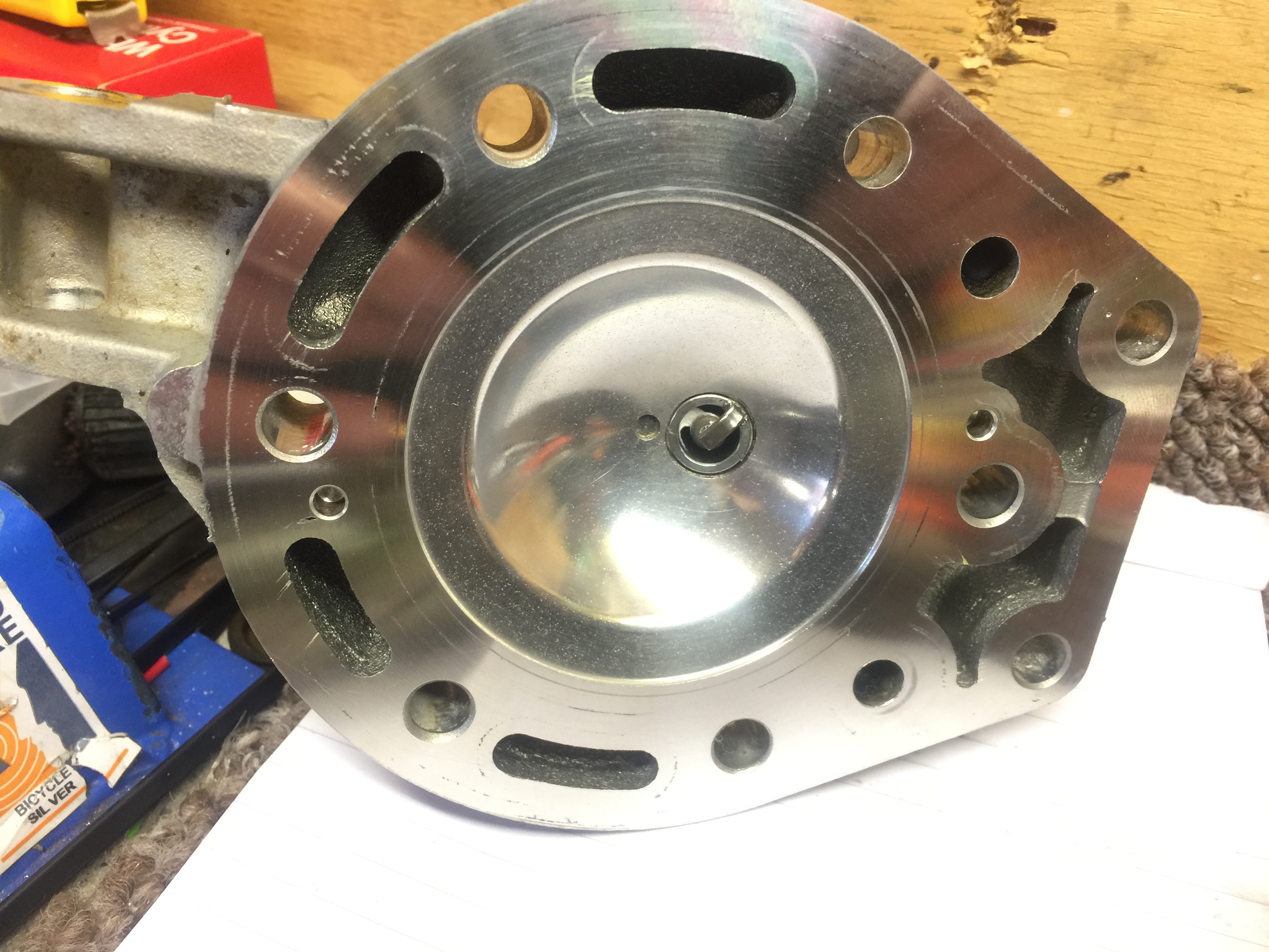

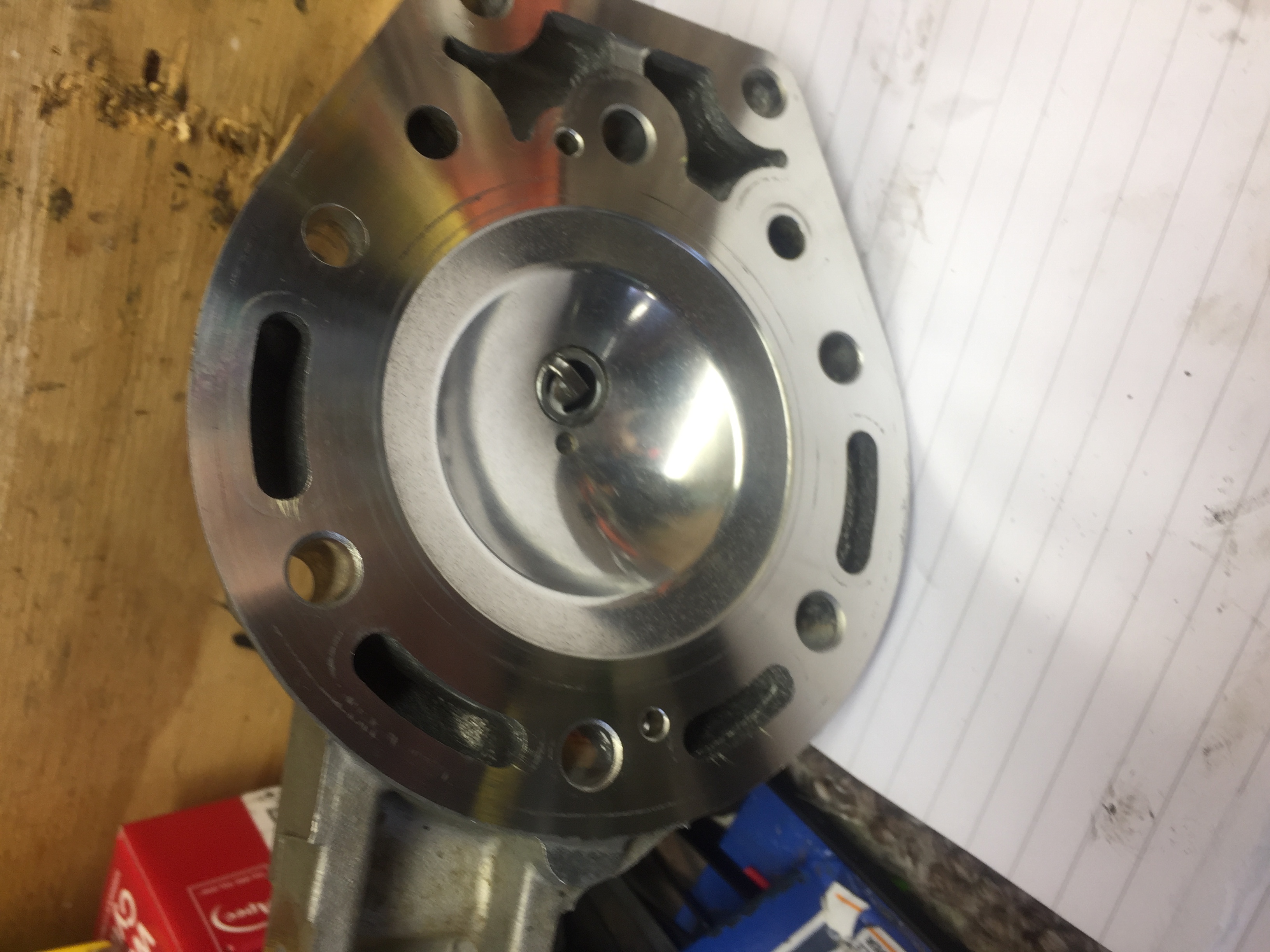

The bore is perfect no lip and head is clean
