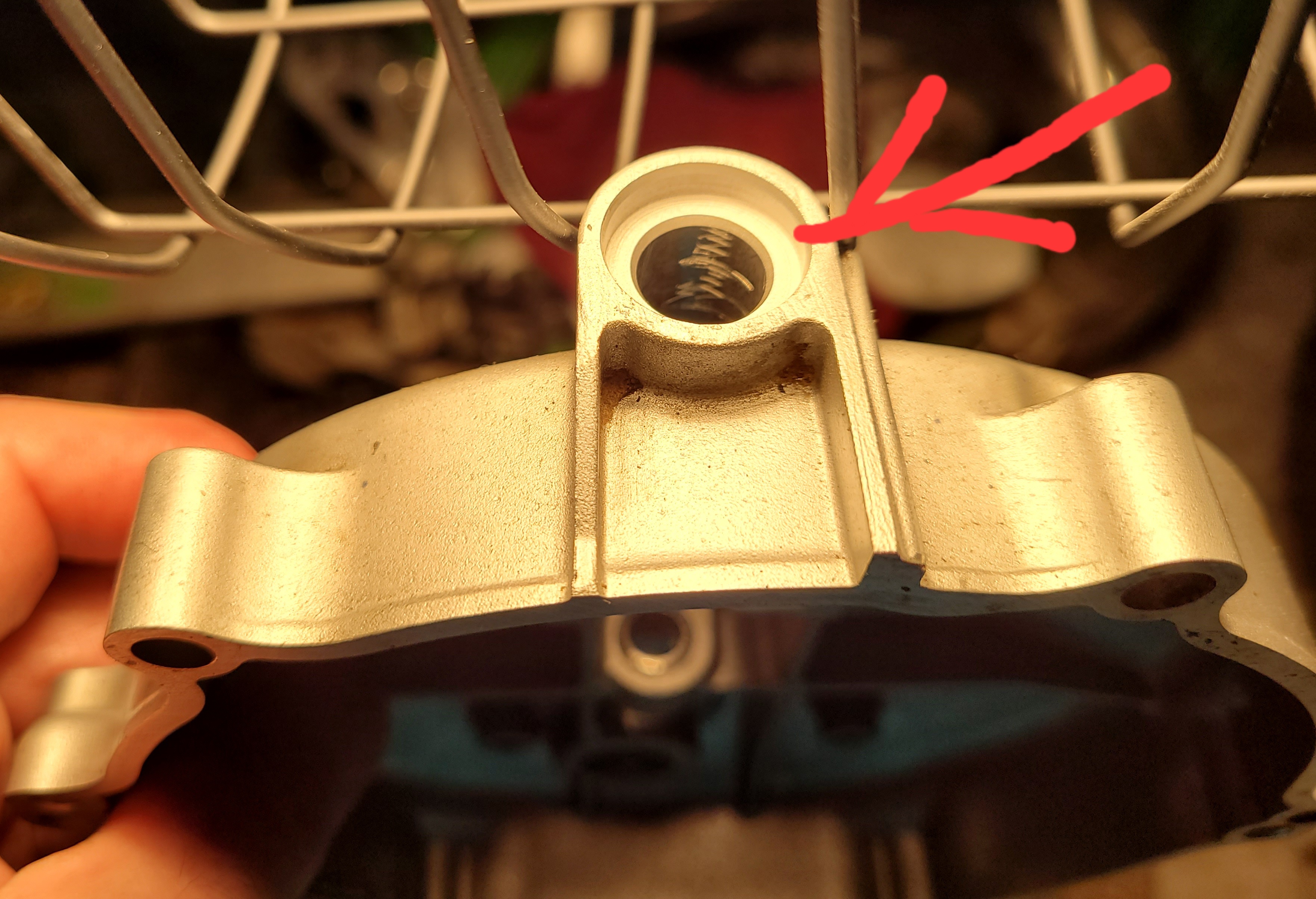

Here is a KDX 200 / 220 clutch side engine cover (photo) The clutch activation arm is placed in this hole, along with oil seal (in larger diameter seat). The lower end of the arm shaft sits & rotates in a needle bearing installed in this cover. The needle bearing is immersed in transmission oil. However, vertical depressions can form on the shaft end that sits in this bearing (e.g., needle bearing depressions). I'm not sure if this deformation is caused by heavy use, spent lubrication oil or combination. However, I see them more frequently with smaller engines.
Our forum has posts about the (wear) grooves that form in the upper end of the shaft arm. This photo shows wear grooves & scratches also form in the cast journal bearing area the clutch arm is placed within (arrow). I've looked at several clutch side engine covers from KDX 200 / 220 and KX 125 and saw grooves in them in this area. It's beneficial to clean up this journal bearing area by smoothing these grooves. The cover is soft and care is required to not enlarge and/or cause out-of-roundness. I use 220, 600, & 1500 wet-dry sandpaper in succession. But, only lightly! I don't try to achieve absolute perfection.
From examining a few of these engine covers, it appears manufacturing includes a series of short, diagonal, parallel grooves (ellipses) made to hold transmission oil for improved lubrication for the clutch arm shaft and journal bearing. They are visible in photo. I'm guessing the downward diagonal orientation of these specific grooves returns excess oil to the transmission and minimizes oil escaping past the rubber oil seal that sits above this area. If more experience KDX / KX riders and wrench turners know differently, please comment.
