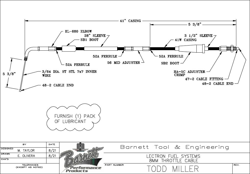

The cable elbow that Lectron supplies still isn't really what's best. That custom order Barnett cable based on the drawing with the part number "Todd Miller" is really what Lectron should be selling for a multitude of bikes, not just 95 and up KDX. My stock universal Lectron cable broke right where it makes the sharp bend between the carb and the gas tank. It's also a high quality Barnett cable, but the only flaw is that it didn't have a 90° or 70° elbow with a Teflon liner sleeve in it.

Ultimately, the custom order Barnett cable will be the absolute best thing as it has a Teflon sleeve lined 70° elbow built into the cable, and their cables are top quality. I snapped the standard Lectron cable with 8 mm thread for KX etc throttles, and it snapped right above the carburetor where it makes the 90° bend below the gas tank to run horizontal up front. I think the custom Barnett cable will last significantly longer and pull smoother. The standard Lectron cable lasted me three seasons of heavy use. Not enough by my standards.
I should note that I believe Barnett makes the Lectron standard universal cables as well, and they should offer one with the 70° or 90° elbows built into them, as this would make them last longer, but this is what electron provides. That's why I went with the custom order $64 Barnett cable. I'm not a broke 20-something kid anymore, and I love my KDX220's tremendously, so I'm not afraid to pour money into it. It's still cheaper than buying a new bike to abuse and destroy in a few seasons and rebuild & repeat.
