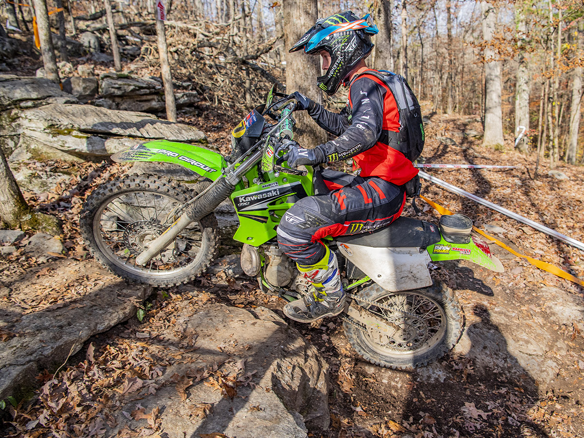

The other day I sent him a question: what is your sprocket selection on the KDX?
To my surprise he answered: 13/50... well, I'm not surprised at the ratio, just surprised that he answered!!!
In order to feel competitive, I like to even the playing field as much as I can. This does wonders for your self-confidence and that counts for a lot towards becoming a better rider/racer. I noticed also he is riding on conventional forks which especially appeals to me since that is how I intend to continue racing mine. I've sent him a followup question about these old school forks to see what he's done there. You can see they are adorned with a yellow Race Tech sticker so we might assume he's running their proprietary Gold Valves. I'm very curious about which springs too. If I hear something back I'll let you guys know!
UPDATE: He did NOT revalve - left it OEM, but went up a couple on his springs front and rear. So like we always say, it's about the rider!!

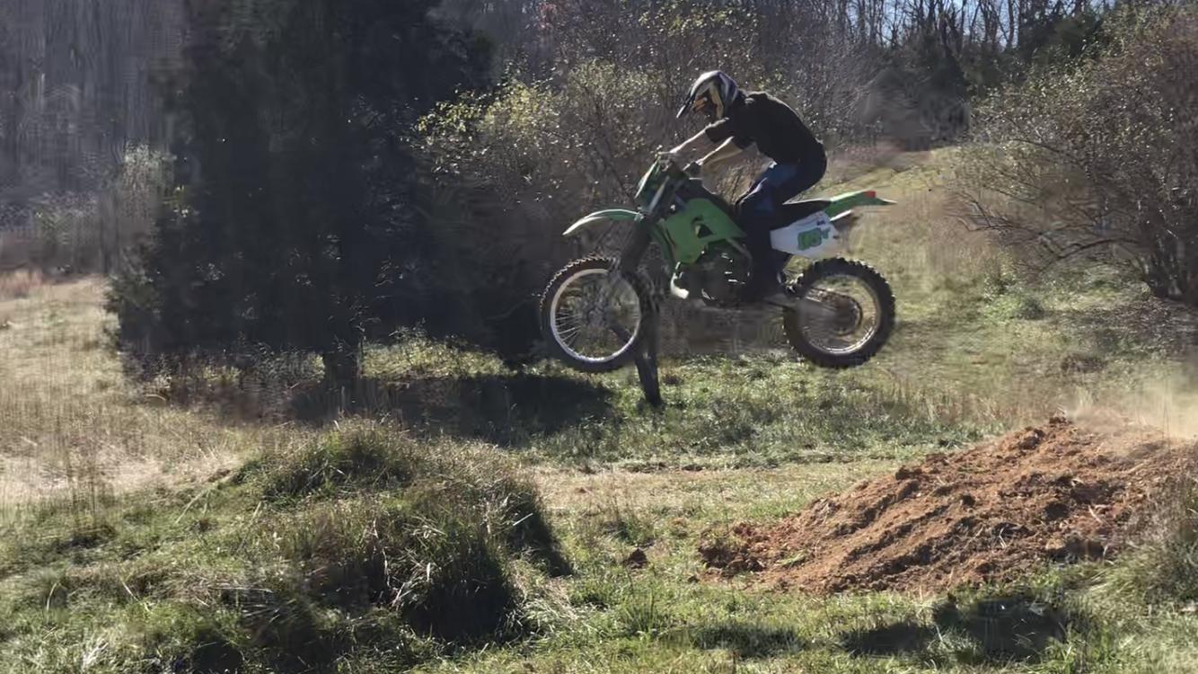

Re: dialing in my KDX Hare Scramble Setup
So I watched Travis (Go Race Suspension) ride my KDX today as he evaluated everything - man!!! WHO knew my KDX could jump doubles like nothing?!? I might throw up the video later...
We feel good about the springs overall / going to install his custom Belgian Valve mod - it’s like the Racetech Gold Valve but special for the KDX conventional forks and then maybe go up a size on the springs later as I get faster.
Installing Fredette’s taller/firmer seat soon too.
