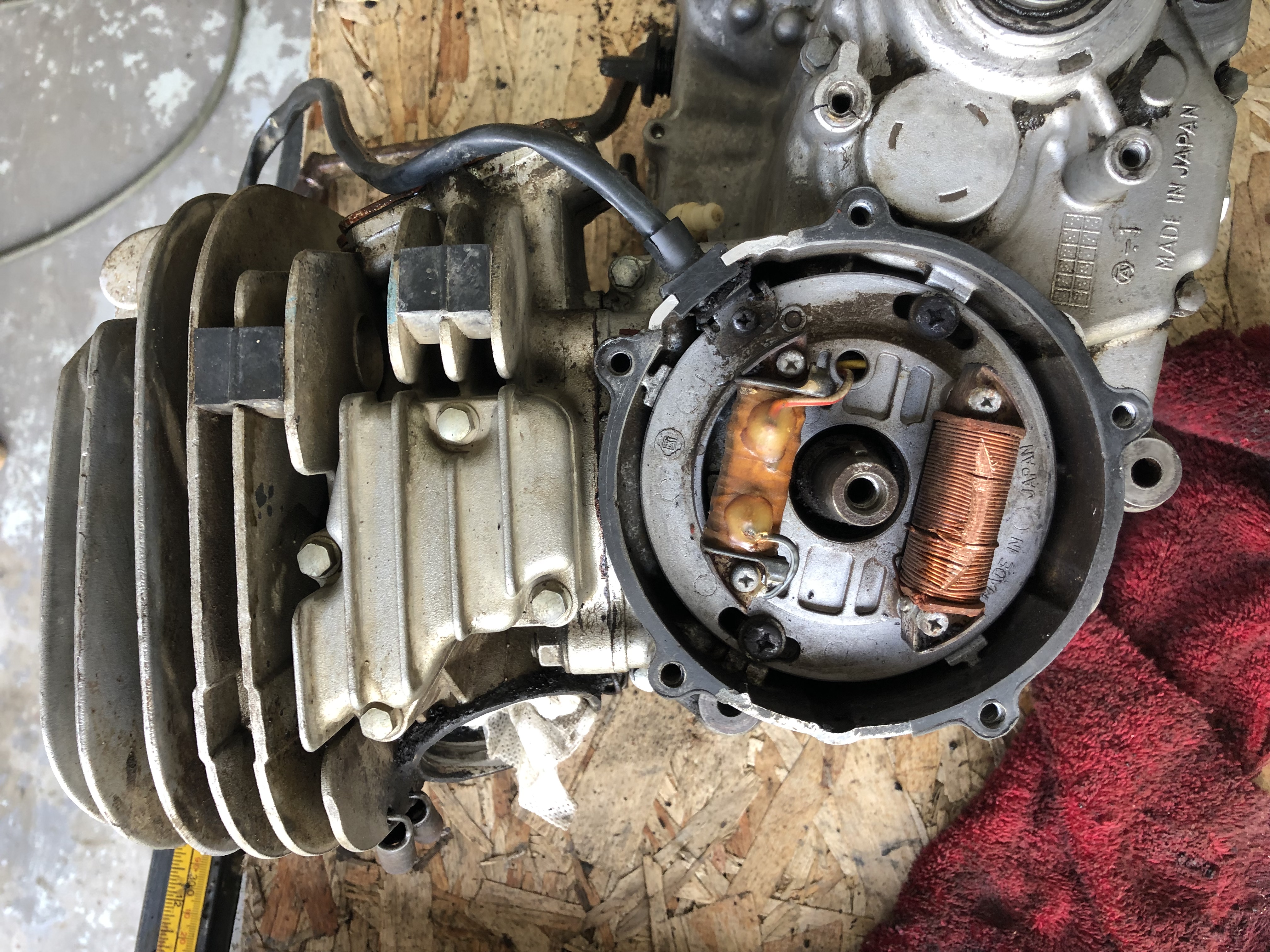

So I'm working on a 1988 KDX200 belonging to a friend. It had lots wrong with it but the main issue was no spark, so took the flywheel off and found a mess. The magnets had all come loose on the flywheel and the coils had been damaged by someone in the past using long bolts in a puller . So I ordered a flywheel off a newer H (or E model)(figured I just do the stator mod) and some coils from RM Stator. The new coils are wrong, they aren't the same as the old ones so won't work. My question is can I use the stator from the H model instead? Those are relatively cheap to buy. The coils look the same but the plate is different, 3 mounting holes instead of 2 but maybe I could modify it?
Thanks for any help on this.

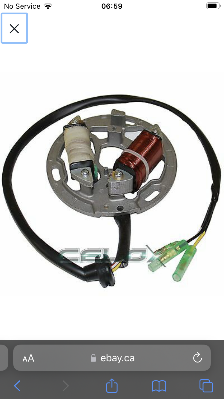

Thanks, yes I’ve seen the posts about using the newer rotor and moving the holes in the old stator plate. But there seems to be nothing about using a new type stator like this one…

Yes I hear what your saying, it's a very old bike and I imagine most have been scrapped by now.
I was assuming the aftermarket stator in the picture is the same as the stock stator for the E and H models. I figured somebody must have tried mixing the rotors and stators up but maybe not. I noticed that the parts fiche shows the 86-88 stator with 2 thin source coils stacked but mine only has 1 thick source coil so not sure if it's original. I might just try to rewind the damaged coil myself.

Is the copper wound coil not for the lights, and the other one is for the ignition?
Is the ignition coil bad, too? I can see where the copper coil is damaged.

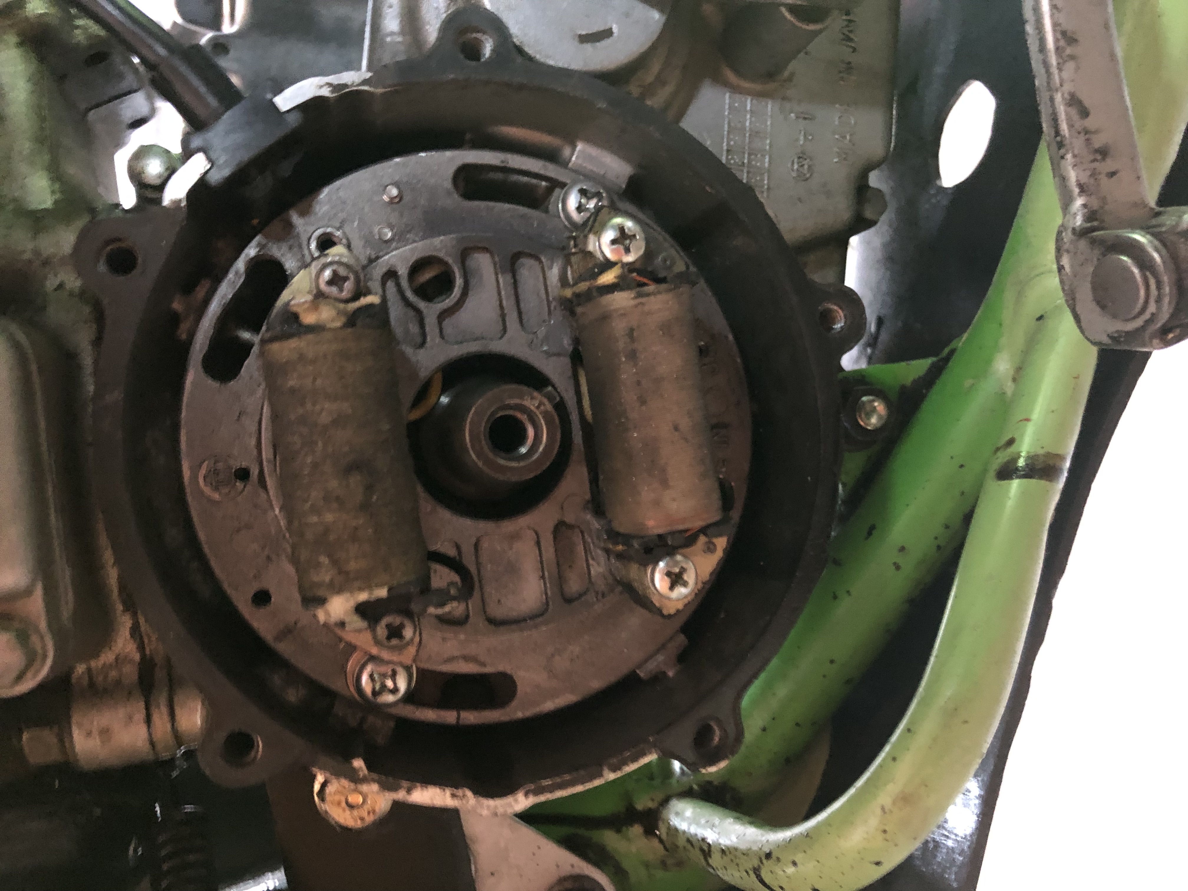

Local guy had a bunch of Lifan stators for $10 each. The coils were roughly the same size as the kdx ones, just had to elongate the mounting holes and they fit.
However I still get no spark. How do I know if the CDI unit is working?

So I tried the later model CDI unit, they said it wouldn't work.... but it does. Just had to change a couple of the connectors. I got spark. Figuring out the timing was a pain, the new slots at 90 degrees were completely wrong, tried different positions and got nothing. I rigged up a timing light and put a mark at TDC and the new position was about 20 degrees counterclockwise. Just had to elongate the existing slots. The new lighting coil from the lifan puts out too much power and blows the lights so would have to put a regulator in, but I'm not too concerned about having lights.
