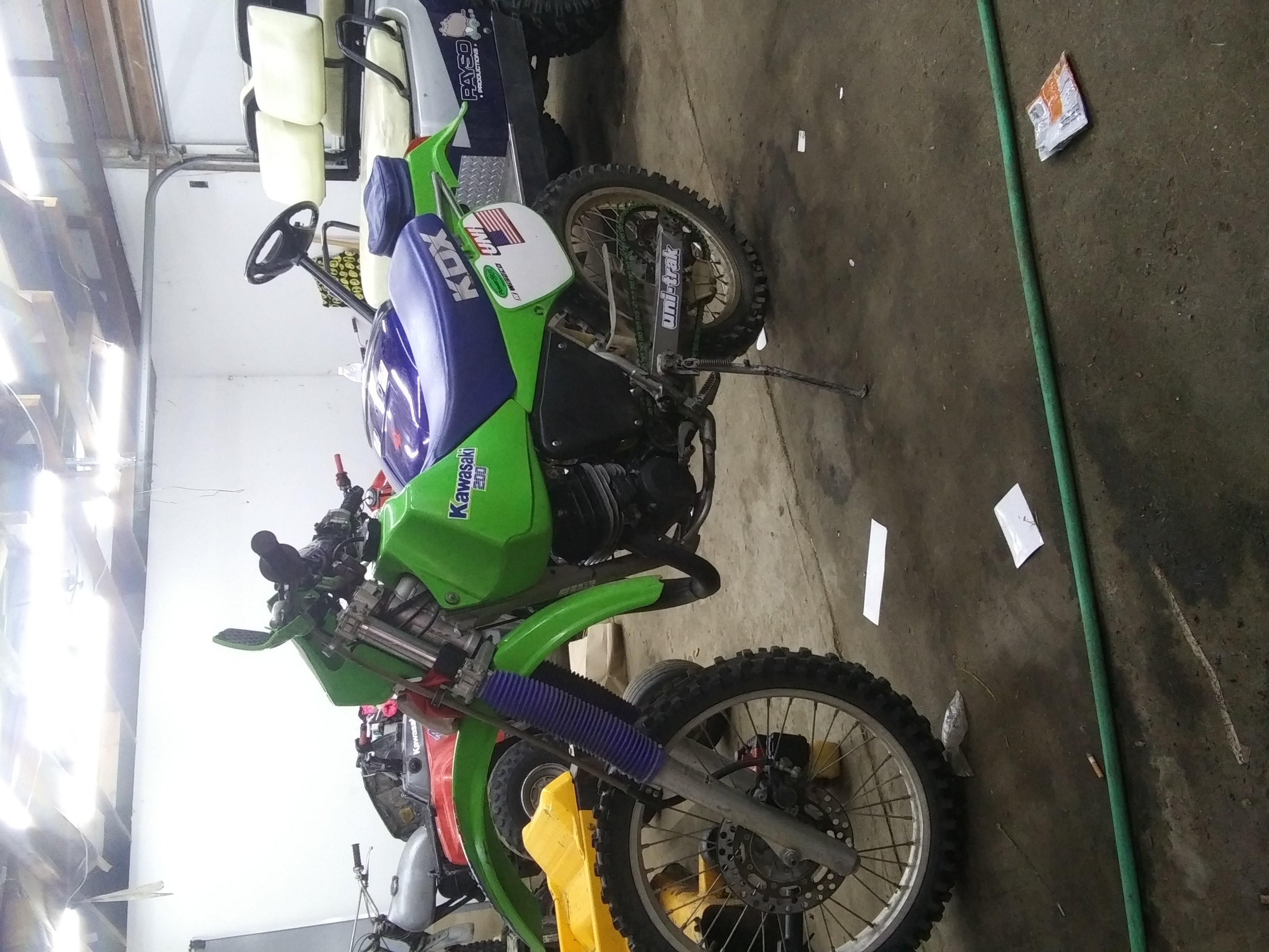

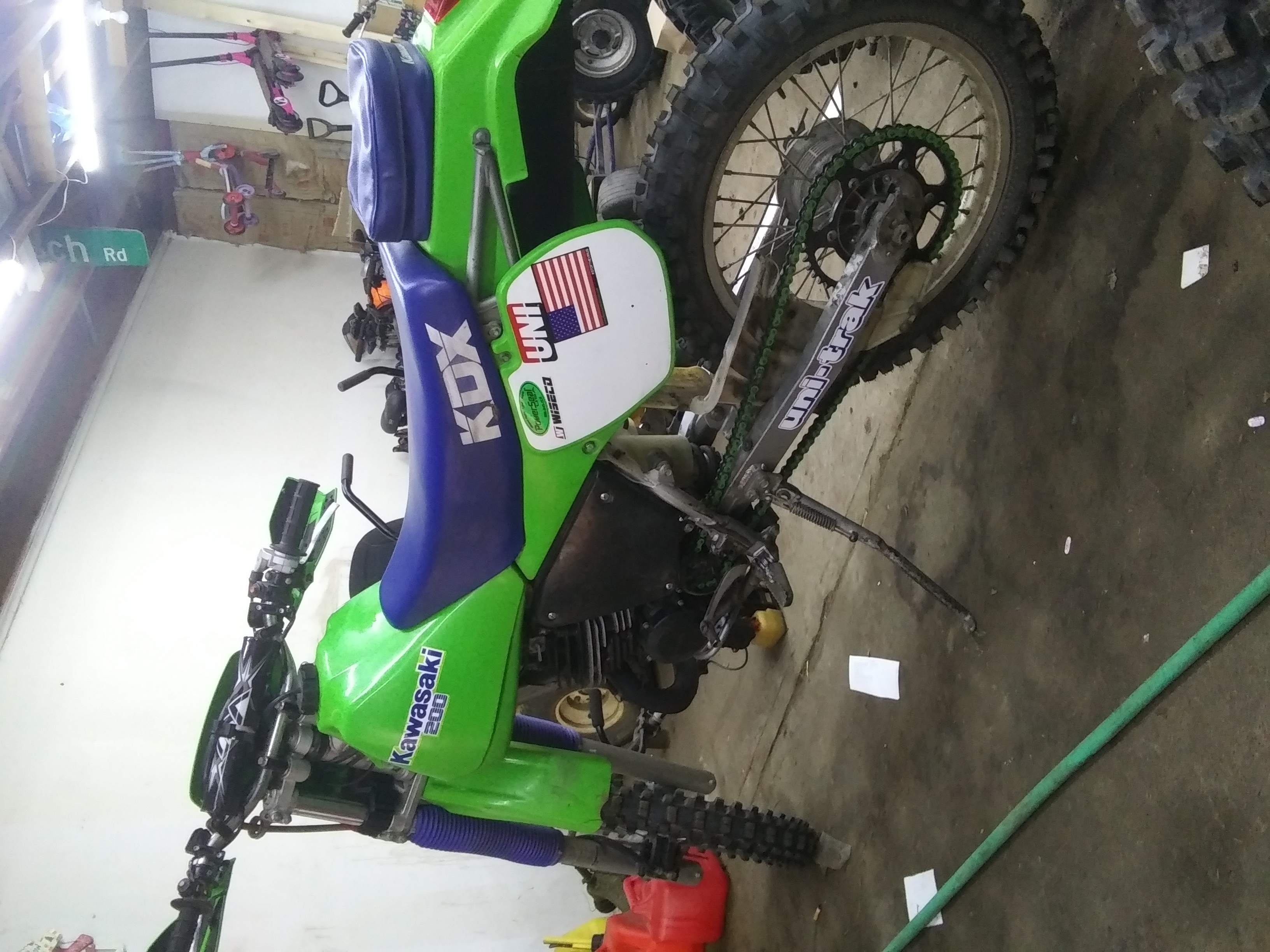

And heres a couple pics of my bike
- 20200527_101114.jpg (2.87 MiB) Viewed 21397 times
- 20200527_101130.jpg (2.76 MiB) Viewed 21397 times
- Posts: 14748
- Has thanked: 193 times
Re: 1987 kdx 200 tuning issues
LOOSEN THE CHAIN!!
The chain is way too tight. You are going to damage the output shaft, bearing, crankcase, etc.
I am glad the bike is running well after the carb changes.
One0ffthewrist
- Posts: 10
- Joined: 08:50 pm May 20 2020
I did right after I took those pics I was putting new sliders on had it tight to try and slide them under which didn't work it's set right good now
- Posts: 14748
I am quite sensitive to tight chains of late.
The bike really looks great! I got a new one from the dealer many years ago.
It does look good!
What is going on with the shifter?
Sorry was up north riding over the weekend bike ran good as far as the gas tank idk think it's original the bike seemed to be well cared for as for the shifter yeah I moved it up for my boots it was kinda a pain to toe shift on the trails
The tank does look original. Not many still look that good.
Yeah I wish I knew the history of the bike but I don't other then what the PO told but going off of the condition of the plastics and the typical wear points I think the bike wasnt rode much when I bought it pretty sure it still had the original tires as it had a matching set of dunlops on it the rear was pretty worn in the middle but again these are all just guesses
