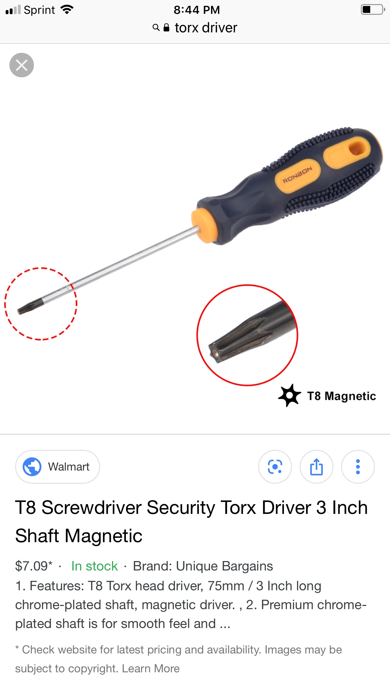

This is a generic google picture (wrong size) but I bought a driver like this on eBay for $6. It works great.

Thanks for the replies. Found one on ebay for $6. You guys are the best!
