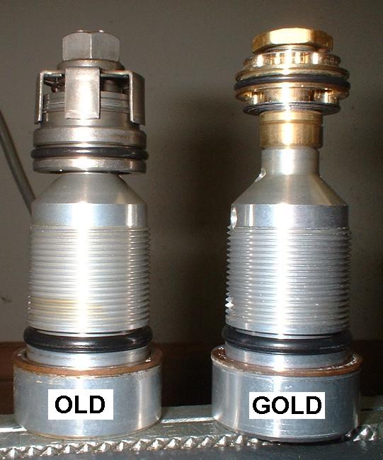

I bought a really nice 02 220 and decided to update my suspension for saftey's sake as around here there is alot of tree roots here and in the 35 years of riding here I have seen some really bad accidents all because of improperly set up suspension. 1st ride was ok but as an old hare scrambler and enduro rider we still like to sprint around for at least a little bit and I did not feel like I could trust the front end totally. After tearing down the forks I saw that the stock piston isnt capable of flowing enough oil on big hits no matter how much you mess with the valving you can never out shim the problems caused by an incorrect piston. Im posting some pictures to show the superior oil flow capacity of the gold valves. If your tired of getting spit off of the trail with out notice I highly recommend these and proper spring rates, for higher speeds they are a must. Im going with Jeff Fredette's recommendation to go to 7.5 weight oil to get a little more rebound out of them 5 is too light 10 is too heavy.Race tech recommends going to 145 mm oil height. These mods are for woods riding motocross will be different. I hope this helps you ride safer

They do offer better tuning.

Some people drill more holes into the piston, then chamfer them with a dremel.
