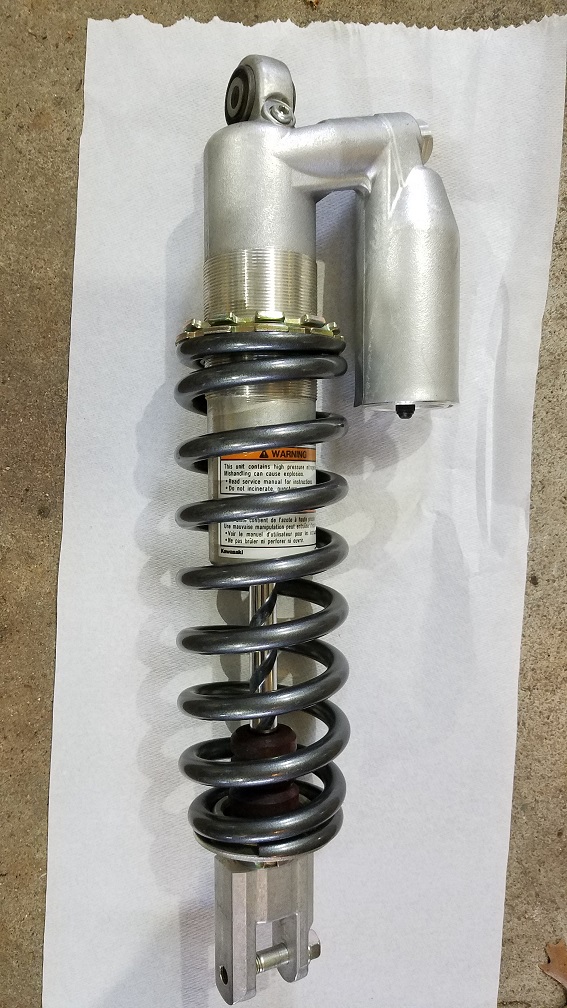

Can you post a pic?
Is it a KDX shock? If someone handed me a new in the box KDX shock, I would go straight to my nitrogen tank. Shocks lose pressure over time.
Given your situation, assuming it is new, nitrogen (or air if you must), then slap 'er in there. As soon as you get the forks situated, with fresh fork oil, then at least dump and fill the shock with fresh oil.

Well, it came in, and it is beautiful. I wish I new how much nitrogen was in it. I just want to install and go, and it is not like I can just run down to the shop and have it checked. :(
I guess I am just going to install it anyway and have the nitrogen done later when everything opens back up.
Unbelievable that there is a new shock like this out there running around.
BTW: Does anyone know the spring rate of this color spring? Was it just a color change for later years?
Thanks
Jeff

Re: KDX Shock
Posted: 06:31 pm Apr 10 2020

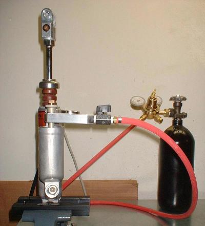

A shock should not be checked for pressure. A huge volume escapes when that is done. It is 142 stock. The volume is tiny compared to a car tire or motorcycle tire.
A lossless chuck is usually used. That also usually means one can not just connect the chuck while it is still on the bike. With the way the pipe and frame are, it might be a tight squeeze.
Running it with low pressure can damage the seal.
The shock spring color was different on the last 1, 2 or 3?? years.
The bumper is showing its age, but the shock looks great, though!

Here's a picture of my setup, so you can see the height of the chuck. (Race Tech)
