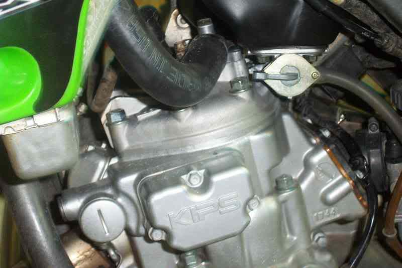

hybrid 220
not sure about the other hybrid owners but the fuel range dropped considerably, Maybe 30 miles on a tank, Got clark working on some photos and deminsions for me, my motor is stock except for the shotry pro circuit silencer and the platinum 2 pipe, and an 94 kdx 200 25mm carb, I run stock gearng so I can only figure the chassis allows me to push the engine harder, Its fast by any standards in the 200 class,Got to get this big tank designed in

http://img.photobucket.com/albums/v635/ ... ble002.jpg tight and alot of work with a heat gun but it will work
